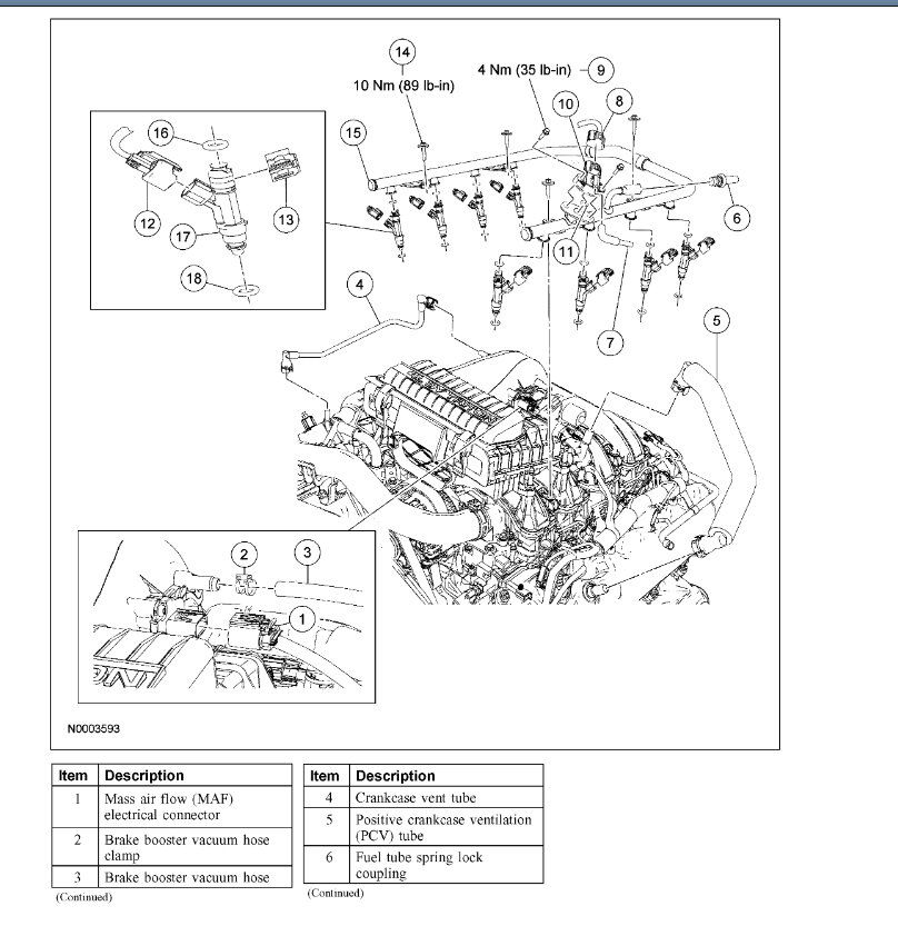

I have a fuel rail that has rubber section in back by firewall it has a pin hole, can it be repaired without replacing?
Oct 13, 2022 at 9:35 PM
  • 55,732 POSTS

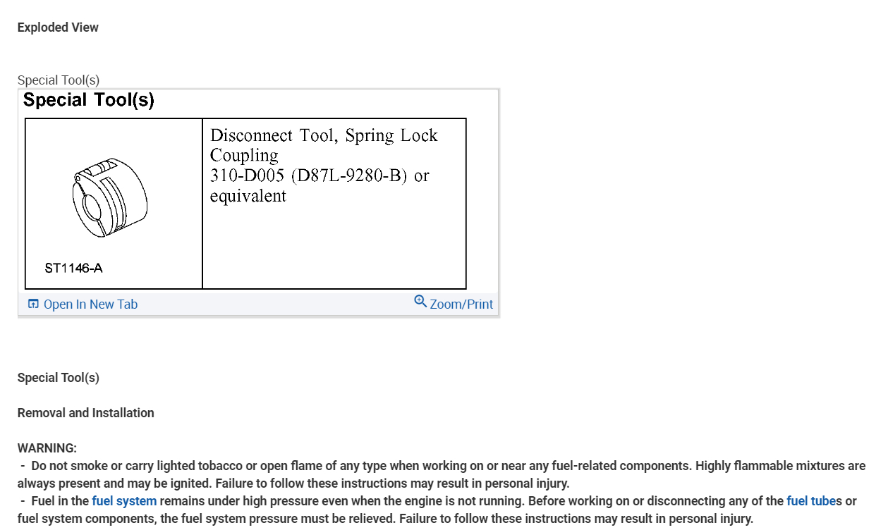

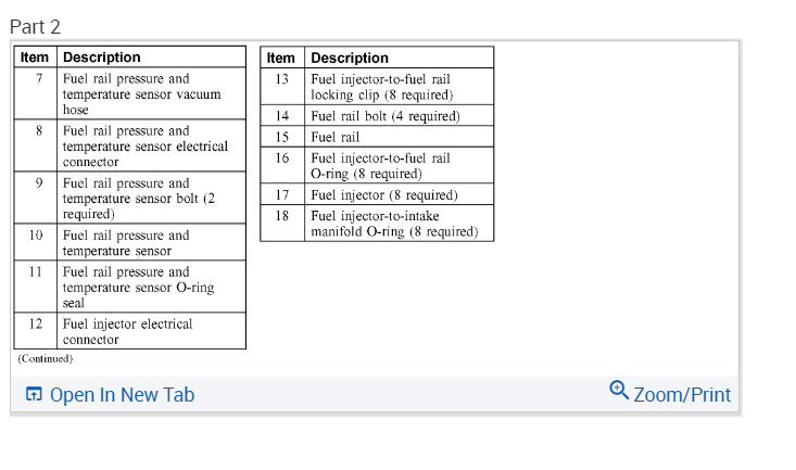

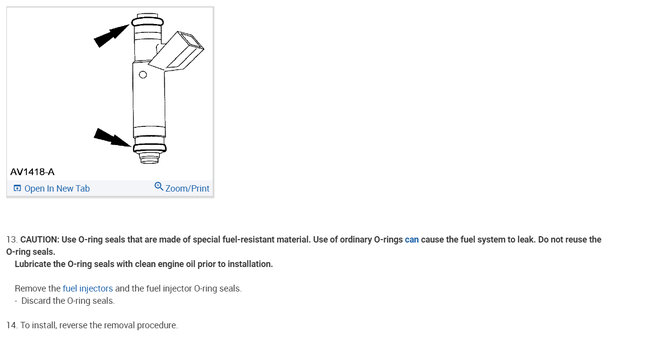

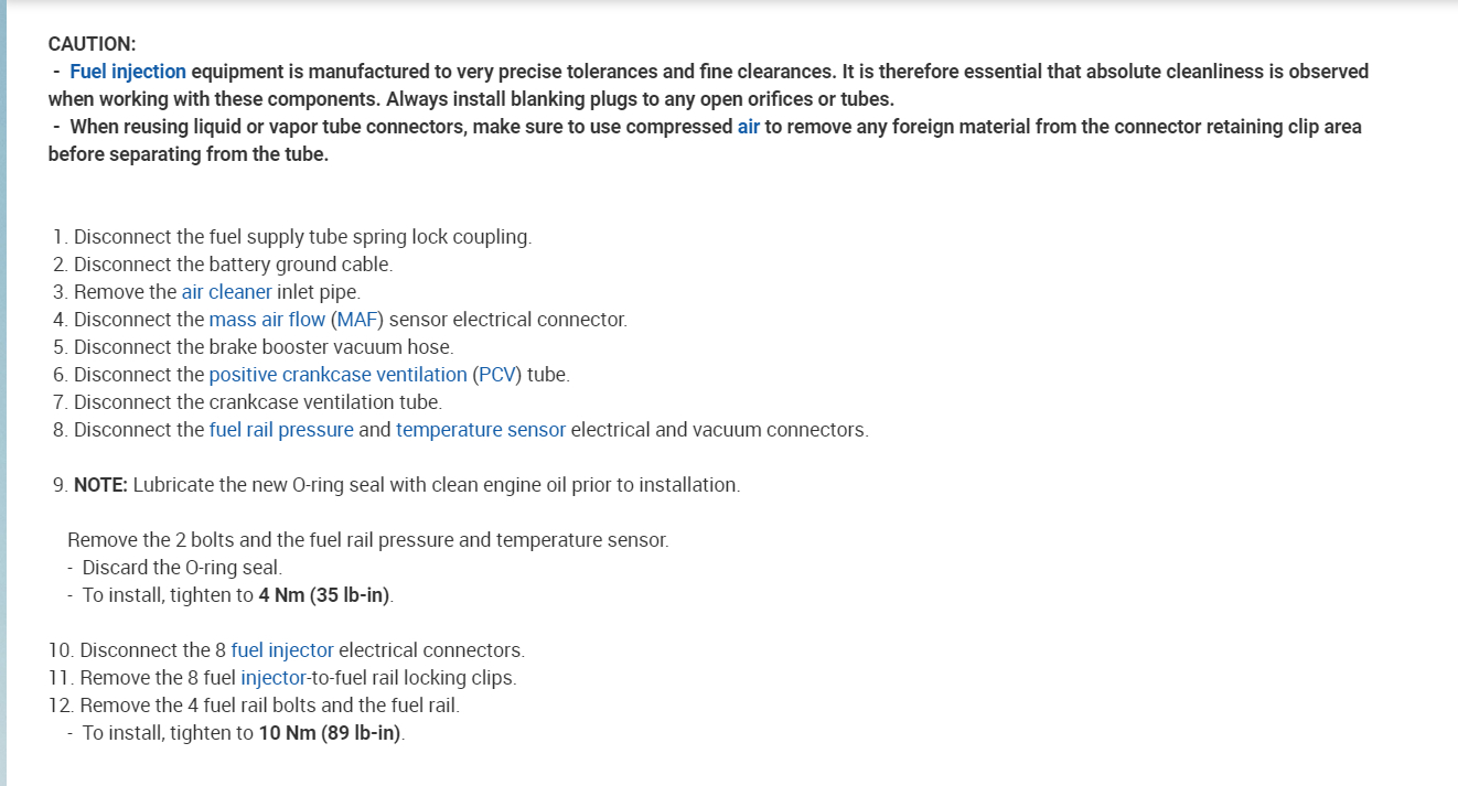

I have seen people try to cut out the hose and replace it with some success but since it deals with fuel i would replace it with a new unit. here are the instructions on how to do the job in the images below.
