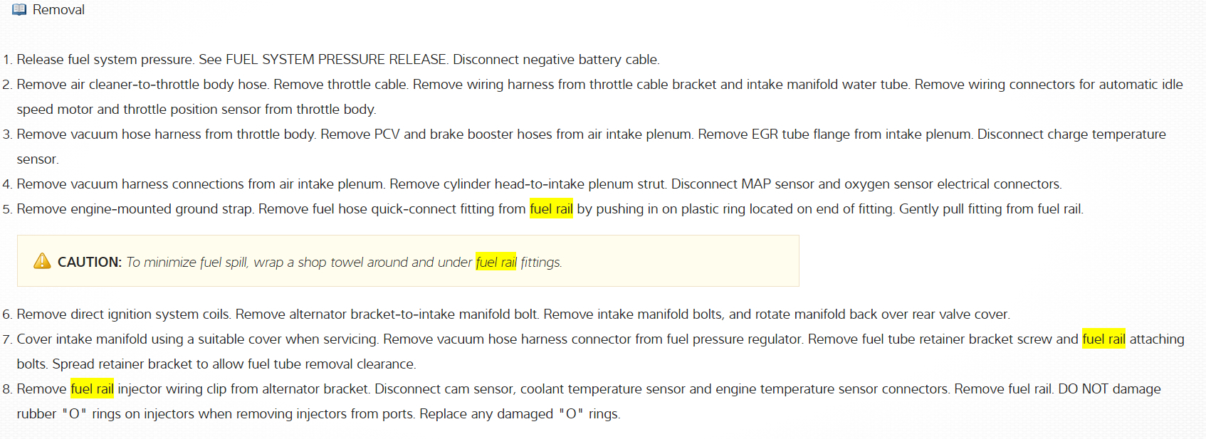

i've developed a fuel rail leak. where it goes from the smaller part and gets bigger. they seem to be pressed into each other. is there a remedy for this. any kind of sealer ? to get it through the rest of the winter. and then play with it more. thanks

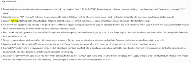

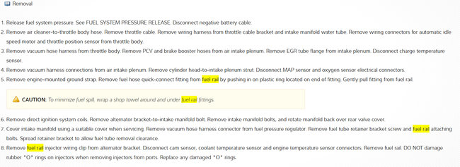

I would not recommend patching up any part of the fuel system. Gasoline is highly flammable and a leaking fuel rail is a good way to start a fire. I have included in the diagrams below instructions for the removal and installation of the fuel rails for your vehicle.
