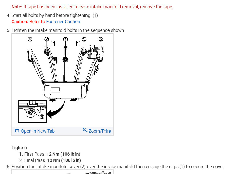

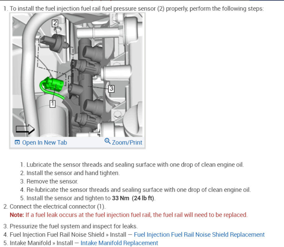

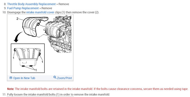

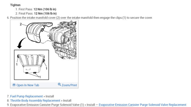

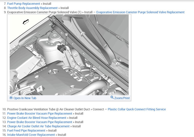

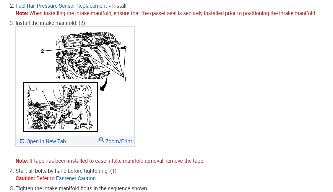

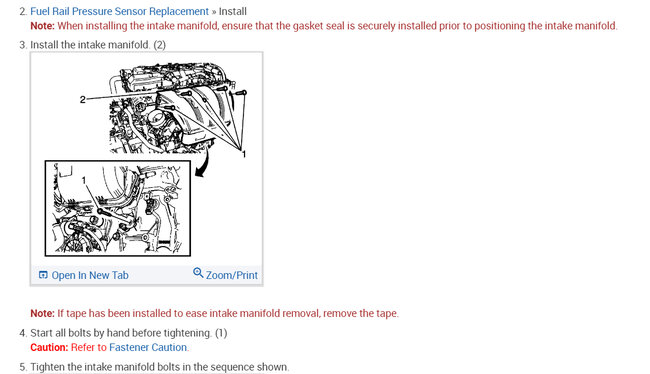

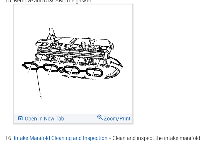

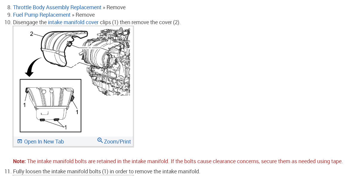

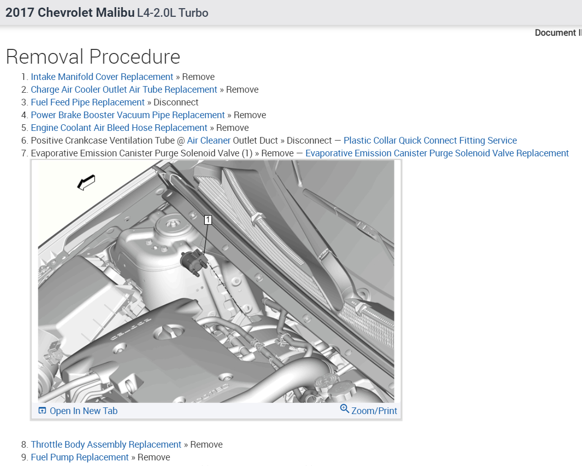

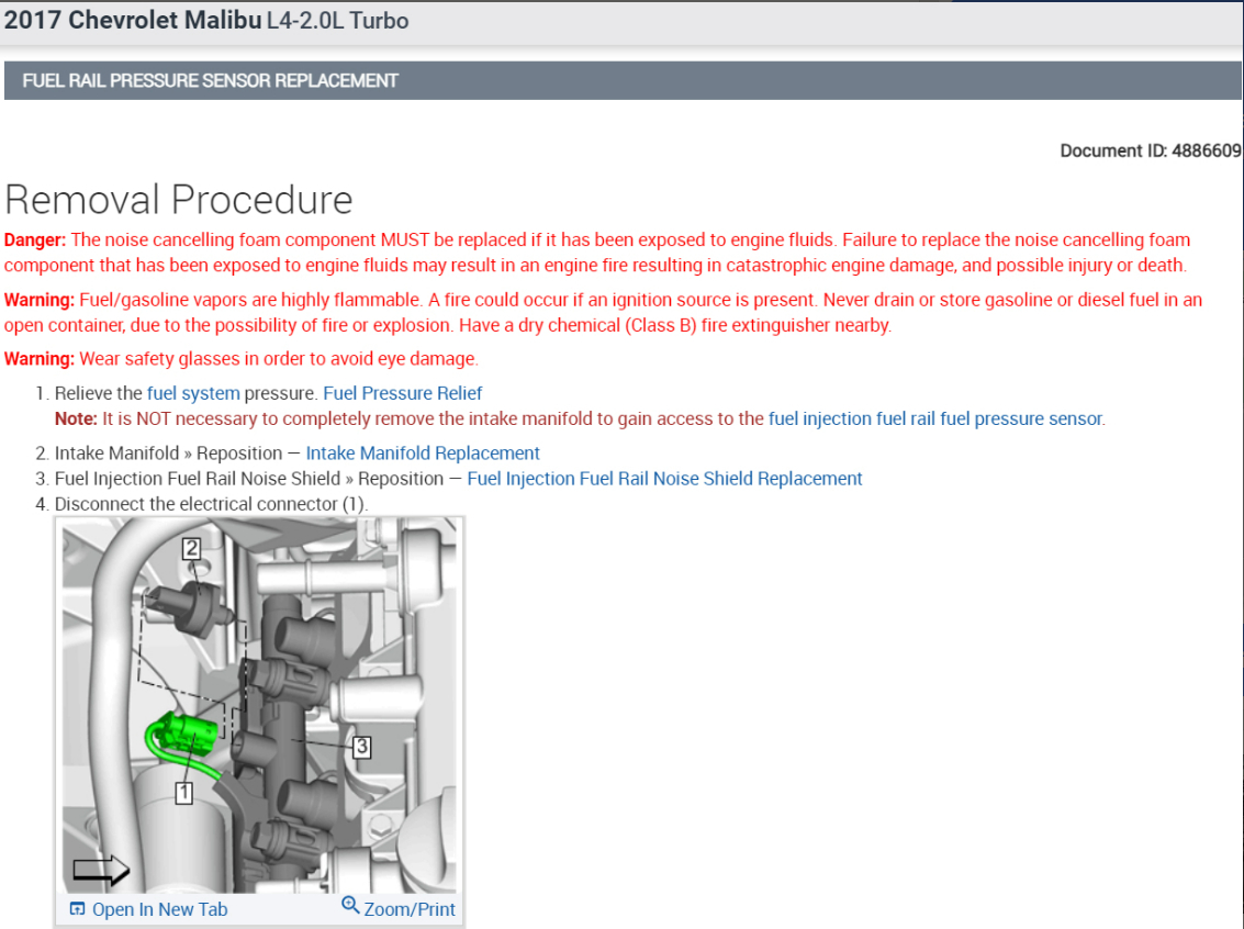

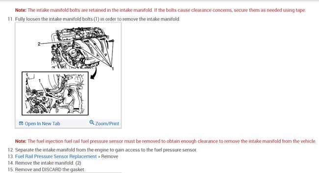

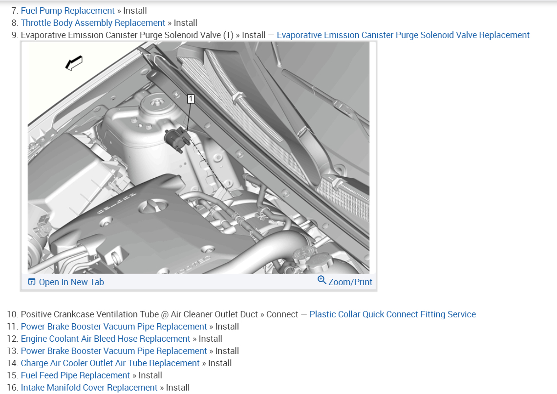

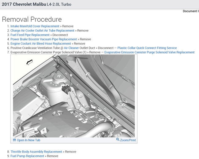

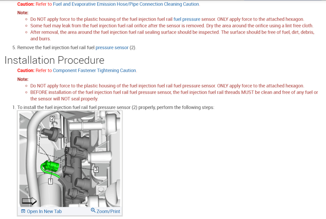

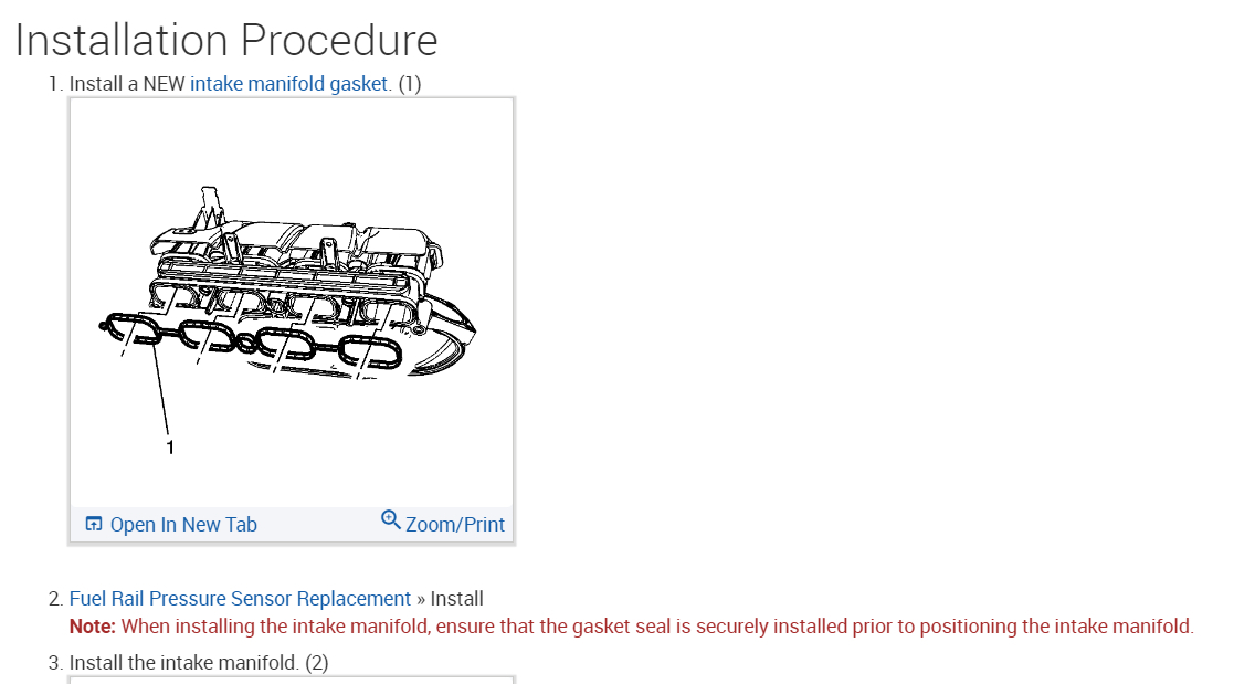

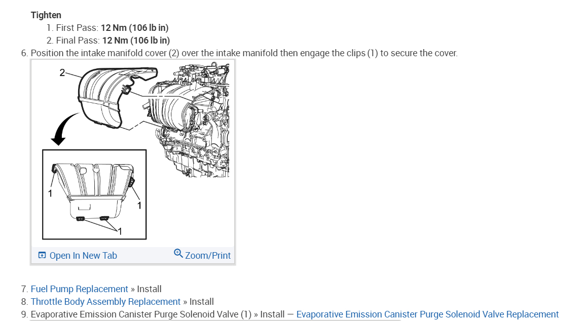

Could someone give me a step-by-step instructions or images of how to get to the fuel rail fuel pressure sensor
Aug 18, 2023 at 11:53 AM
  • 55,721 POSTS
Here is the location of the sensor so you can change it out and how to remove the intake manifold to get to the sensor. Check out the images (below). Please let us know if you need anything else to get the problem fixed.
