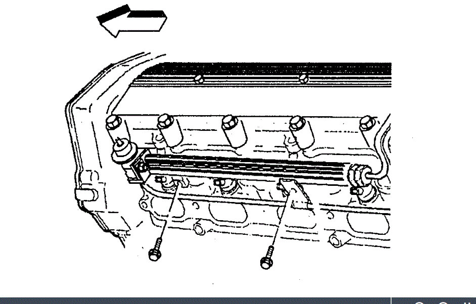

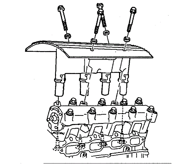

Can i spray all the junk from around fuel injectors with 2+2? if not what's okay to use?
Aug 6, 2020 at 9:51 PM
Good morning,
Yes, you can use 2+2. Make sure you let it sit for a while to evaporate before starting. If there is heat or a spark leak, all that spray would ignite under the hood and you would have a fire.
Are you having a issue with the injectors?
Aug 7, 2020 at 9:36 AM
ROGERMM65
  • 50 POSTS

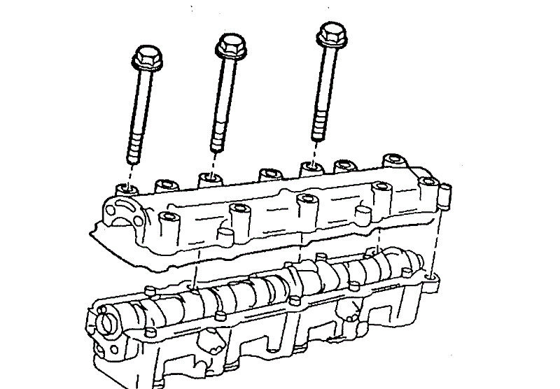

No problems with injectors yet. started to replace cam cover gaskets , wishing i would have pulled the motor now. back yard mechanical technologies at work here. darn weather .
Aug 7, 2020 at 7:25 PM
I understand.
I just do not want you to start a fire. 2+2 is great stuff and works as well as brake kleen. They are just very flammable.
The lower housing to the head has a gasket but the upper cover does not. You use sealer. The gray sealer is what is used from the factory.
