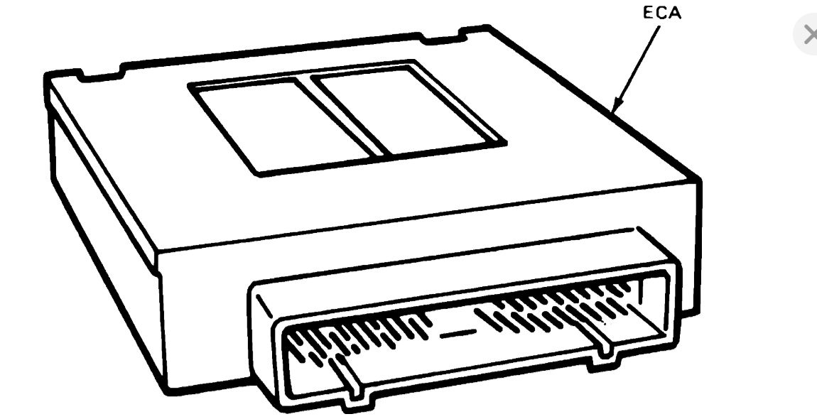

The ECM is what controls the fuel pump. They should come on for two seconds with the key on. Then they will come on all the time with the key cranking and the engine running.

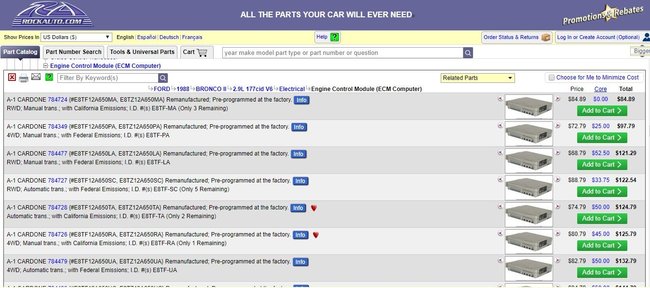

If you replace the relay, then most likely it is the ECM that has failed.
It is inside the right under the right side of the dash by the cowl.
