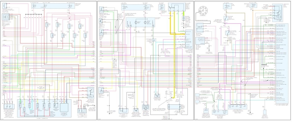

Fuel pump relay checks fine, fuse is good. Engine runs fine if I manually prime the throttle body with a dribble of gas but the pump won't run before the engine starts. My manual doesn't show details of the primping ckt.
Aug 28, 2019 at 6:54 AM
Good afternoon,

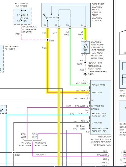

The two second prime comes from the PCM. It is sent to the fuel pump through the relay and the module on the left front frame rail.

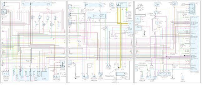

I attached a wiring diagram of the pump for you to view.
Aug 28, 2019 at 7:09 AM
TYLER WOODS
So my problem must be between the relay and the PCM (or the PCM itself) since the vehicle runs well once started. Thanks.
Aug 29, 2019 at 12:26 AM
That is correct. My bet is the PCM.
