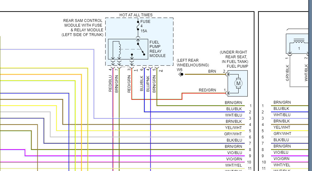

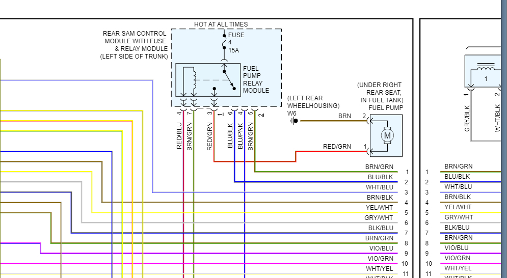

I forgot the factory placement of the colored wires going in connector for fuel pump. Can somebody help? And my name is Phillip. Lol. I have a green and red that's one, a brown 2, a blue and light purple or pink is 3, a blue and black that's four, and a green and brown. Can someone show me a picture, or two in which order they go. I think it's a factory and my camera is on the fritz or I would take a picture.

So unfortunately, we don't have a diagram of the actual connector showing the wire placement, but we do have a wiring diagram that will help with the arrangement.
Also, here is a guide that will help with testing the wiring if needed:
If you look at the wiring diagram below you will see the wiring is numbered so this is the order that they need to go. Not in the order that they are laid out. They arrange them on this diagram so that they limit the confusion.
Let me know if you can get a picture of the connector if you need more info and I am sure we can figure out the arrangement.
