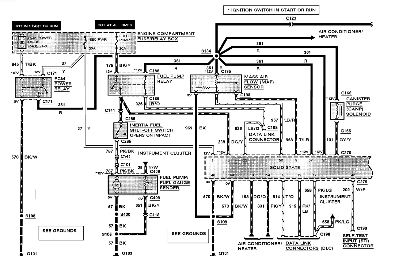

I need to know how connector is wired
Jun 20, 2026 at 3:56 PM
Experienced Mechanic
55,562 POSTS
Sure, here is how the fuel pump is wired via the fuel pump wiring diagrams. Check out the images (below). Let me know if you need anything else.
Jun 20, 2026 at 6:04 PM
55,562 POSTS
