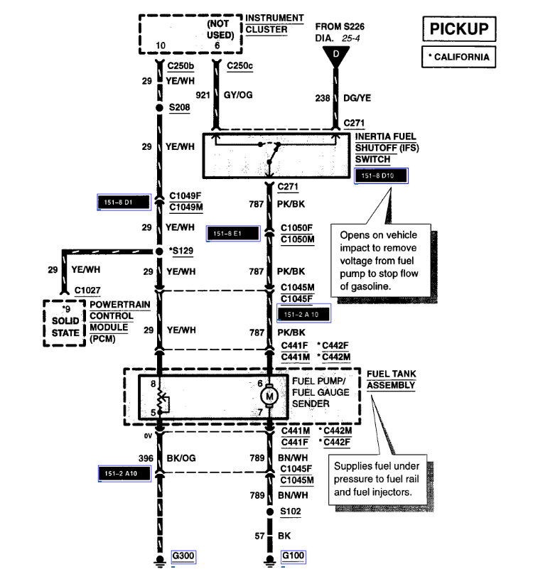

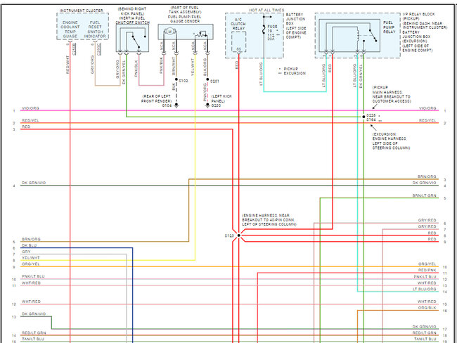

Need to know what wires are what for the fuel pump on my truck listed above super duty XLT 4x4. The wiring plug broke and now I don't know which wire goes where. Please help me figure this out. Thanks for any and all help.

Sure, here are the fuel pump wiring diagrams and I have included the fuel pump connector view for clarification. Check out the images (below). Let us know if you need anything else.
