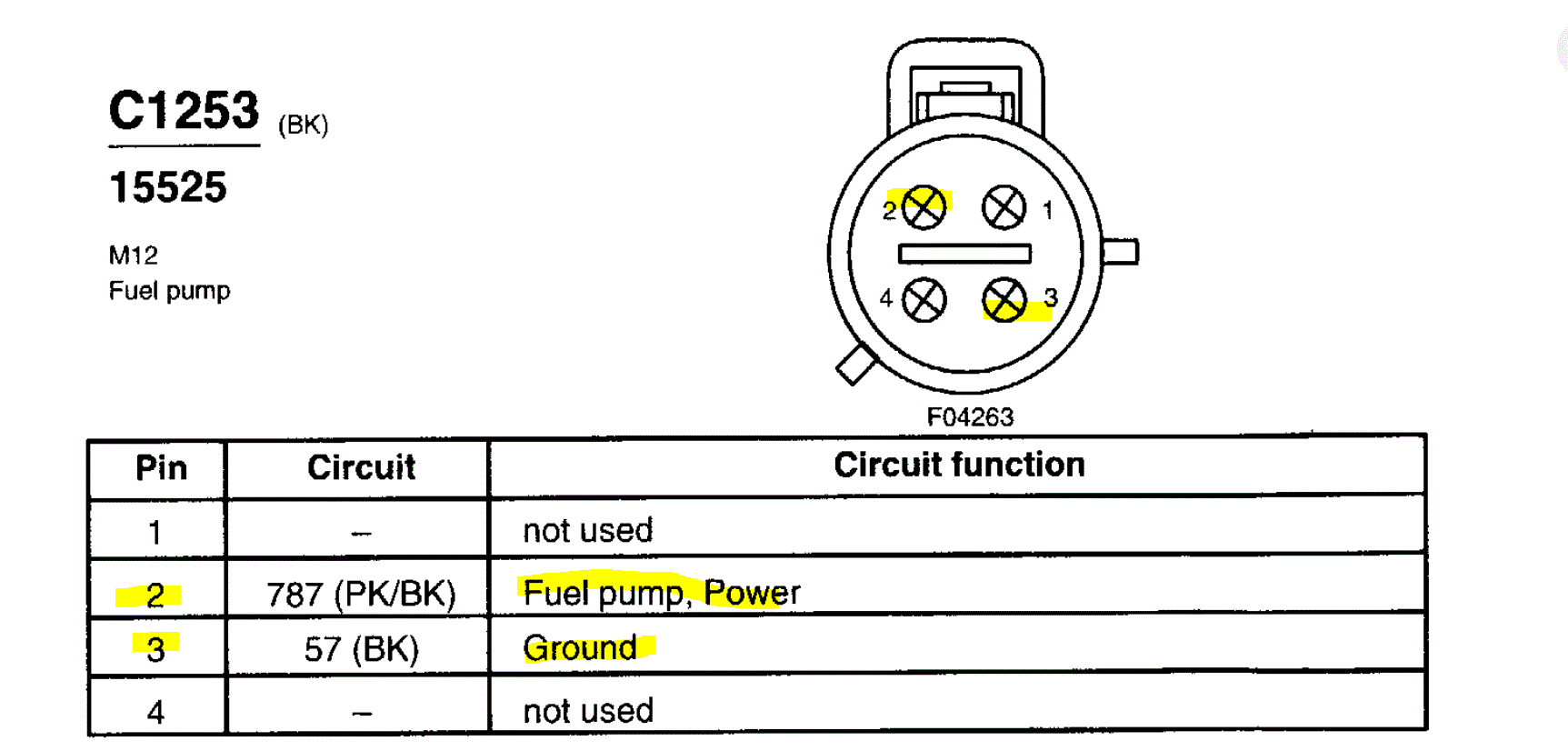

is there suppose to be a ground wire going from fuel pump to frame or body?? it's like I have an extra wire??

At the fuel pump, there are only two wires. One is a power supply and the other is ground. The ground is a black wire.
I attached a pic of the connector below. It is a 4 pin connector, but only two of the pins are used. Let me know if that helps or if you have other questions. Also, on the connector side, check pin 3 for continuity to ground to confirm it is the correct pin.
See pic below.
