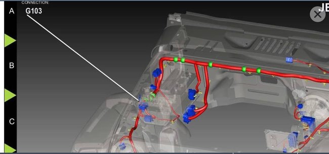

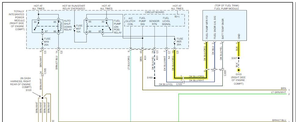

About two weeks ago my vehicle shut off driving down the road. Now it cranks but will not start. I have verified no fuses are blown. I have verified battery power coming from the fuel pump relay. I have also verified power at the connector to the fuel pump. I replaced the fuel pump and still does not turn on.

If you have power to the dark blue/orange wire to the pump module, then check the ground. If you have a bad ground, the pump will not run.
If that is good, then the only thing left is the fuel pump.
I also attached the location of the ground connection under the hood.
