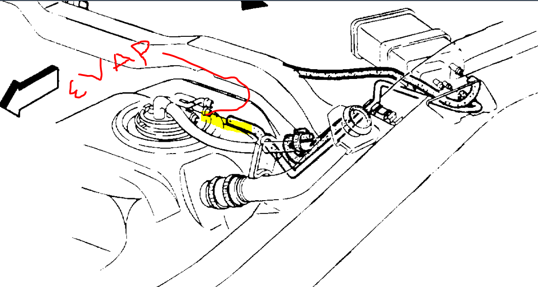

I am about 85% sure I have them correct, but I just want to be certain, which line on the pump module is the return line, the one next to the pump output line, or the next one over??

Here is what I can tell you. The fuel feed line is 3/8" diameter and the fuel return line is 5/16" diameter. Does that help? I can't picture the orientation you described.

Actually there are two ports on the fuel pump module that are 5/16”. When looking at the tank from the top, it goes 3/8”, at the top then one 5/16” under that then another under that. There isn’t much play in the lines, so I think I have them hooked up correctly, but I wanted to verify which one of the 5/16” was the return and which one went to the evap canister.

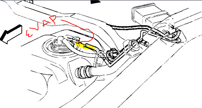

I attached a pic of the EVAP canister hose. Let me know if it helps. I have no good clear pictures. Sorry about that.
