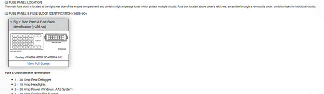

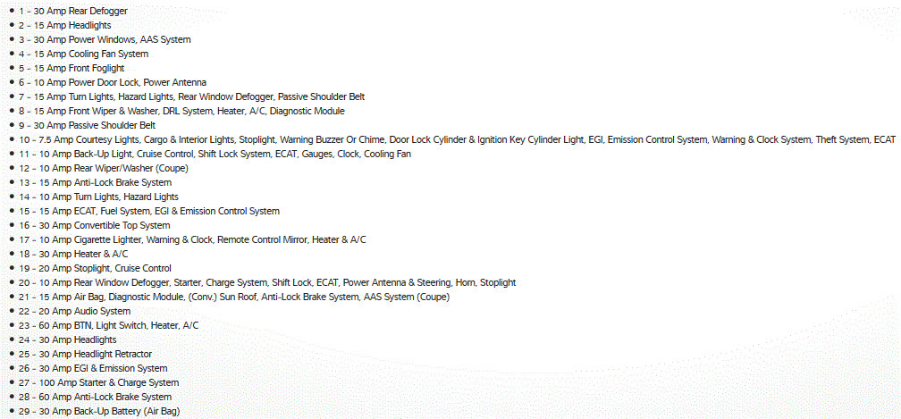

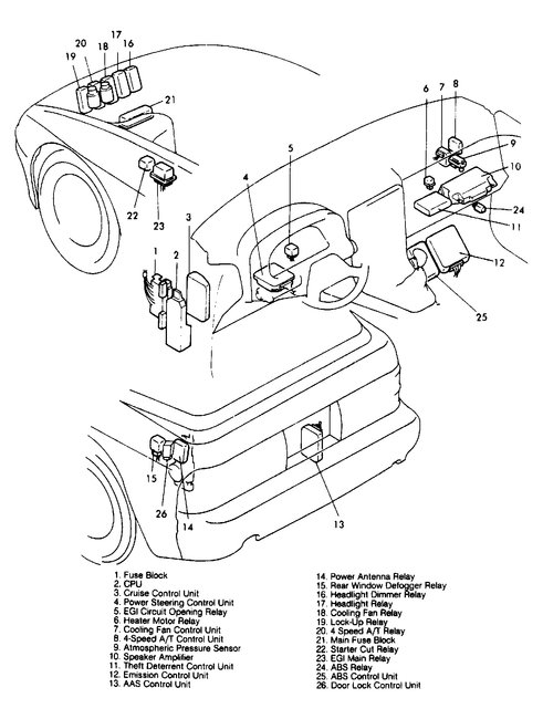

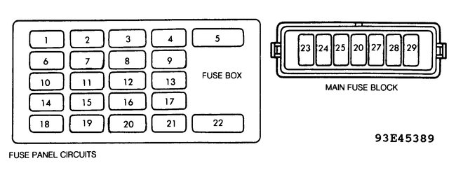

Always start with the simple things first. Personally, I'd check to make sure that that test connector is receiving power. Just probe it with a multi-meter and see. Also, check your fuses. Particularly #15. A blown fuse there and your car will be dead in the water. Then, just because you have power to the fuse doesn't mean that you have power at the pump. So you'll have to check for 12 volts at the connector while someone turns the key. If there isn't 12 volts consistent power, then the problem isn't your pump, it's in the wiring somewhere.

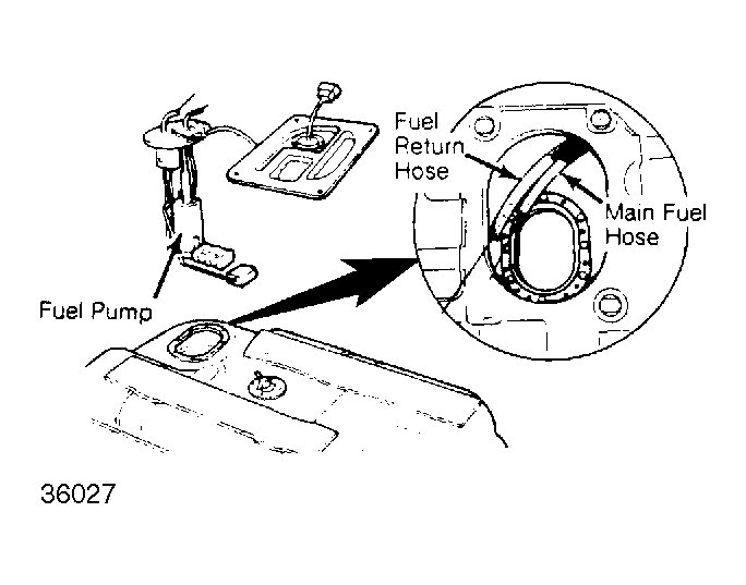

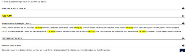

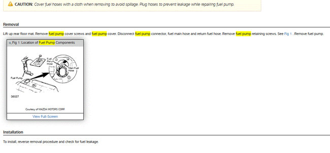

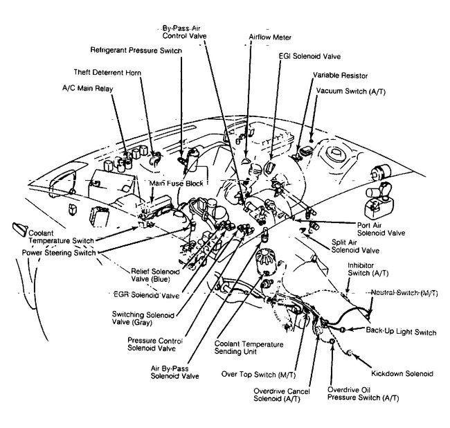

As for testing at the pump, the good news is that you don't have to drop the fuel tank to test it out. I've attached all of the pertinent information in the images below. Let us know what you find and we'll move on with troubleshooting.

I wanted to give you an update of what I found. Under the hood, near the coolant reservoir, a relay with its cap bolted in that area often comes out of its cap. I reinserted the relay back into its cap (but it is still susceptible to come off its cap, need to secure it tightly later). After I recapped the relay, I was able to get the car started. Is that relay related to the function of the fuel pump? Assuming it is: why would the cap off prevent the relay from doing its job? Ground maybe?
Jan 13, 2019 at 6:10 AM

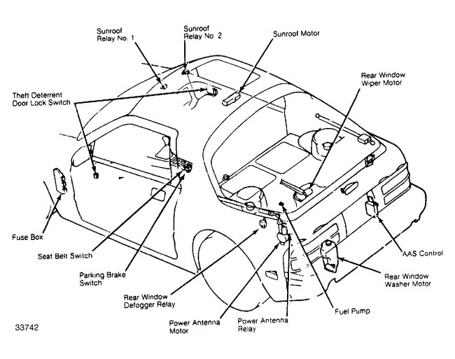

HARRY P
  • 2,292 POSTS
Hmm, I'm having a hard time finding it. Do you see it in any of the attached pictures? Also, is this a turbo car? Or any trim level for that matter?
