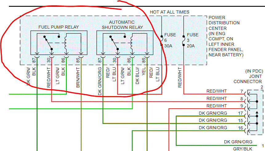

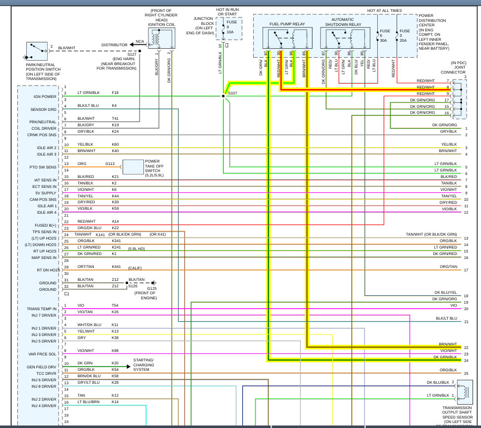

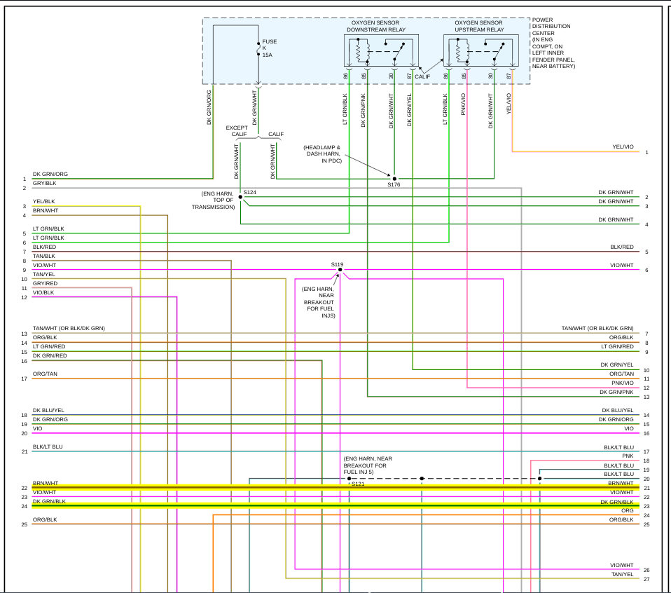

Turn on key no fuel pump noise, no start. New relay, have power to relay when off and at 2 points when key is on.

It sounds like the fuel pump has failed. Since you are getting power to the relay, the next check would be to test for power at the fuel pump. If there is power, replace the pump. Additionally, if there is power at the pump, confirm there is a good ground.

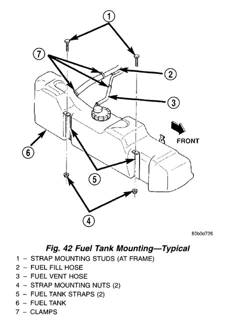

7. Place a transmission jack under center of fuel tank. Apply a slight amount of pressure to fuel tank with transmission jack.
Fig. 42 Fuel Tank Mounting (Typical)
Pic 1
8. Remove fuel tank mounting strap nuts from mounting strap studs (Fig. 42). If equipped, remove fuel tank shield bolts.
9. Lower fuel tank only enough to allow access to top of tank. The 2 tank fittings (where rubber fuel fill and vent hose connections are made) must be positioned above tank level. Rotate tank slightly to allow these fittings to be above tank level.

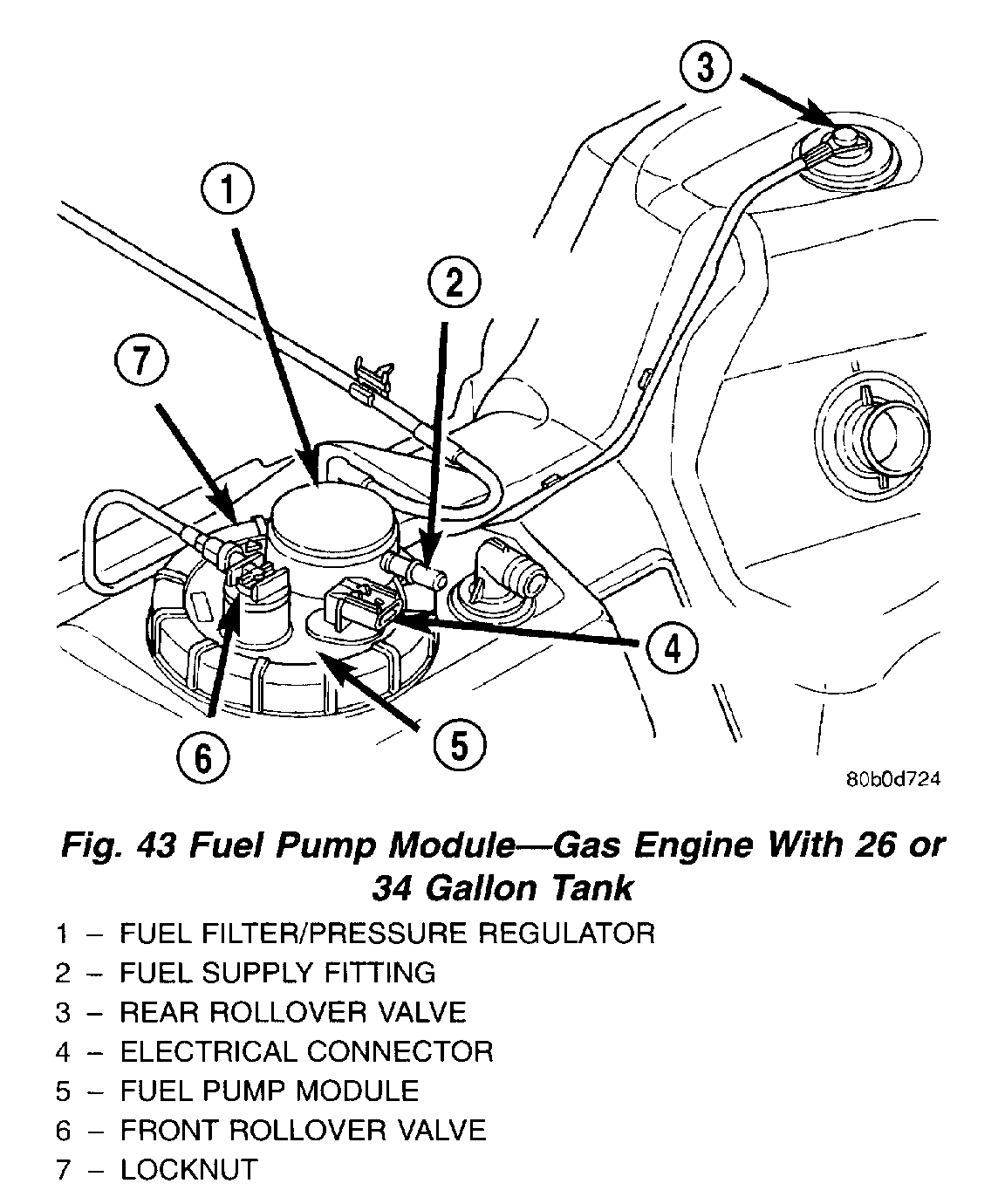

Fig. 43 Fuel Pump Module - Gas Engine With 26 Or 34 Gallon Tank
pic 2

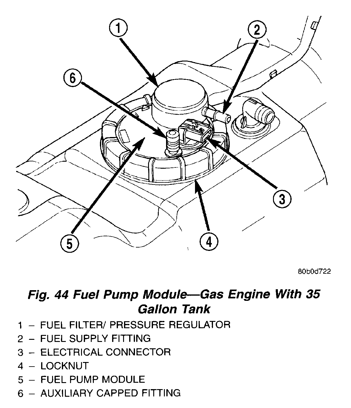

Fig. 44 Fuel Pump Module - Gas Engine With 35 Gallon Tank
pic 3
a. While working over left rear tire/wheel, disconnect wiring harness connector from electrical connector at top of fuel pump module (Fig. 43) or (Fig. 44).
b. If equipped with 26 or 34 gallon fuel tank, two EVAP lines are connected to rollover valves. Disconnect EVAP line from rollover valve at top of module (Fig. 43). Disconnect other EVAP line from rollover valve near rear of tank (Fig. 43).

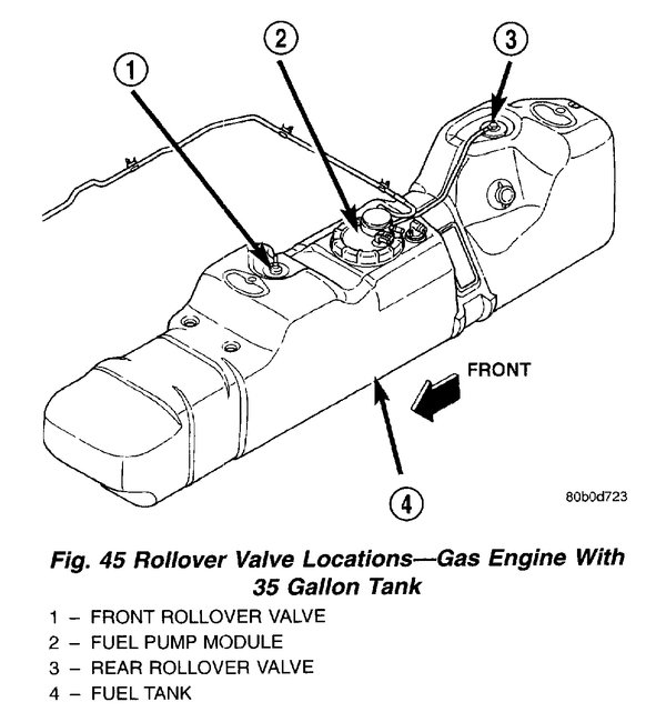

Fig. 45 Rollover Valve Locations - Gas Engine With 35 Gallon Tank
pic 4
c. If equipped with 35 gallon fuel tank, two EVAP lines are connected to rollover valves. Disconnect EVAP lines from rollover valves at top-front and top-rear of fuel tank (Fig. 45).
d. Disconnect fuel supply line at fuel filter/fuel pressure regulator supply fitting (Fig. 43) or (Fig. 44). Refer to Quick-Connect Fittings for procedures.

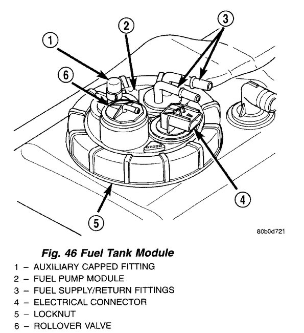

13. Diesel Powered Engines:
Fig. 46 Fuel Tank Module
pic 5
a. While working over left rear tire/wheel, disconnect wiring harness connector from electrical connector at top of fuel tank module (Fig. 46).
b. Disconnect fuel supply and fuel return lines at the fuel tank module fittings (Fig. 46). Refer to Quick-Connect Fittings for procedures.
14. Gasoline Engines: If fuel pump module removal is necessary, refer to Fuel Pump Module Removal/Installation. Diesel Engines: If fuel tank module removal is necessary, refer to Fuel Tank Module Removal/Installation.

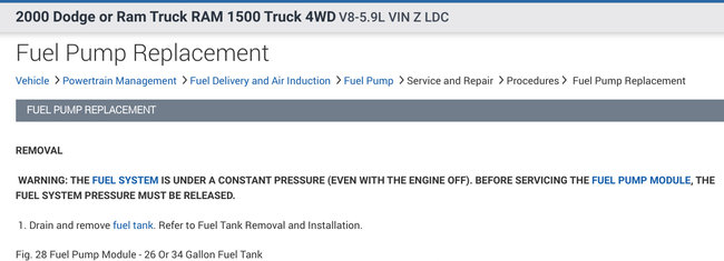

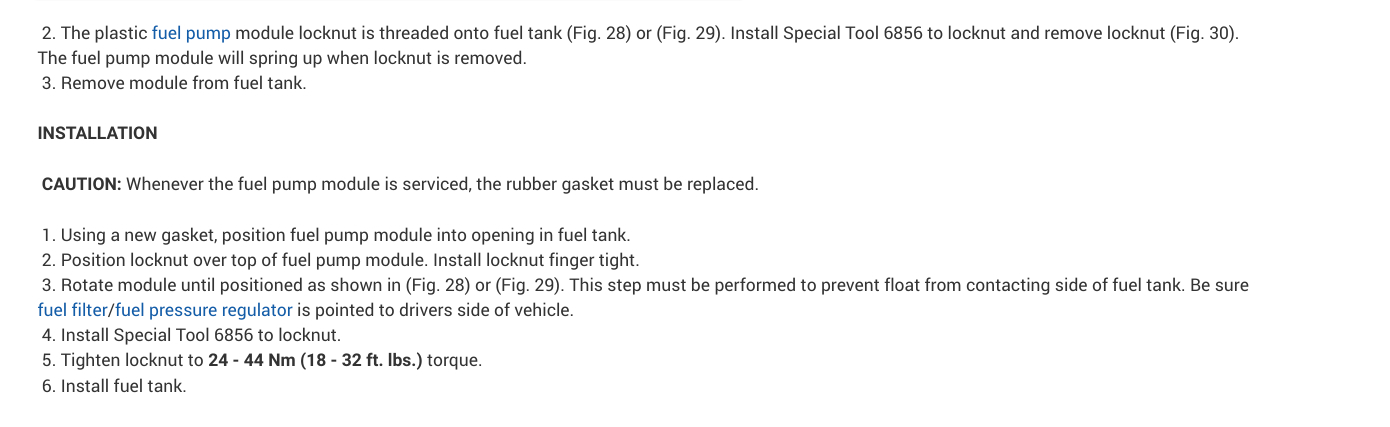

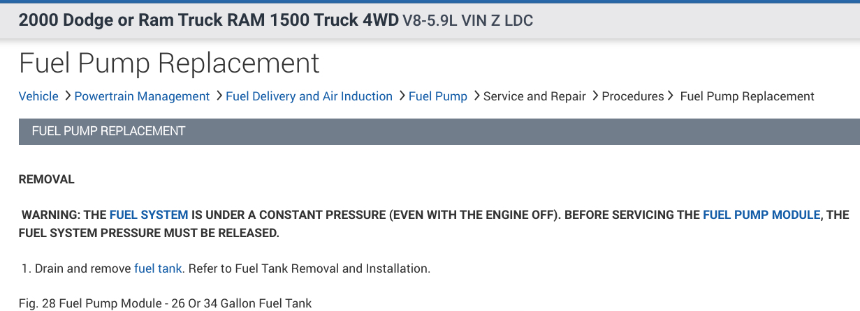

Here are the directions for replacing the pump. The remaining pics correlate with the directions.
_______________________________________
2000 Dodge or Ram Truck RAM 1500 Truck 4WD V8-5.9L VIN Z LDC
Fuel Pump Replacement
Vehicle Powertrain Management Fuel Delivery and Air Induction Fuel Pump Service and Repair Procedures Fuel Pump Replacement
FUEL PUMP REPLACEMENT
REMOVAL
WARNING: The fuel system is under a constant pressure (even with the engine off). Before servicing the fuel pump module, the fuel system pressure must be released.
1. Drain and remove fuel tank. Refer to Fuel Tank Removal and Installation.

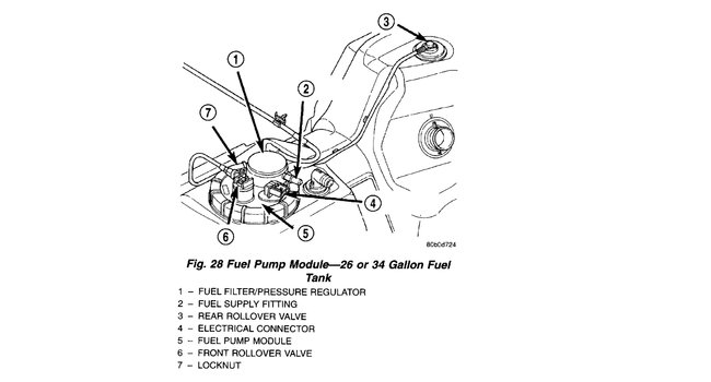

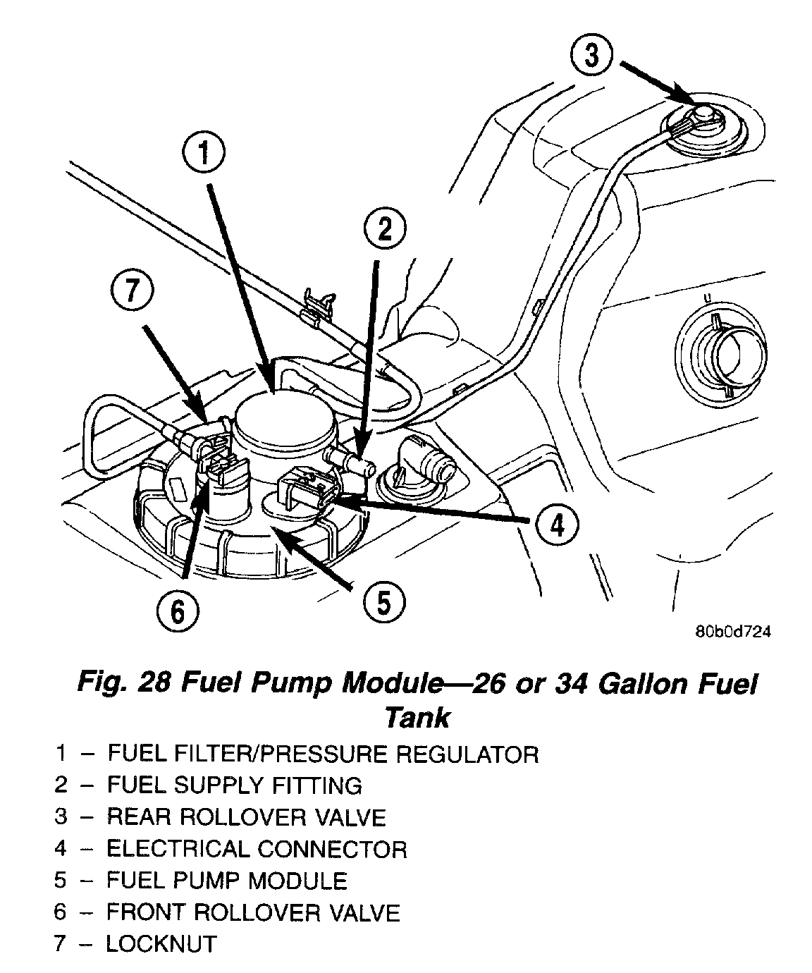

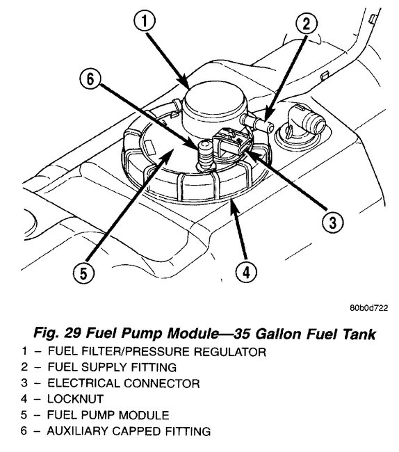

Fig. 28 Fuel Pump Module - 26 Or 34 Gallon Fuel Tank
pic 6

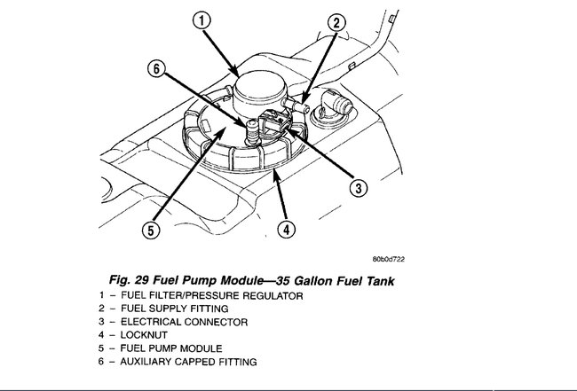

Fig. 29 Fuel Pump Module - 35 Gallon Fuel Tank
pic 7

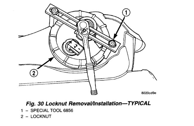

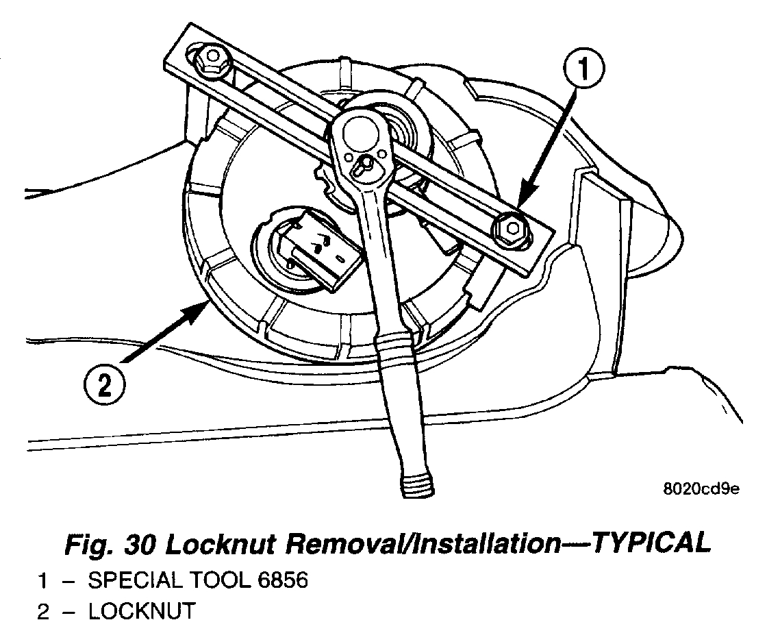

Fig. 30 Locknut Removal/Installation (Typical)
pic 8
2. The plastic fuel pump module locknut is threaded onto fuel tank (Fig. 28) or (Fig. 29). Install Special Tool 6856 to locknut and remove locknut (Fig. 30). The fuel pump module will spring up when locknut is removed.
3. Remove module from fuel tank.
INSTALLATION
CAUTION: Whenever the fuel pump module is serviced, the rubber gasket must be replaced.
1. Using a new gasket, position fuel pump module into opening in fuel tank.
2. Position locknut over top of fuel pump module. Install locknut finger tight.
3. Rotate module until positioned as shown in (Fig. 28) or (Fig. 29). This step must be performed to prevent float from contacting side of fuel tank. Be sure fuel filter/fuel pressure regulator is pointed to drivers side of vehicle.
4. Install Special Tool 6856 to locknut.
5. Tighten locknut to 24 - 44 Nm (18 - 32 ft. lbs.) torque.
6. Install fuel tank.

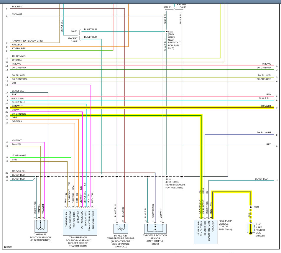

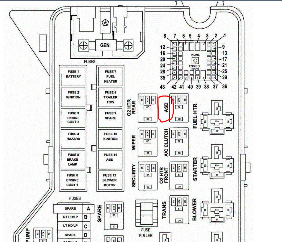

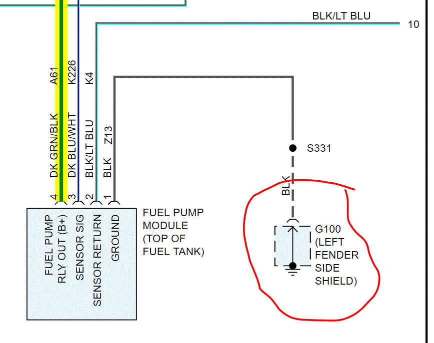

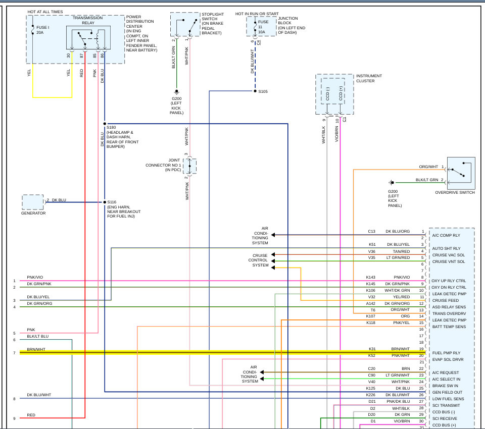

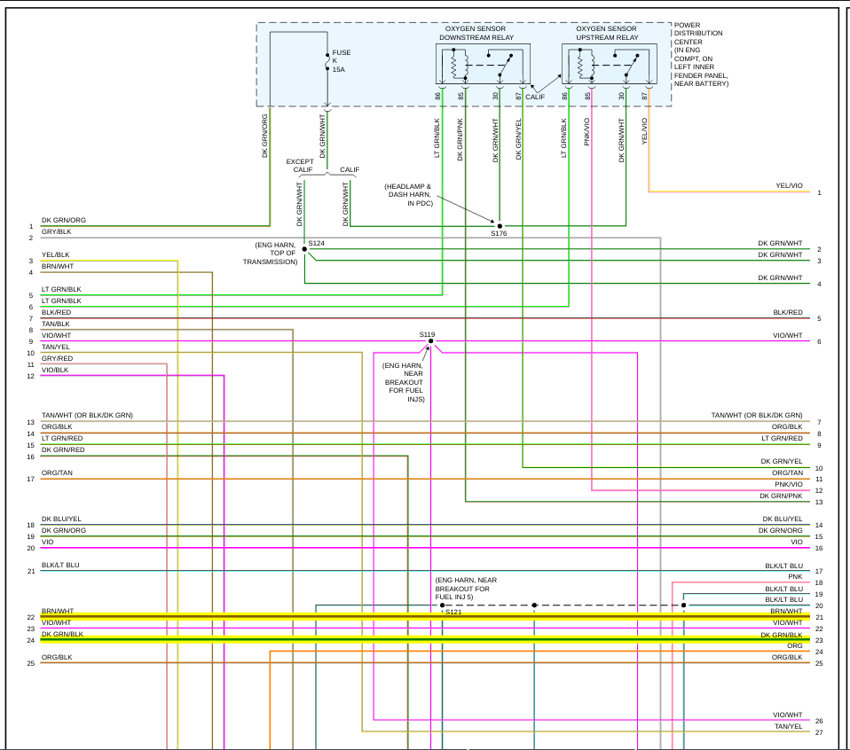

Keep in mind, this could also be a different issue. I would also check to see if there is spark to the plugs. This vehicle does have an ASD relay (auto shut down) See pic 9 and 10. I also attached a pic of the wiring at the pump. Make sure the ground is good as well and you should have power to the B+ wire when the key is first turned on to prime the system.
Let me know if this helps.

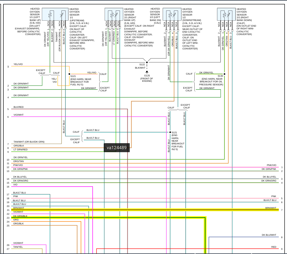

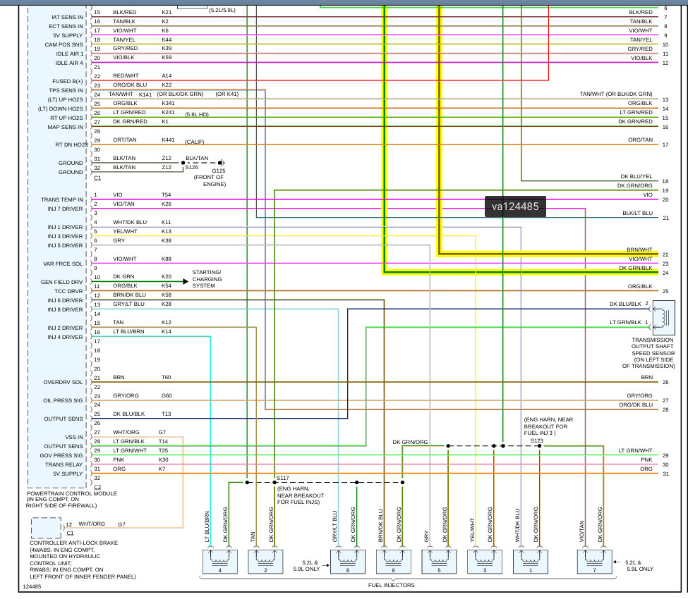

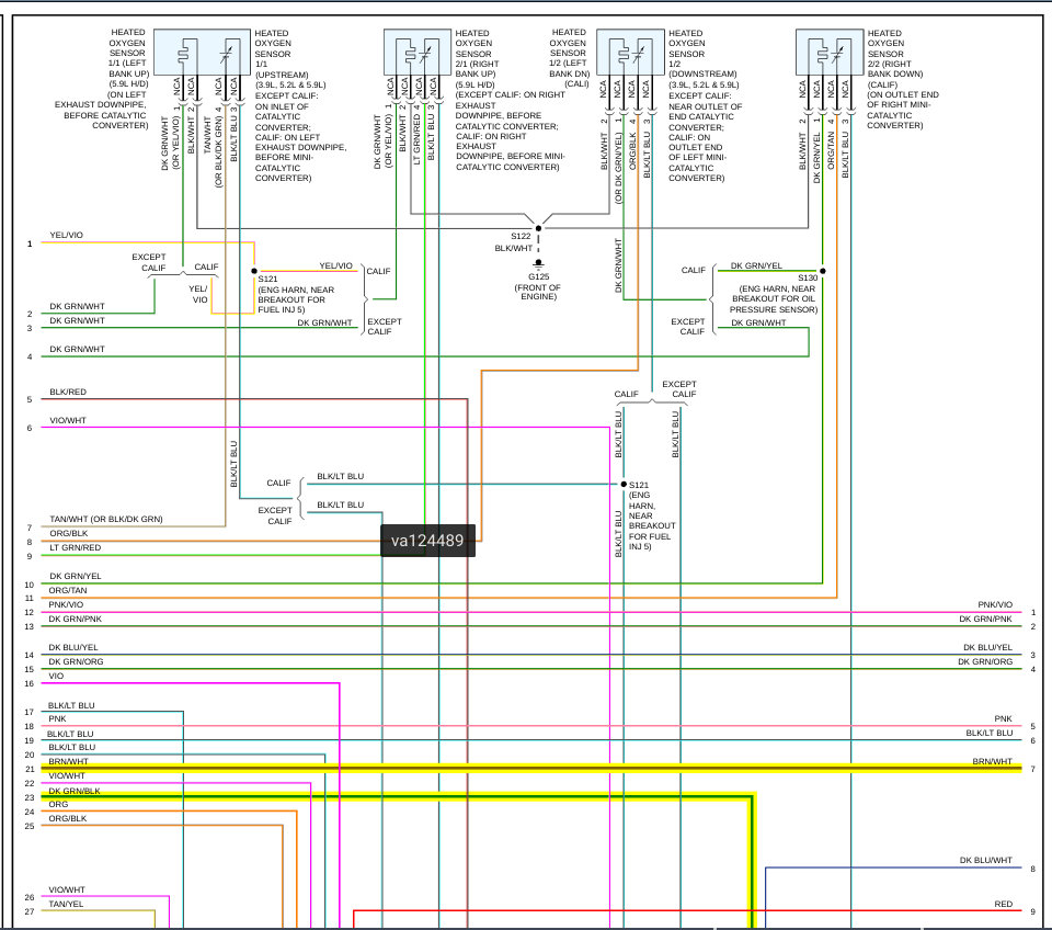

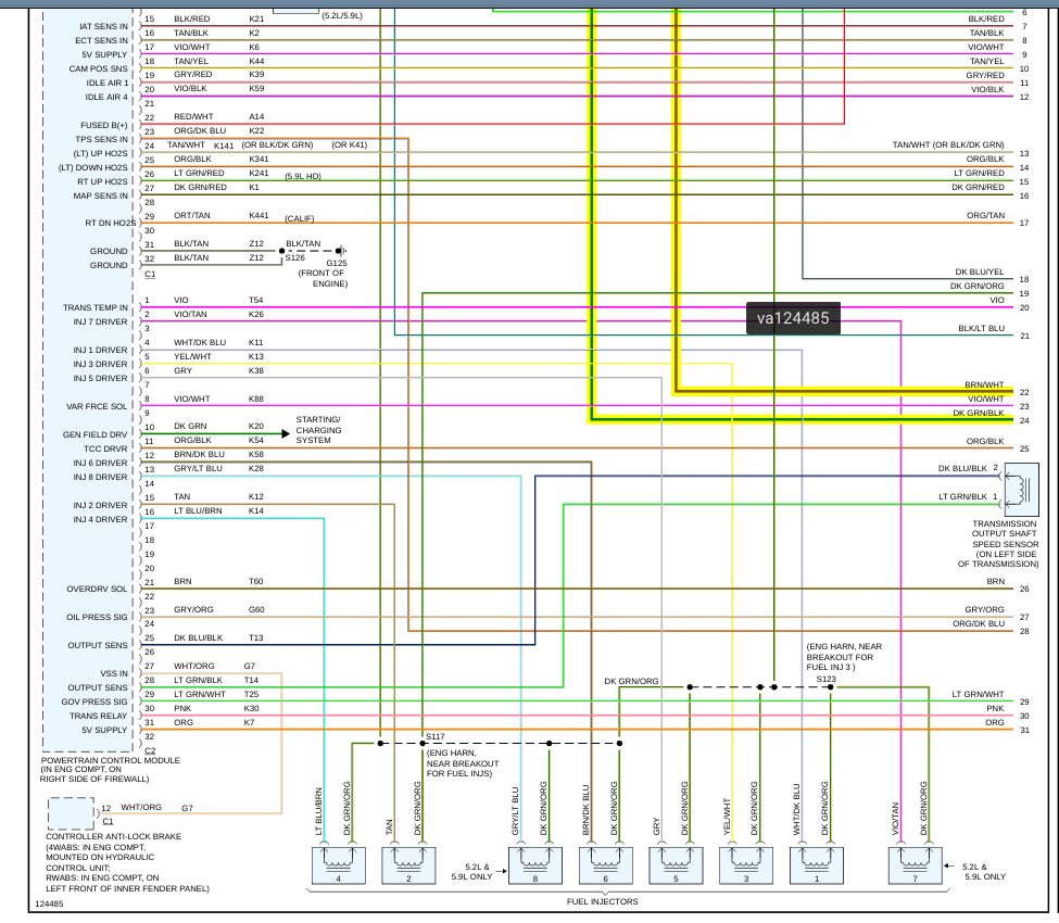

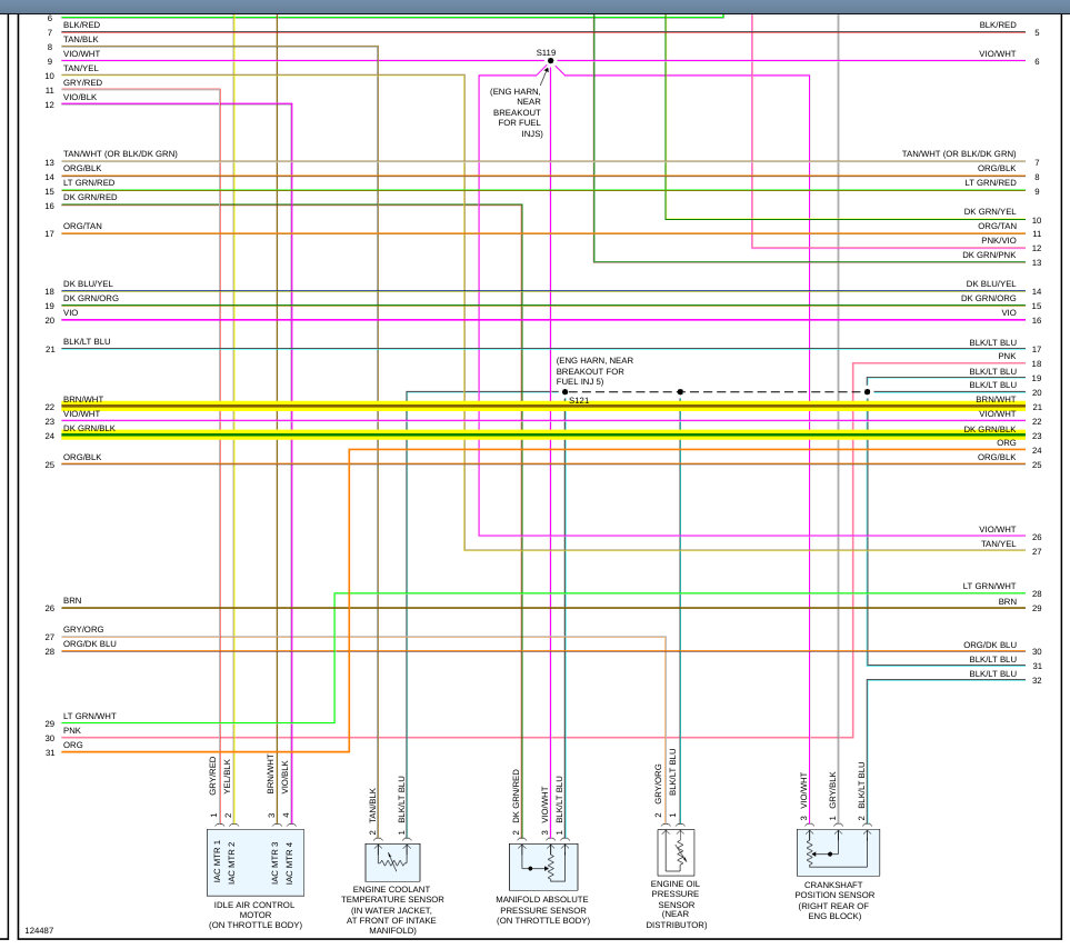

Okay, This is either going to be a problem with the wire going to the fuel pump, the fuel pump ground wire, the fuel pump electrical connector, or the fuel pump itself. In the diagrams down below I have included the engine management wiring diagrams with the fuel pump circuit highlighted for you and the instructions for the removal and installation of the fuel pump for your vehicle's. Please check the wires, the ground, and if they check out then replace your vehicle's fuel pump. Report back with what you find out, please.
Thanks,
Alex
2CarPros
Jan 30, 2020 at 2:56 PM

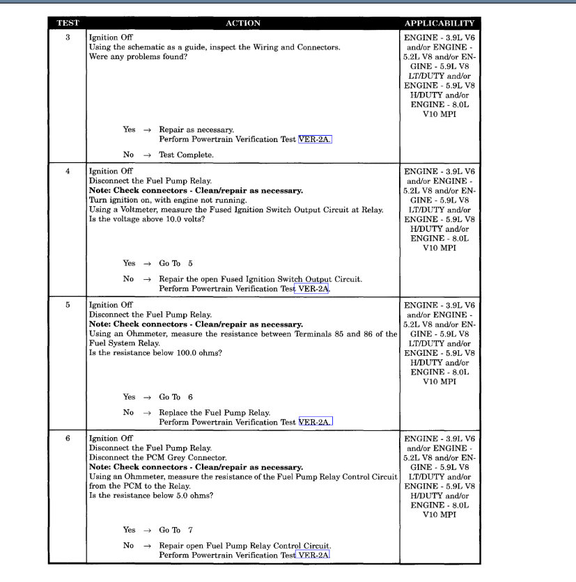

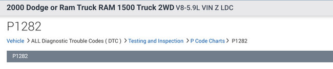

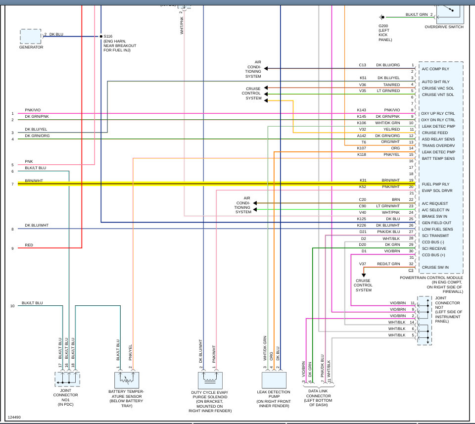

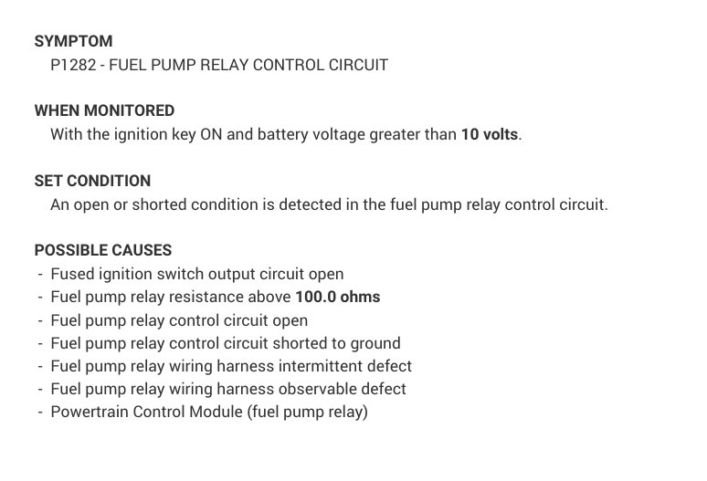

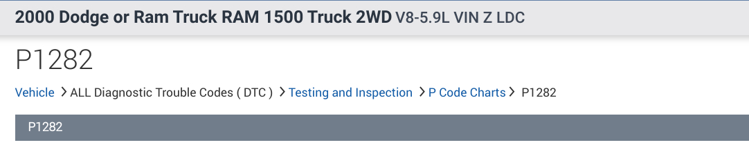

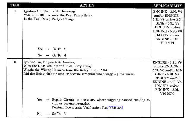

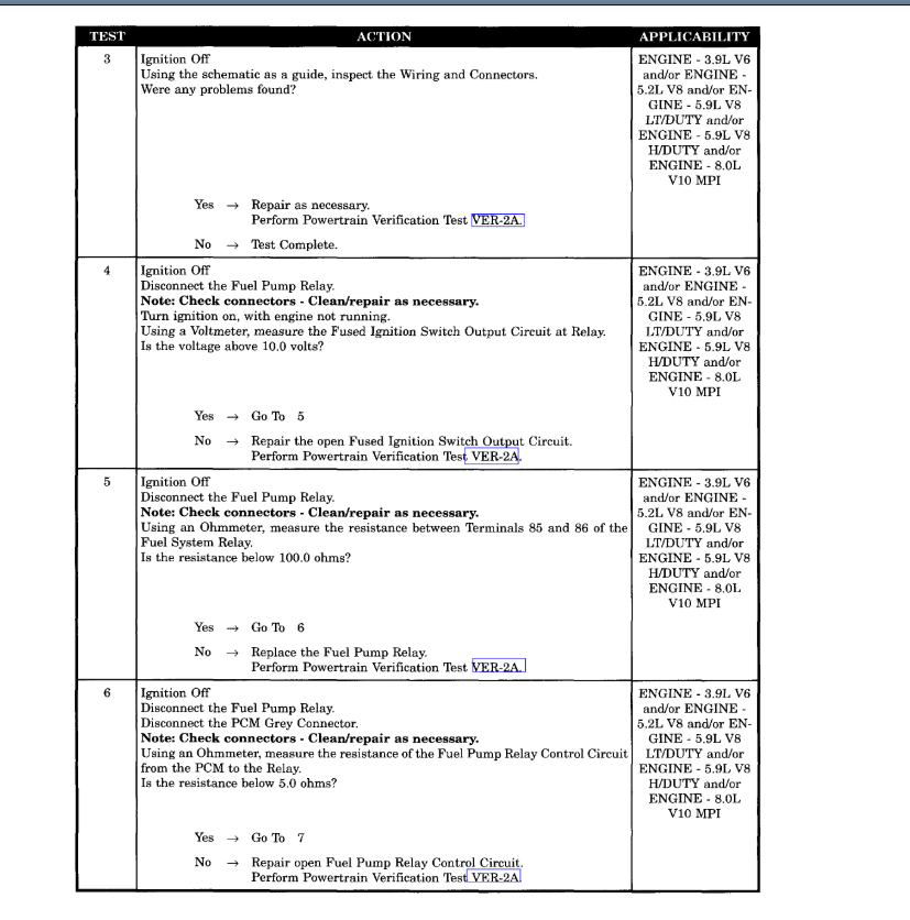

Good afternoon! So, I ended up running a new set of wires to the fuel pump, that didn't work. Today a friend of mine let me use his Autel MaxiPro. I got 1 code from 2 sources. P1282, from the PCM and the TCM. Same code from both. I read the code and I believe it is coming from the PDC. I check the wires coming from the pump relay. Red/white wire shows a constant power. When I turn the key to the on position I get a very low power from the brown/white wire. I just don't know where to go from there. Do you have any suggestions??
Feb 9, 2020 at 3:42 AM
SCGRANTURISMO
  • 4,897 POSTS
Hello again,

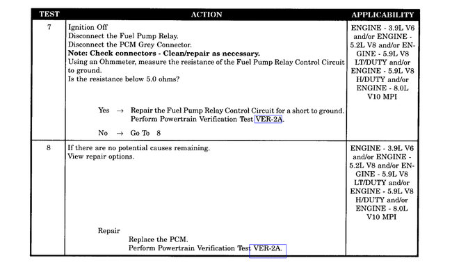

In the diagrams down below I have included the diagnostic troubleshooting flowchart from the vehicle manufacturer for Direct Trouble Code[DTC] P1282 for your vehicle. Please go through this flowchart and report back with what you find out. Here are a couple of links that you might need to work through the flowchart below:
Thanks,
Alex
2CarPros
Feb 9, 2020 at 4:01 AM
