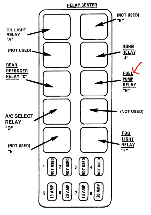

My car won't start. I do not hear the fuel pump. I replaced the fuel pump, computer, starter, crank sensor, checked fuses, replaced oil sending sw. I cannot figure out why the fuel pump won't come on and work. It was running and now it turned over, but I do not hear the fuel pump. I don't want to have to go through the entire electrical system, but I will if necessary.

I would check the fuses and if okay swap out the fuel pump relay, here is the location and a guide to help:
