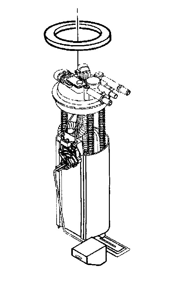

FUEL SENDER ASSEMBLY REPLACEMENT
The OEM service manual does not provide fuel pump service and repair information. Refer to Fuel Sender Assembly.
TOOLS REQUIRED
J 39765 Fuel Sender Lock Nut Wrench
REMOVAL PROCEDURE
CAUTION: Refer to Actions to Take When Working With Fuel Caution in Service Precautions.
pic 1
1. Relieve the fuel system pressure. Refer to Quick Connect Fitting(s) Service (Plastic Collar).

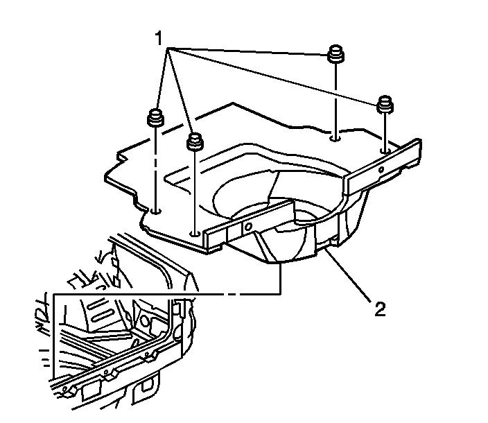

NOTE: In order to prevent damage, cover the fuel pipe fittings with a shop towel before disconnecting the fuel pipes or removal of the fuel sender retaining ring, in order to catch any fuel that may leak out. Place the towel in an approved container when procedure is completed.
pic 2
6. Disconnect the fuel sender quick-connect fittings.
7. Disconnect the fuel sender electrical connector.
8. Disconnect the fuel tank pressure sensor electrical connector.

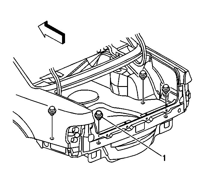

IMPORTANT:
^ Care should be taken not to fold over or twist the fuel pump strainer when installing the fuel sender assembly, as this will restrict fuel flow. Also, assure that the fuel pump strainer does not block full travel of the float arm.
^ Always replace the fuel sender seal when reinstalling the fuel sender.
pic 3
1. Position the new fuel sender seal on the fuel tank.
2. Install the fuel sender assembly and the fuel sender lock ring using the J 39765.
3. Connect the quick-connect fittings at the fuel sender.
4. Connect the fuel sender electrical connector.
5. Connect the fuel tank pressure sensor electrical connector.
6. Add fuel to the fuel tank.
7. Install the fuel tank filler pipe cap.
8. Connect the negative battery cable.
9. Inspect for leaks.

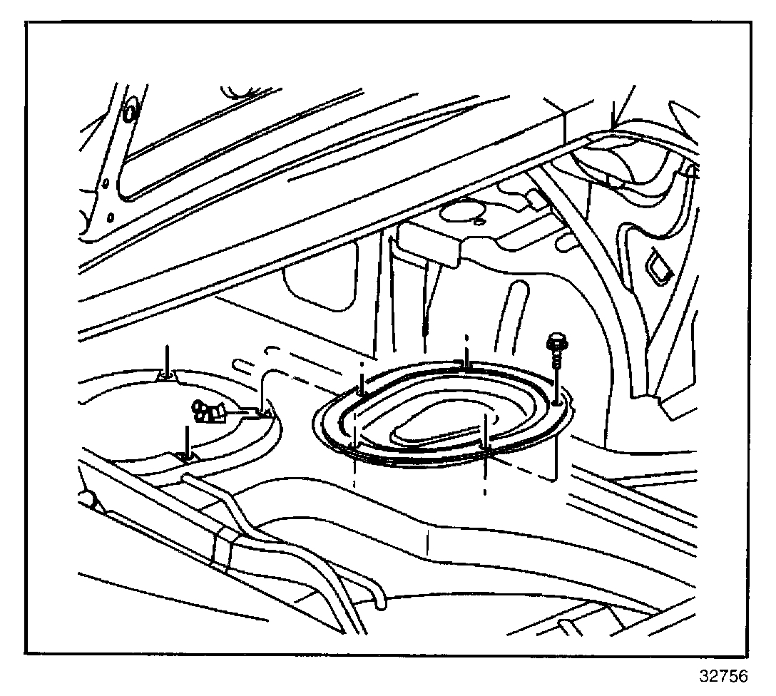

NOTE: Refer to Fastener Notice in Service Precautions.
pic 4
10. Install the fuel sender access panel.
11. Install the fuel sender access panel bolts.
Tighten
Tighten the fuel sender access panel bolts to 2 N.m (18 lb in).
