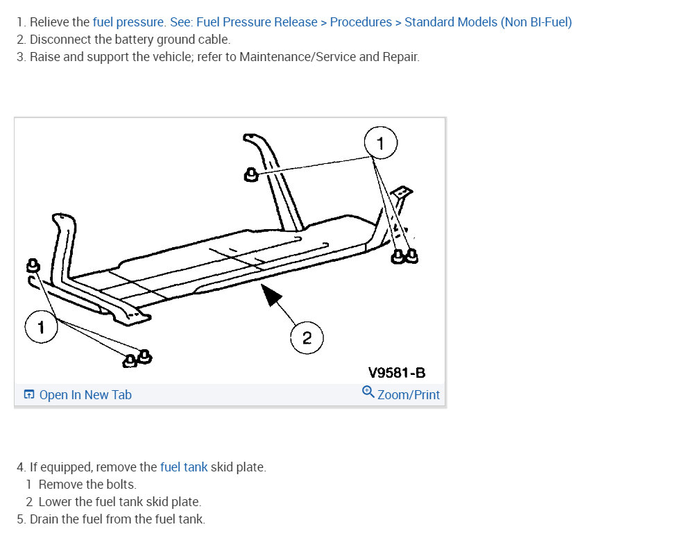

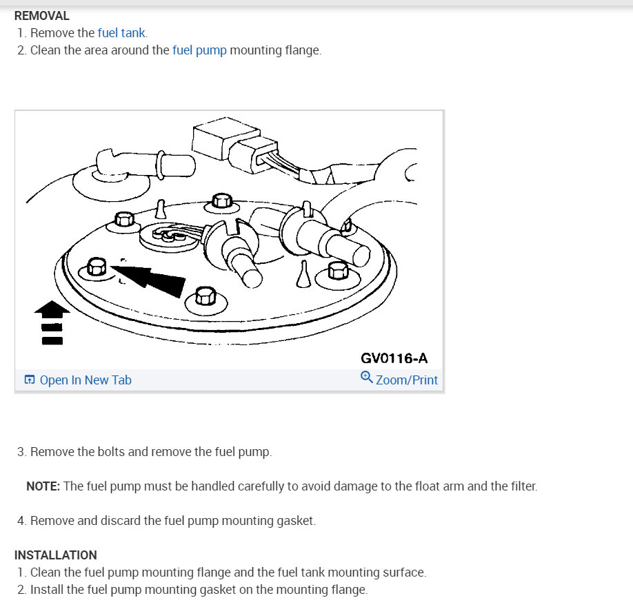

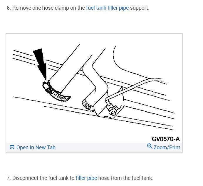

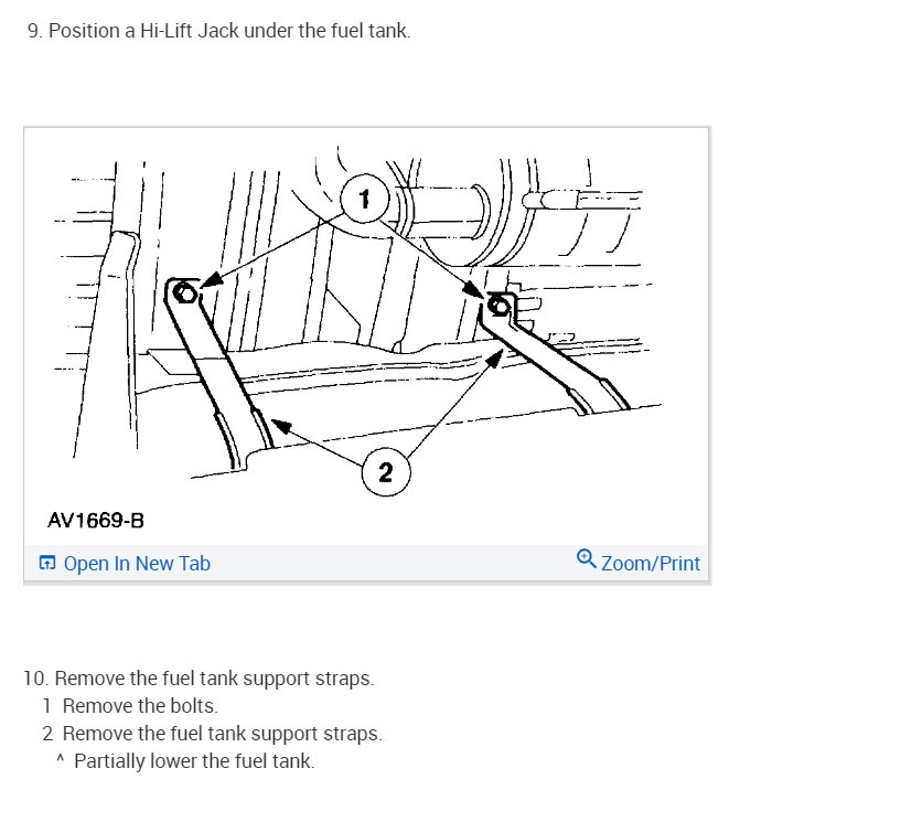

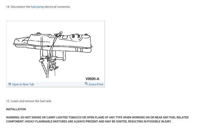

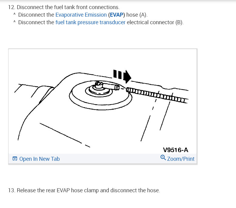

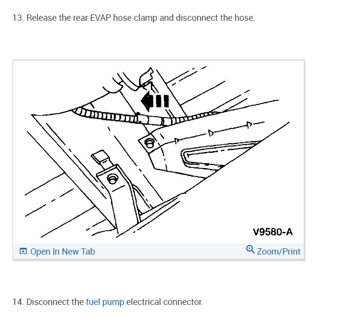

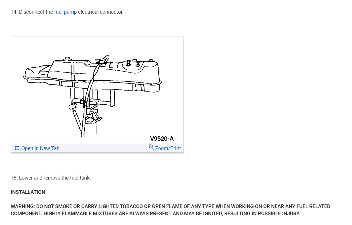

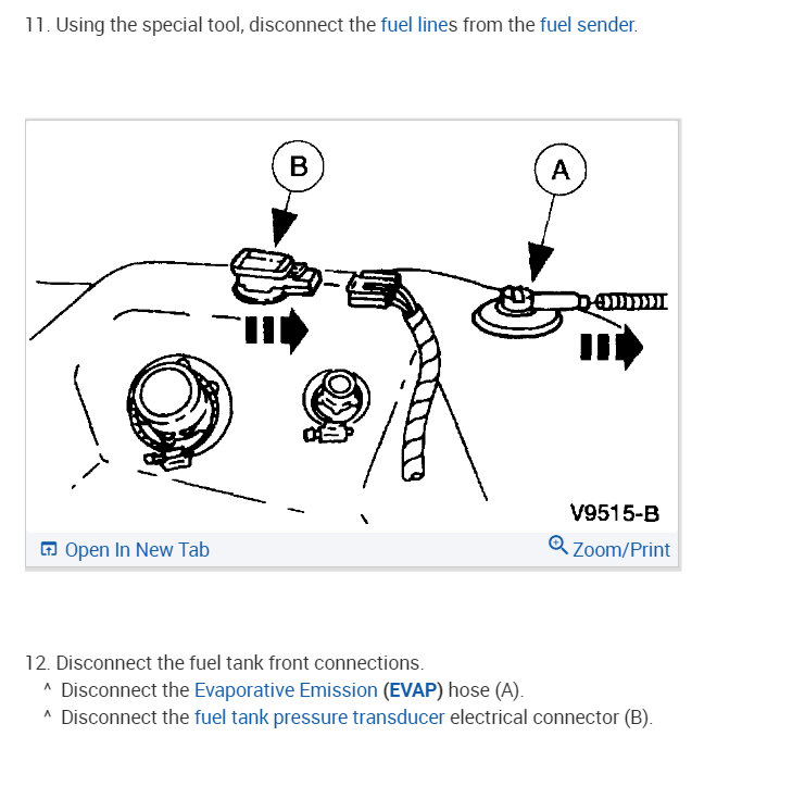

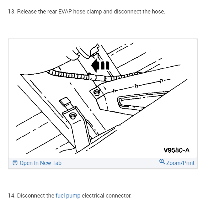

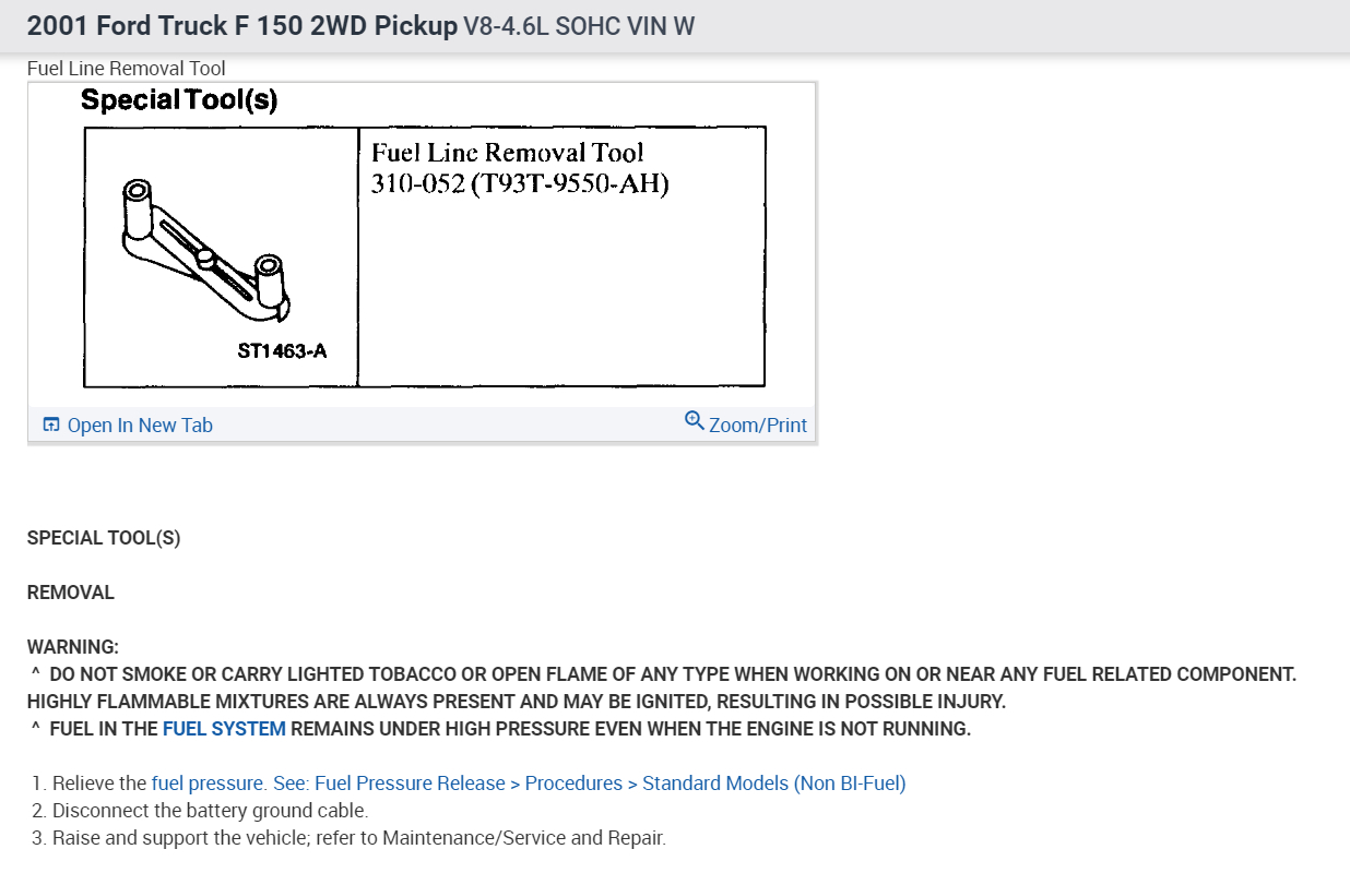

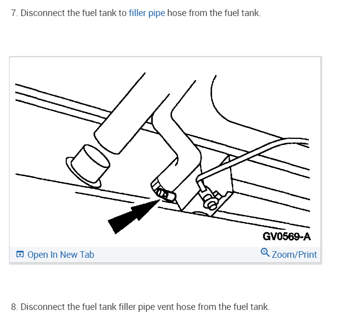

Where is the fuel pump's exact location through the bed floor, like the exact dimensions from length x width and in what area in the bed.
Feb 24, 2023 at 12:22 PM
  • 55,432 POSTS

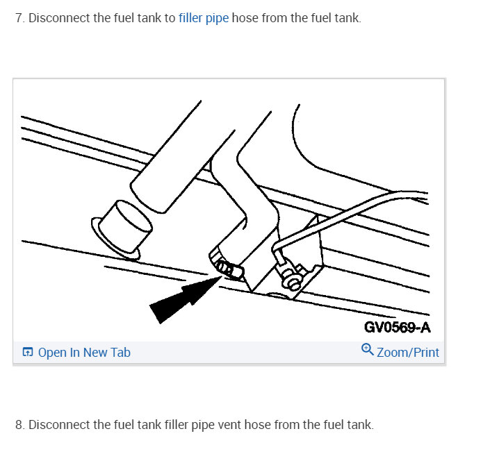

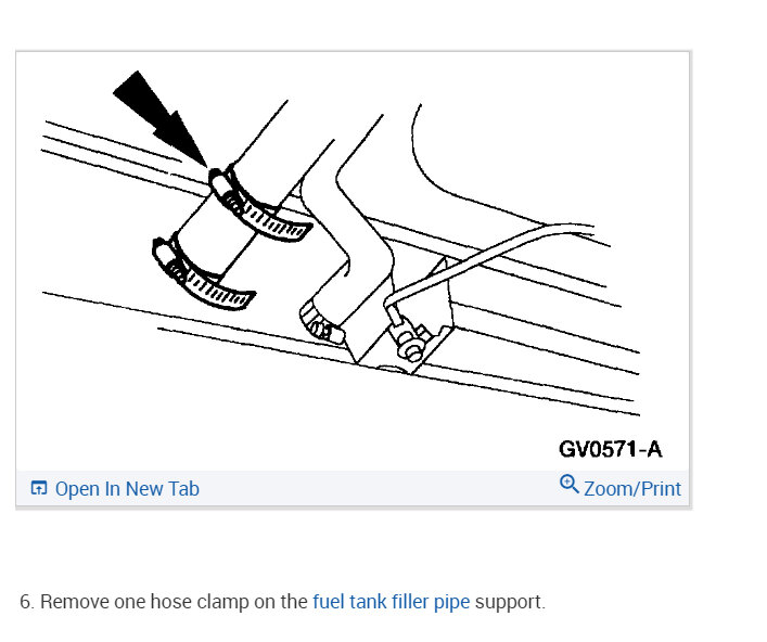

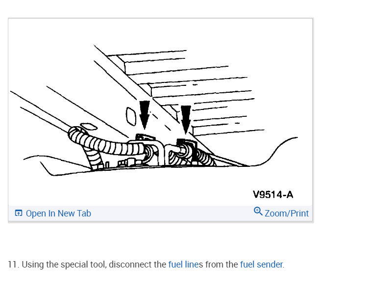

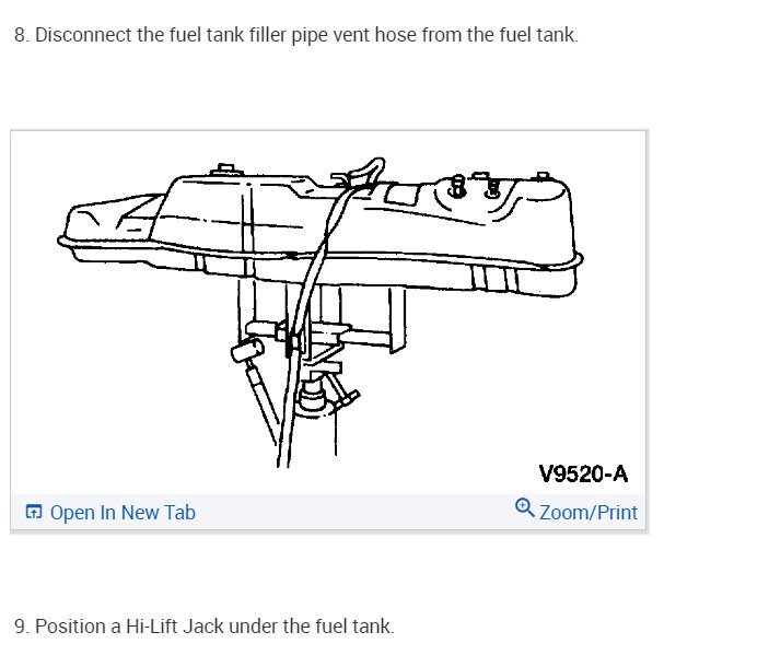

We don't know that information, but I can give you how to replace the fuel pump step by step without cutting a hole in the bed. Here is how to drain the fuel out:
https://youtu.be/Q5MH2gnyFH0
Here is a generic guide to help walk you through the repair with instructions below to show you how on your truck:
https://www.2carpros.com/articles/how-to-replace-an-electric-fuel-pump
This video will show you how to remove the fuel lines:
https://youtu.be/Boi0DPXVHbM
