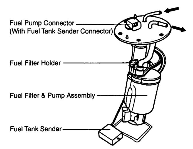

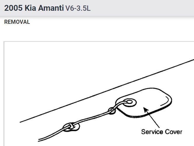

I have the fuel pump, what do I do now?
Dec 7, 2020 at 11:51 PM
DANNY L
  • 5,648 POSTS
Hello again.

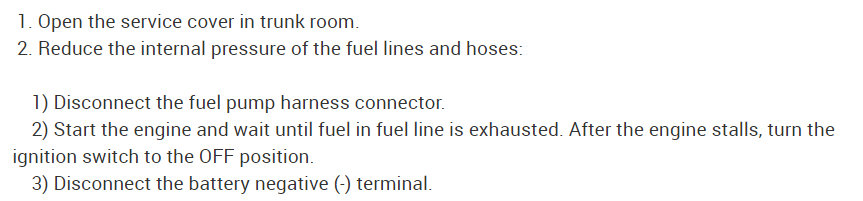

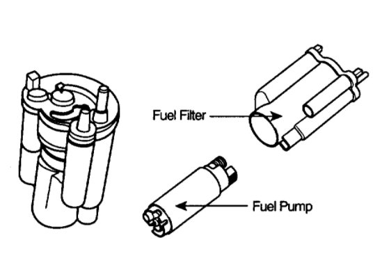

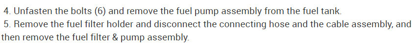

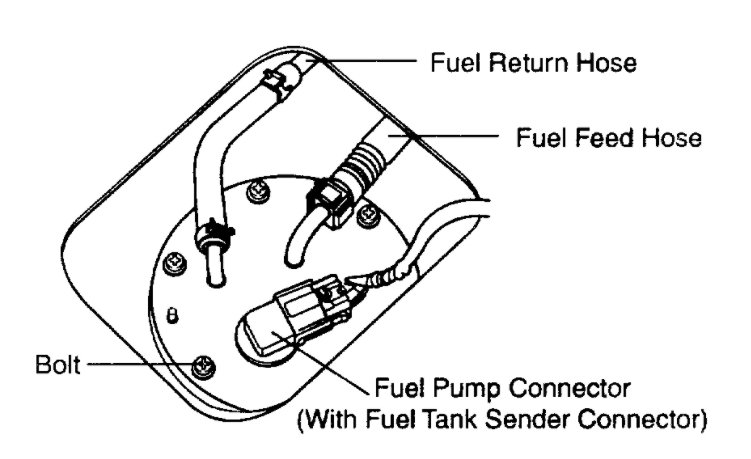

Here is a tutorial for you to view on how to change an in-tank fuel pump:
https://www.2carpros.com/articles/how-to-replace-an-electric-fuel-pump
I've attached picture steps below on the fuel pump replacement for your car. Installation is reverse steps of removal. Hope this helps and thanks again for using 2CarPros.

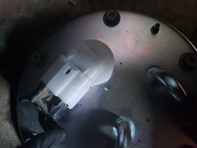

I can't remove the fuel pump connector. I broke a small piece. is there a replacement if I break it?
Dec 9, 2020 at 6:16 AM
DANNY L
  • 5,648 POSTS
Hello again.
Can you use your cell phone to take a picture of the connector and upload it here? That way I will have any idea what it looks like and where to find a replacement. Get back to us and we'll go from there. Hope this helps and thanks again for using 2CarPros.

I uploaded the picture, after replacing the pump and driving the car once it won't start.
Dec 26, 2020 at 4:52 AM
DANNY L
  • 5,648 POSTS
Hello again.
Just to be on the same page you replaced the fuel pump and the car is still not starting? Please advise. Thanks again for using 2CarPros and Happy Holidays.

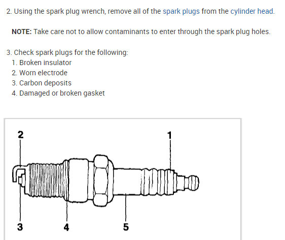

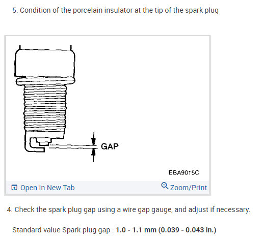

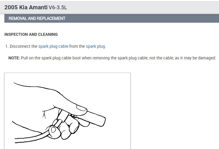

CHANCEDXN
  • 11 POSTS
Any information on changing the spark plugs? I am not sure how to.
Jan 31, 2021 at 6:17 AM
DANNY L
  • 5,648 POSTS
Hello again.

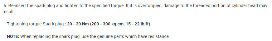

Here is a spark plug replacement tutorial for you to view:
https://www.2carpros.com/articles/how-to-change-spark-plugs
I've attached picture steps below showing spark plug replacement for your vehicle. Keep us updated. Hope this helps and thanks again for using 2CarPros.
