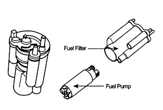

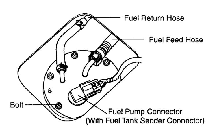

I have the fuel pump, what do I do now?
Dec 8, 2020 at 7:51 AM
DANNY L
  • 5,648 POSTS
Hello again.

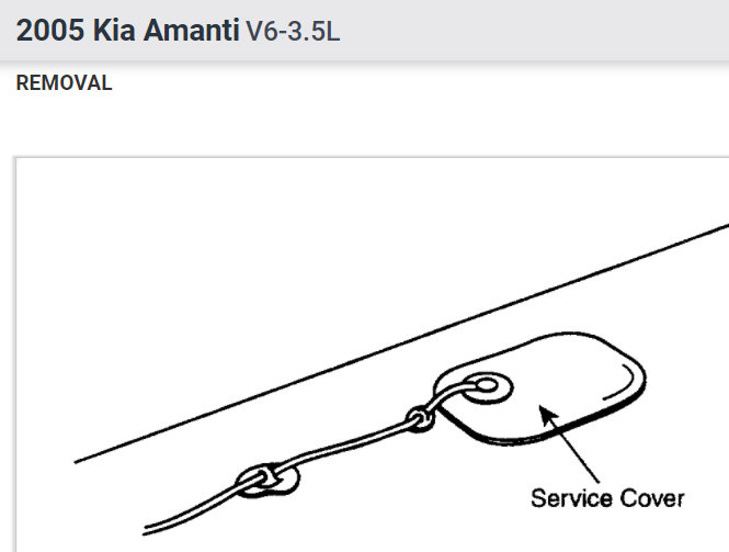

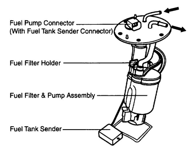

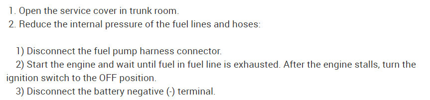

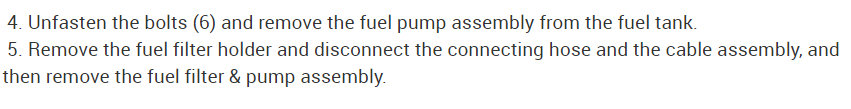

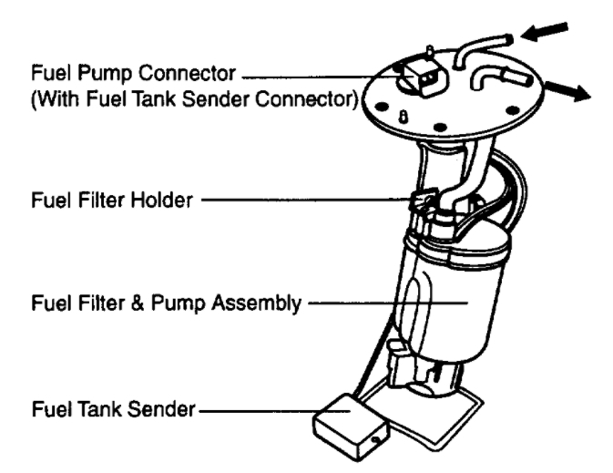

Here is a tutorial for you to view on how to change an in-tank fuel pump:
https://www.2carpros.com/articles/how-to-replace-an-electric-fuel-pump

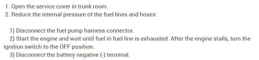

I've attached picture steps below on the fuel pump replacement for your car. Installation is reverse steps of removal. Hope this helps and thanks again for using 2CarPros.

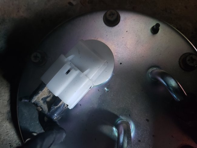

I can't remove the fuel pump connector. I broke a small piece. is there a replacement if I break it?
Dec 9, 2020 at 2:16 PM
DANNY L
  • 5,648 POSTS
Hello again.
Can you use your cell phone to take a picture of the connector and upload it here? That way I will have any idea what it looks like and where to find a replacement. Get back to us and we'll go from there. Hope this helps and thanks again for using 2CarPros.

I uploaded the picture, after replacing the pump and driving the car once it won't start.

Yes, I followed the instructions, the only problem was the breakage of the clip. I drove it to work and back and have been unable to get it to start since.
Dec 27, 2020 at 11:23 AM
DANNY L
  • 5,648 POSTS
Hello again.
So with the broken clip does the harness keep unplugging causing the fuel pump to not work, car not start?
Danny-
Dec 27, 2020 at 12:01 PM
CHANCEDXN
  • 11 POSTS
I don't think that is the problem, it seems fine.

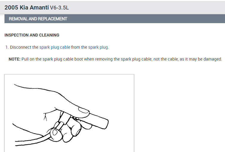

Okay, next step is to pull the spark plugs individually and see if you're getting spark to the cylinders. Crank the engine over with the spark plug connected to the spark plug wire while not mounted in the cylinder head to see if its getting spark. Here is a tutorial showing cranking-no start theory:
Let us know what you find. Hope this helps and thanks again for using 2CarPros. Happy Holidays.
Danny-
Dec 31, 2020 at 7:20 PM
CHANCEDXN
  • 11 POSTS

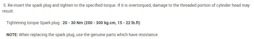

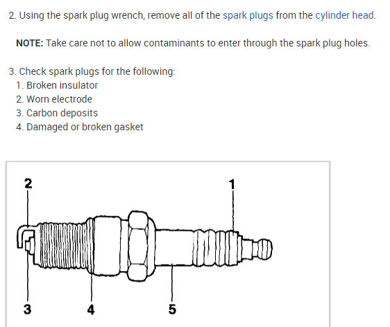

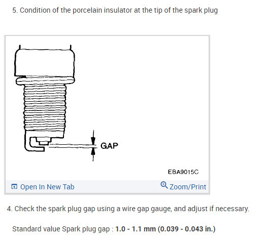

Any information on changing the spark plugs? I am not sure how to.
Jan 31, 2021 at 2:17 PM
DANNY L
  • 5,648 POSTS
Hello again.

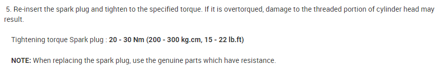

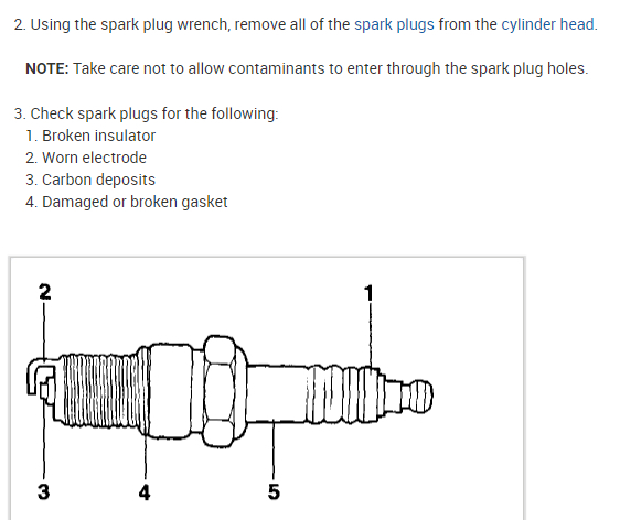

Here is a spark plug replacement tutorial for you to view:
https://www.2carpros.com/articles/how-to-change-spark-plugs
I've attached picture steps below showing spark plug replacement for your vehicle. Keep us updated. Hope this helps and thanks again for using 2CarPros.
