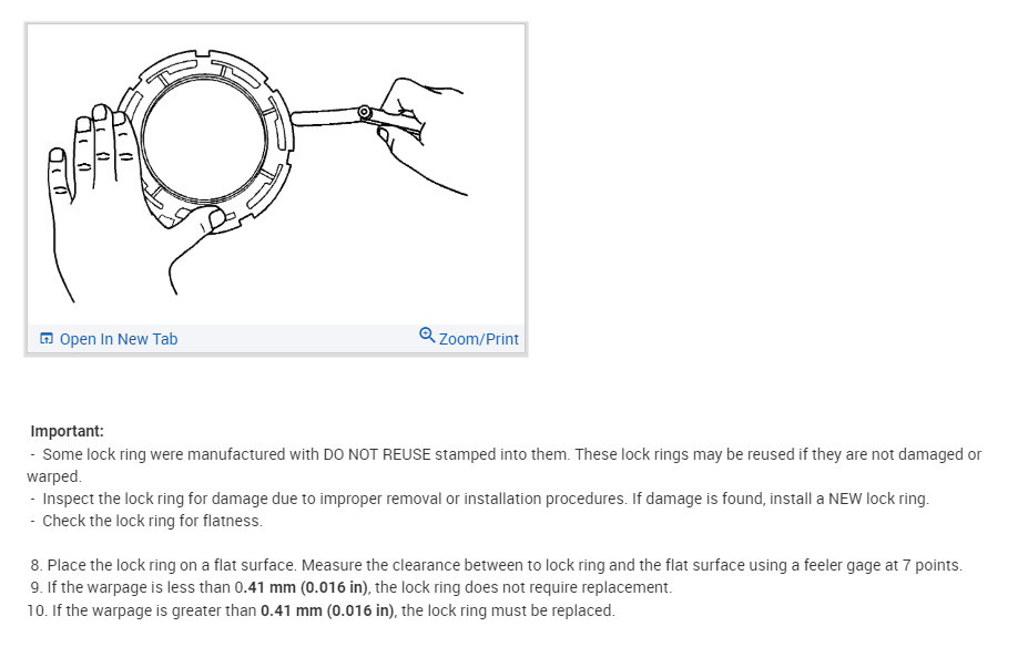

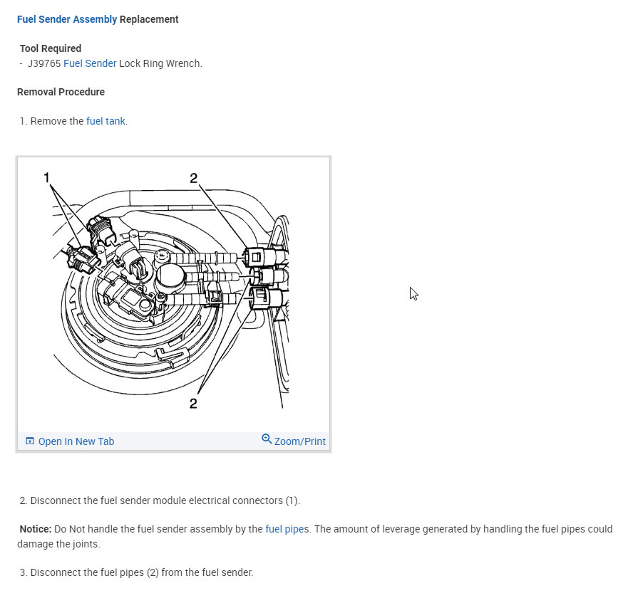

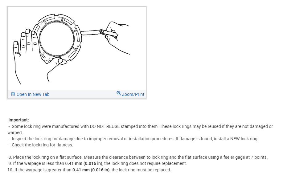

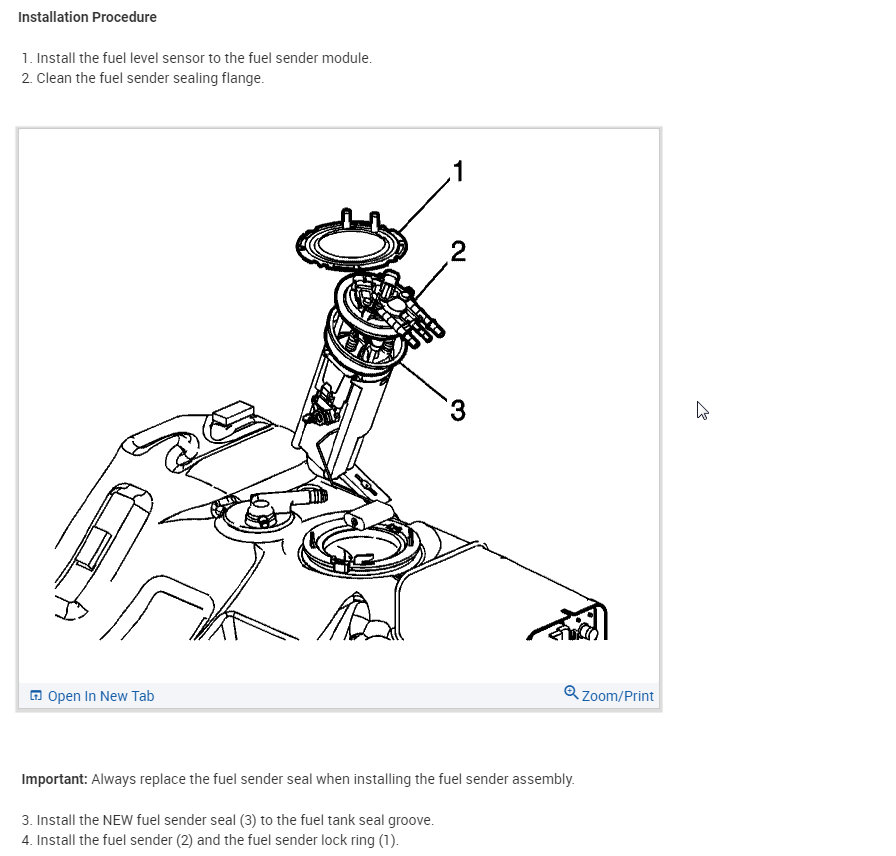

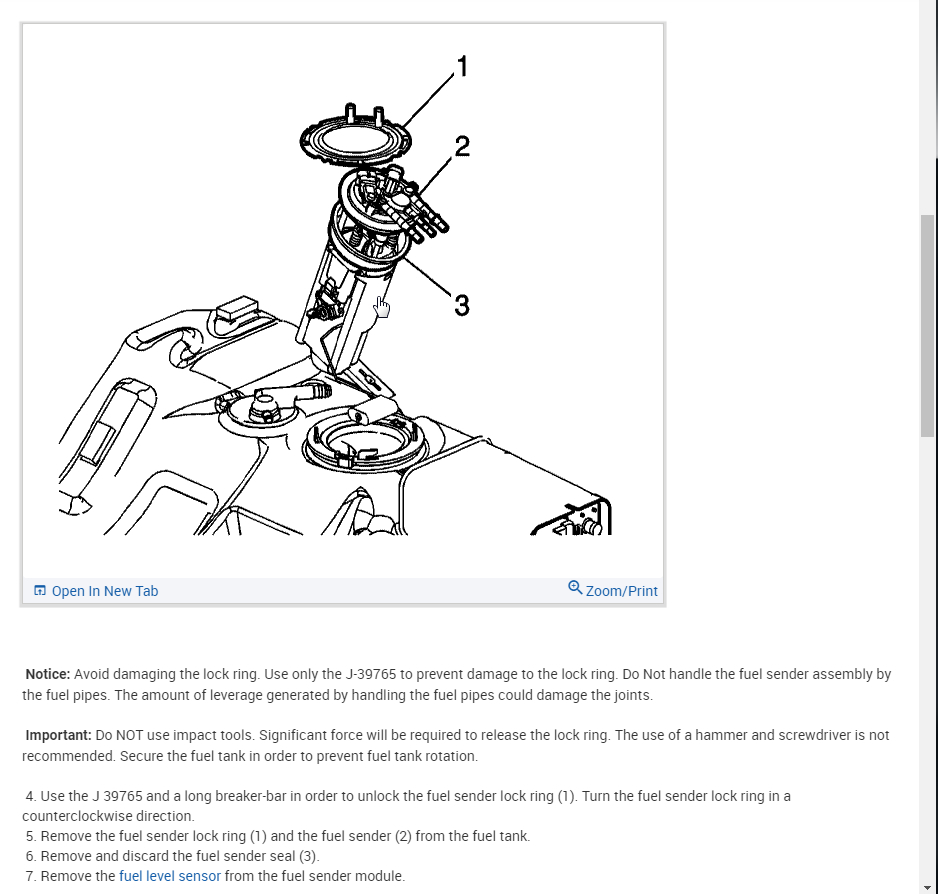

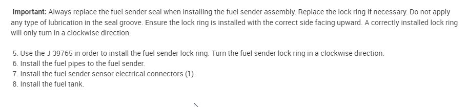

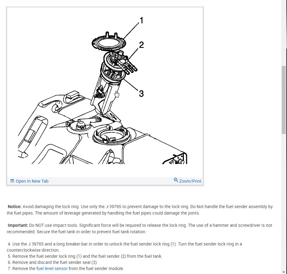

Hello, i am looking for the procedure for the fuel pump replacement.
Oct 27, 2019 at 12:07 PM
I attached the procedure. Please let me know if you have more questions. Thanks

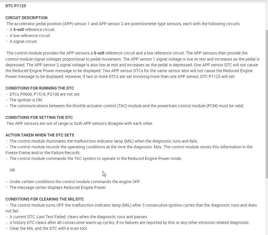

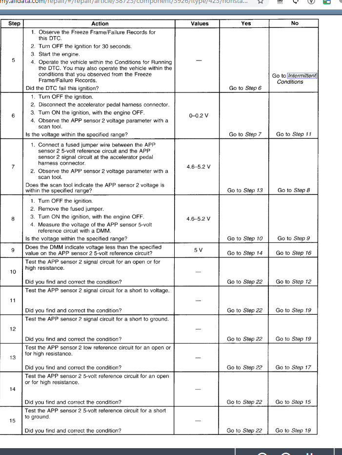

I have a question, will a bad throttle body cause a car to crank but not start?
Mar 20, 2021 at 12:29 PM
ALEXTTT
  • 59 POSTS

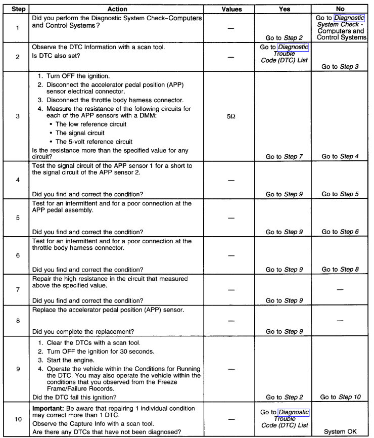

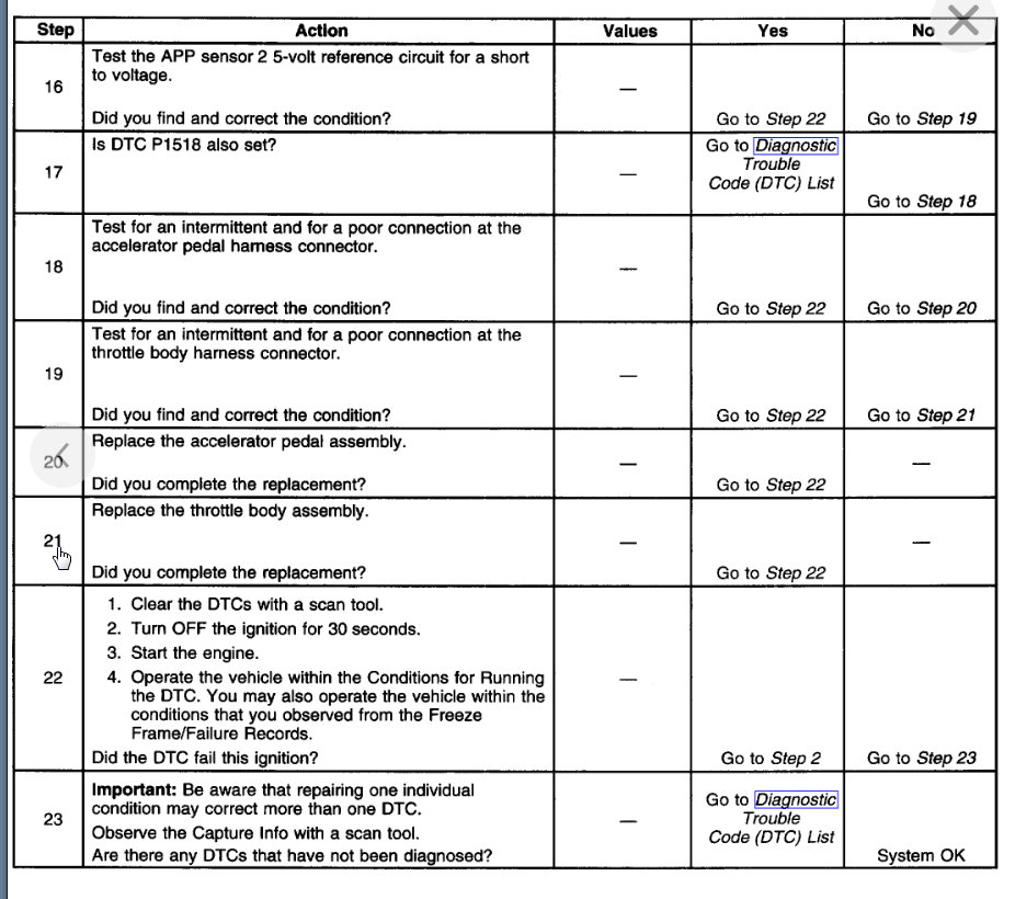

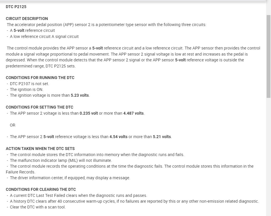

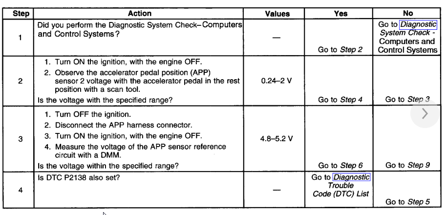

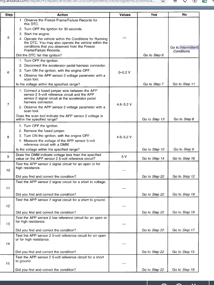

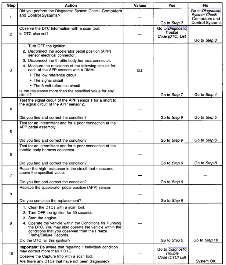

I have a check engine light referring to the throttle body and gas pedal. I have codes P1125, P2125, P2138.
No. These codes are for the as you stated, APP 1 and 2 and they will not cause a no start. I attached the diagram for them in case you need that as well. Thanks
