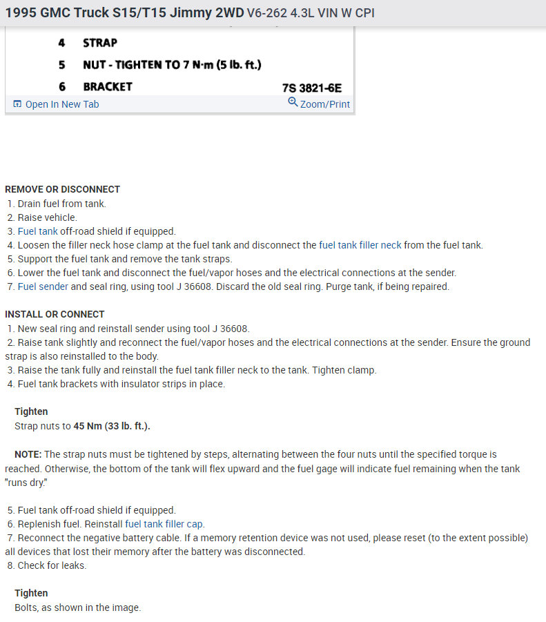

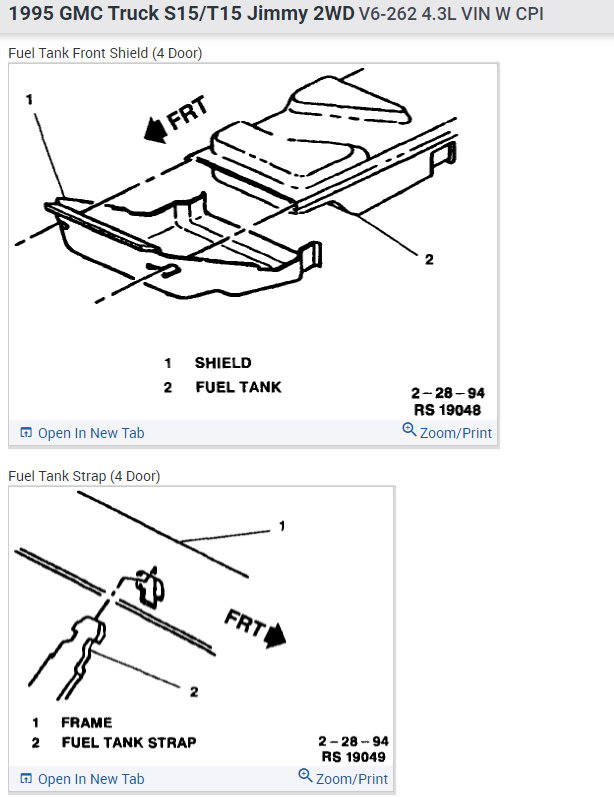

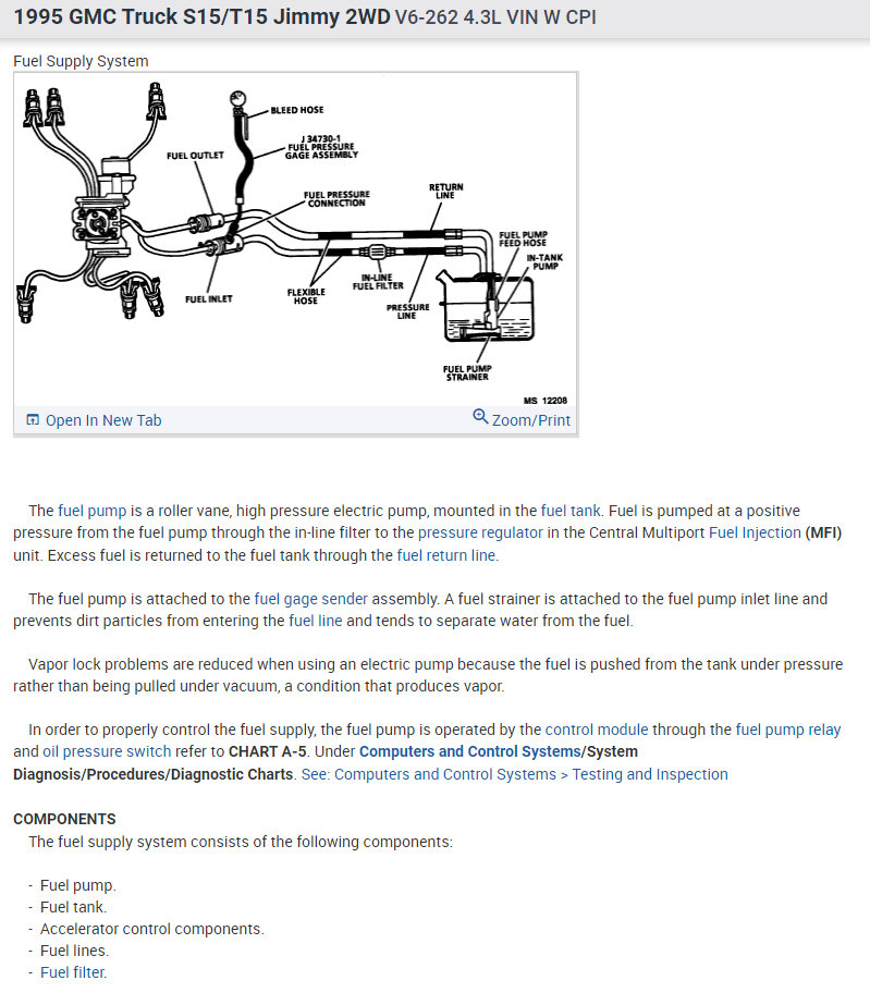

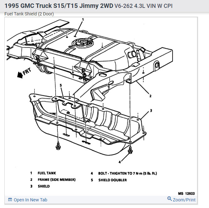

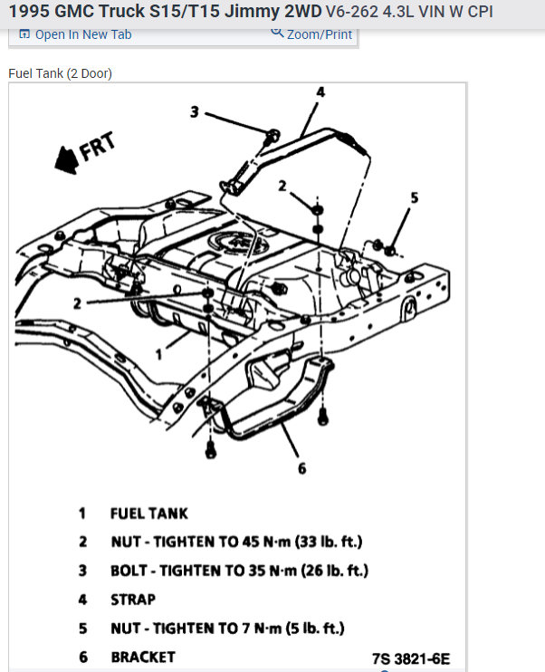

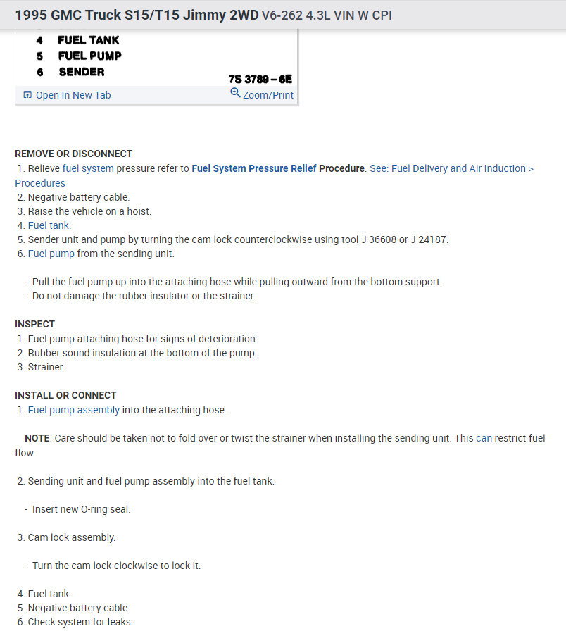

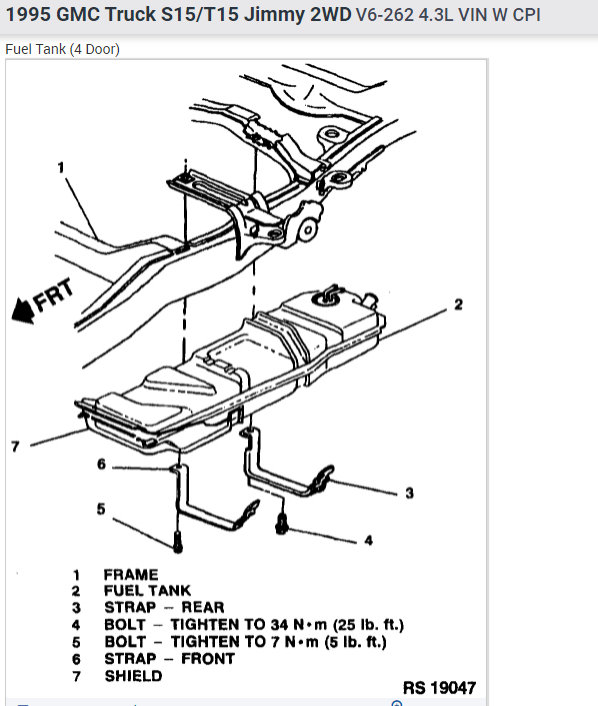

Do you have to drop the tank to replace the fuel pump?
Sep 25, 2021 at 6:18 AM
SQM
  • 6,383 POSTS

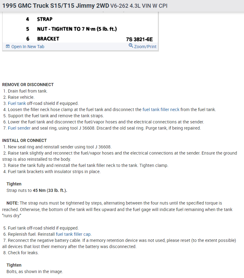

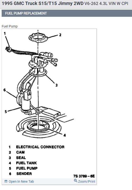

On this vehicle you will have to drop the fuel tank to replace the fuel pump.
Keep in mind that it is easier to do this task with the fuel tank empty/near empty.
https://www.2carpros.com/articles/how-a-fuel-pump-works
https://www.2carpros.com/articles/how-to-replace-an-electric-fuel-pump

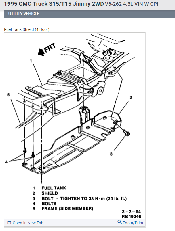

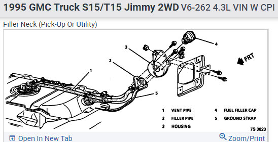

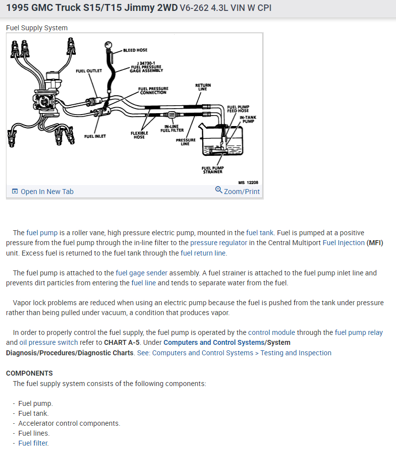

I have attached the fuel pump procedure as well as the fuel tank removal procedure for your reference.
