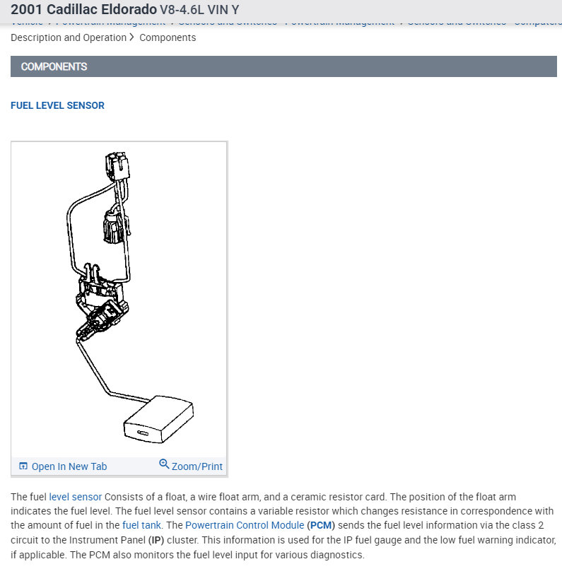

After replacing the fuel pump, the fuel gauge stopped working
91,000 MILES • V8 • 2WD • AUTOMATIC
OBRADLEY73
Fuel Gauge not working properly after replacing fuel pump.
May 20, 2022 at 3:03 AM
SQM
  • 6,383 POSTS

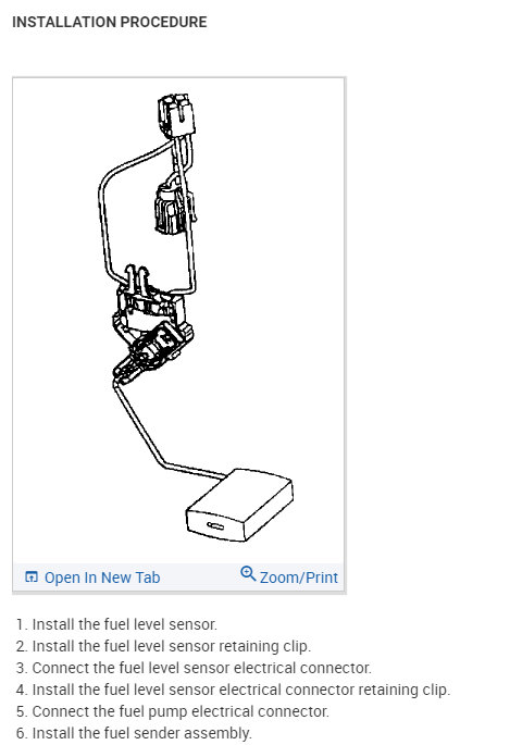

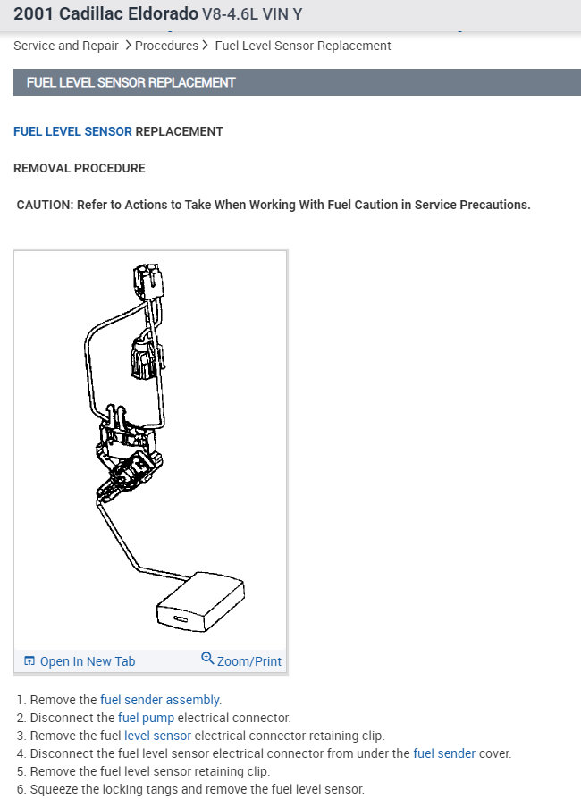

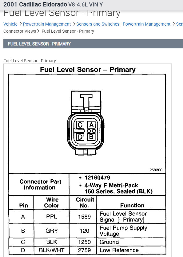

Did the new pump come with a fuel level sending unit?
It could be due to a faulty sending unit on the new pump or there is a loose connection for the sending unit.
Is the pump working properly?
Did you have this issue before the pump replacement?
