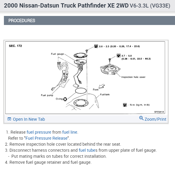

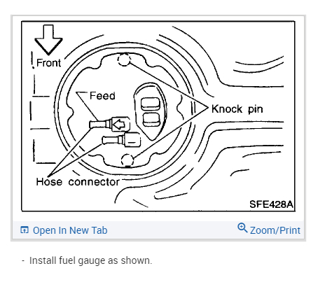

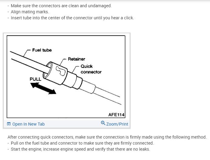

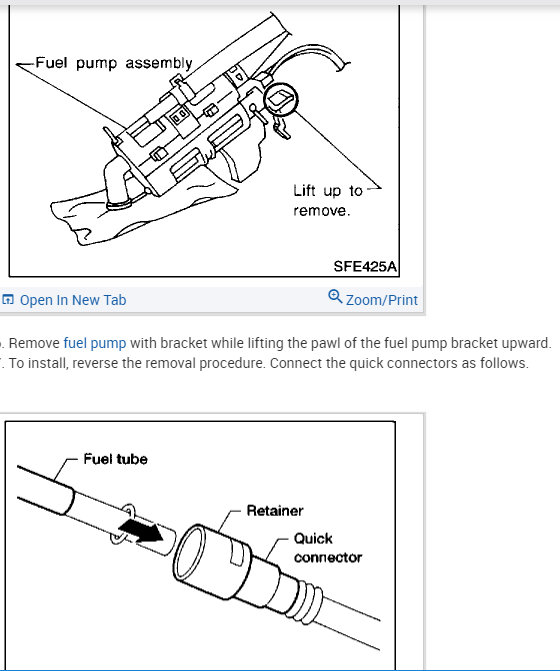

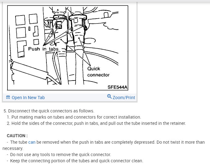

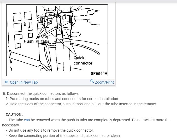

Hello, I'm planning to replace the fuel pump and I was looking for a detailed walkthrough on replacing it.
Jun 6, 2019 at 9:09 AM
DANNY L
  • 5,648 POSTS
Hello, I'm Danny.
Here is a tutorial to get you started on how to replace the in-tank fuel pump:
https://www.2carpros.com/articles/how-to-replace-an-electric-fuel-pump
I've attached a series of step-by-step pictures below.Hope this helps and thanks for using 2CarPros.

How to I attach the fuel pump to the plastic bracket in the bottom of the fuel tank?

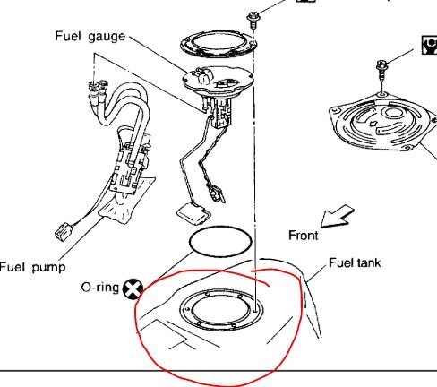

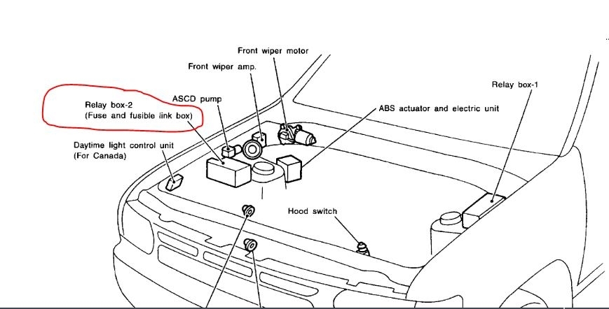

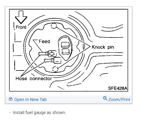

So, I replaced the fuel pump and I lost six screws for the fuel pump cover. So I drove it for about fifteen minutes and now it wont start, just tries to turn over but nothing. Since I only had three of six screws installed would that cause air to go into the fuel lines? And the rubber gasket that's right under the fuel pump isn't seated right.
Jun 21, 2019 at 4:23 AM (Merged)
  • 110,240 POSTS
Welcome to 2CarPros.
Air has to get into the tank to allow fuel to be removed, so I don't think that is the issue and unless the pump is lifted above the fuel level, air in the lines shouldn't be a factor. I attached a picture and circled the part I believe you are referring to (see Pic 3). If that is correct, my biggest concern would be that fuel could leak from the o-ring where it mounts. However, that wouldn't cause it not to work.

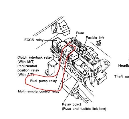

Have you confirmed that all connections (both electrical and fuel lines) are secure? Are you smelling any fuel indicating a possible leak? Can you hear the pump turn on for a couple seconds when you first turn the key to the on position?
If you don't hear the pump and everything is connected properly, check under the hood in the fuse / relay box 2 (see pic 1) if there is an issue with the fuel pump relay or fuse (see Pic 2). If there are other relays with the same part number, switch them to see if that makes a difference.

I tried to hear the pump turn on, but i do not hear anything.

Here is the picture of the relay fuse in the blue:
ALEX19899
  • 171 POSTS
Will a test light work to check the relay?
Jun 21, 2019 at 4:55 AM
ALEX19899
  • 171 POSTS
I replaced the fuel pump relay and still no power......
