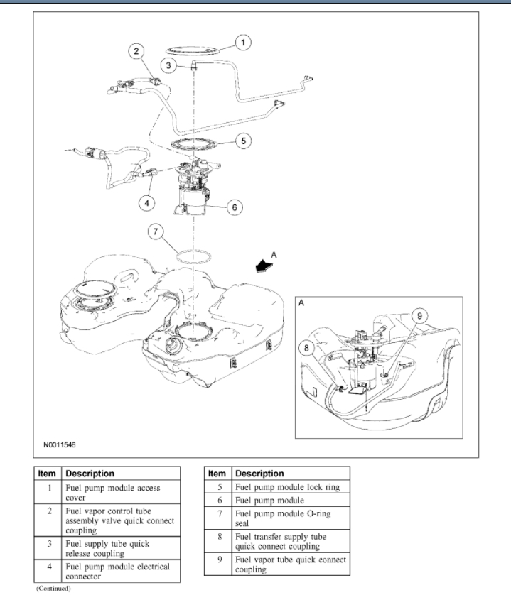

Hi, I need to replace the fuel pump. Do I have to drop the fuel tank or can I access it via an inspection plate inside the car?
Thanks, Mark
Aug 22, 2017 at 9:09 AM

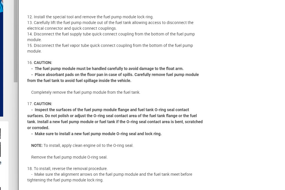

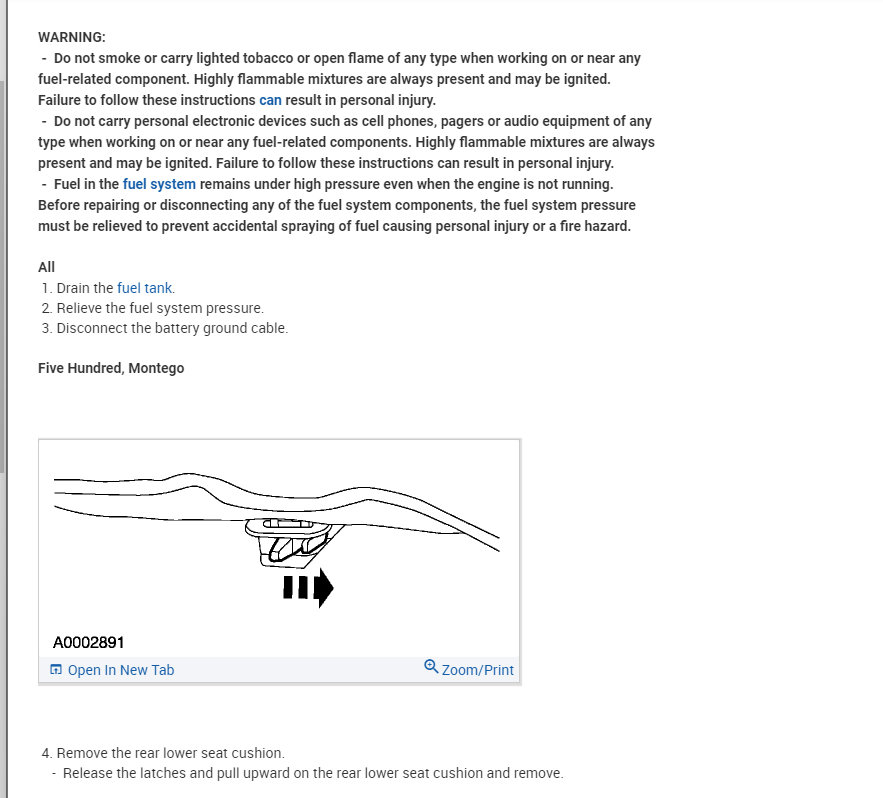

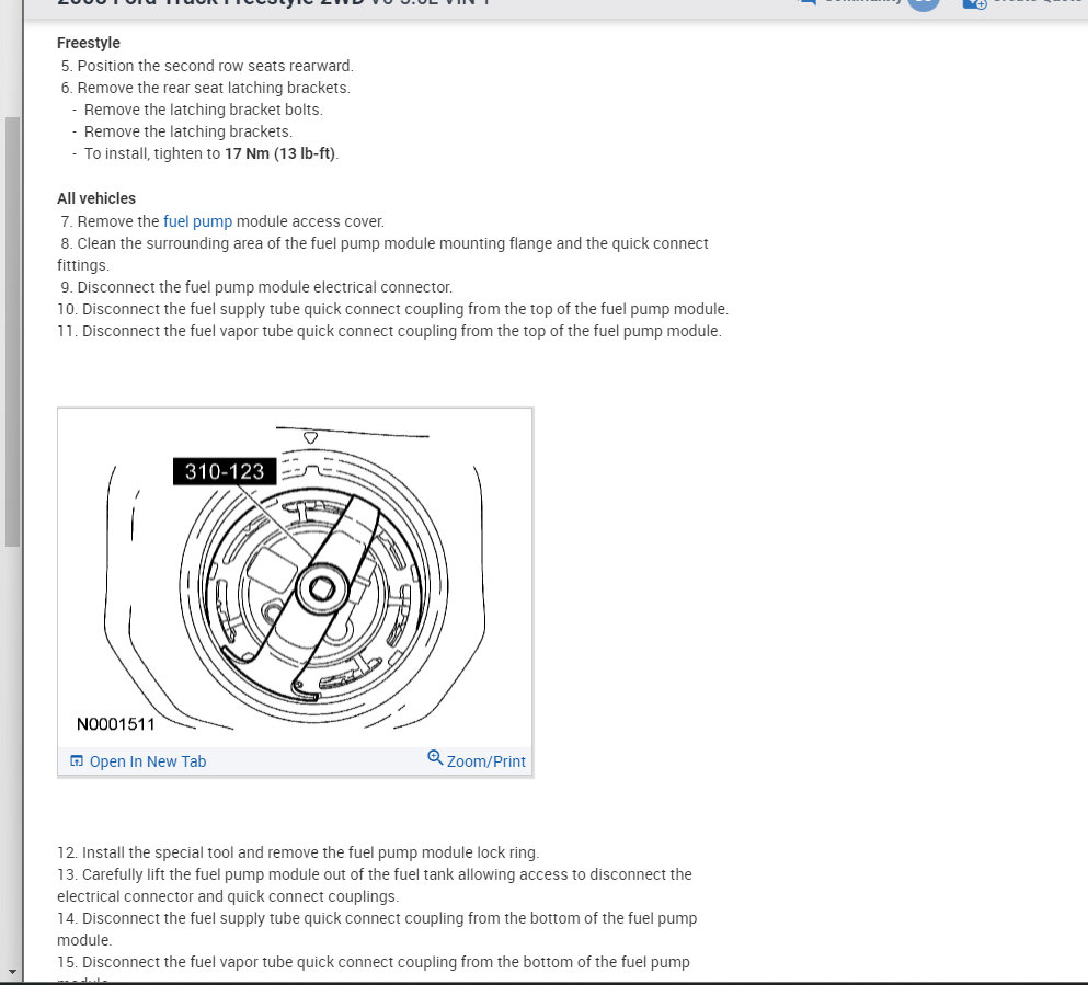

We don't have a manual on this vehicle, so I am not positive, but this vehicle is basically a Freestyle, so I am attaching the process for this one.
However, from what I can tell, there may not be an access panel like there is on the Freestyle so here is a guide that will help with removing the fuel pump:
https://www.2carpros.com/articles/how-to-replace-an-electric-fuel-pump
Basically, we need to remove the rear seat to make sure this is the same so please run through this info and let us know what you find because conformation that this is the same would really help.
