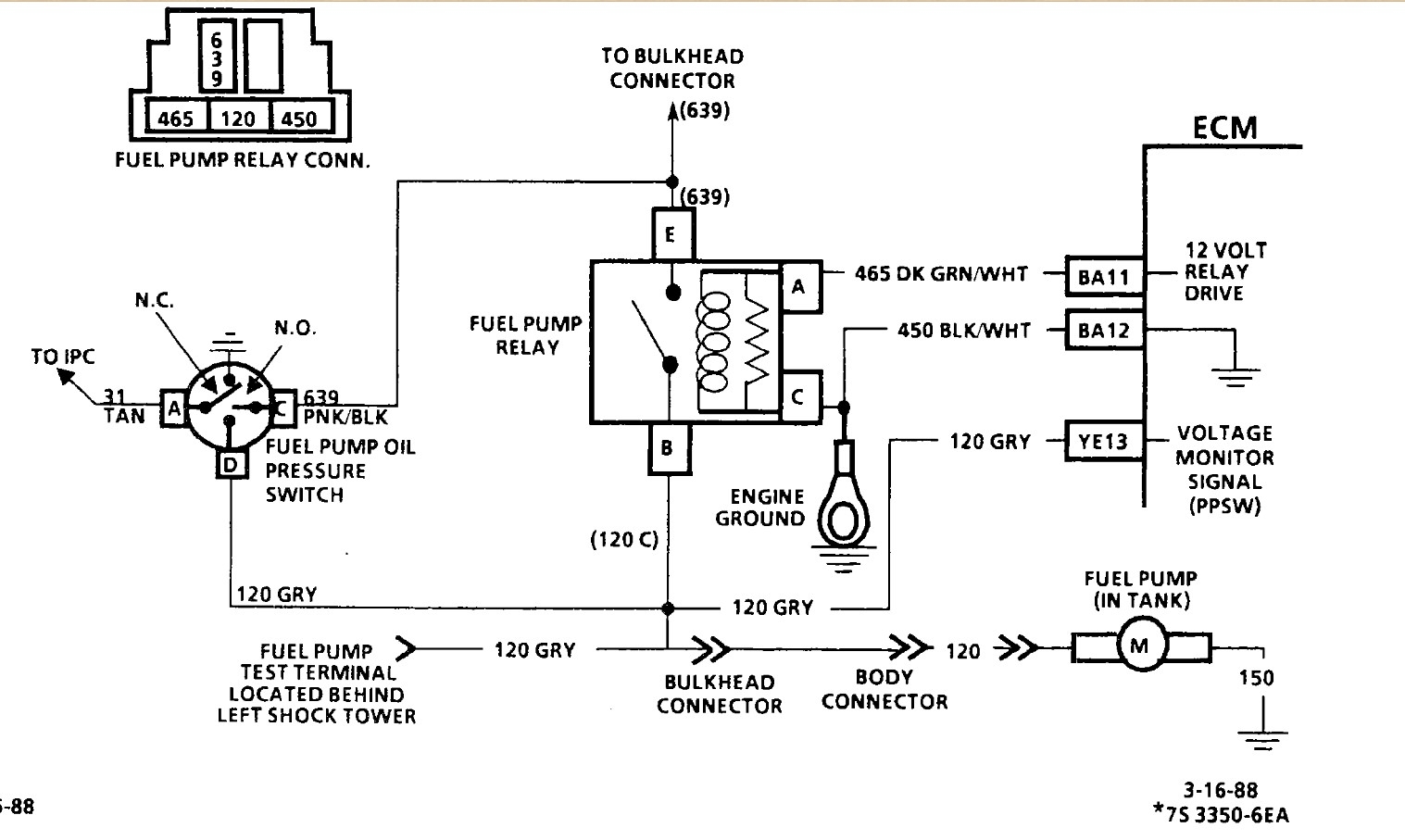

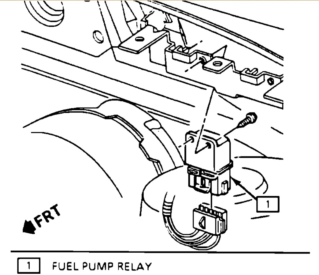

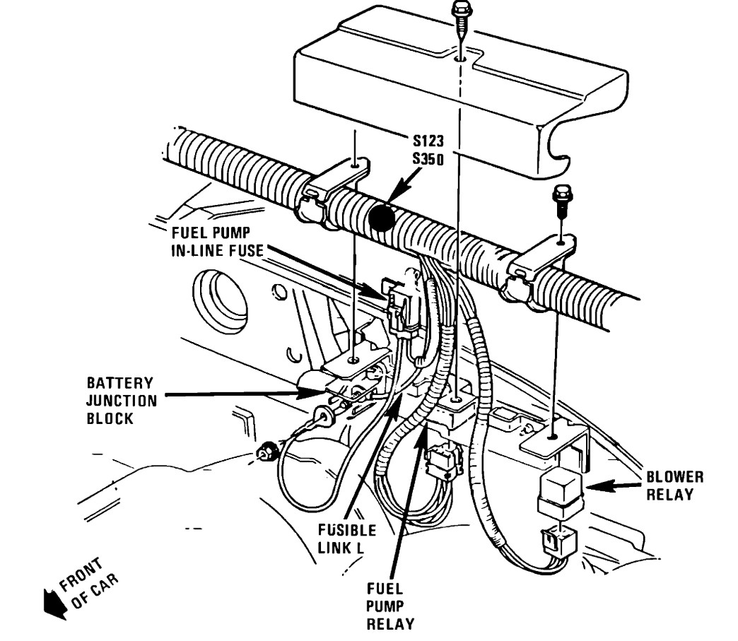

Where is the location of the fuel pump relay on a chevrolet cavalier z24 1989.
Sep 11, 2025 at 10:07 AM
STEVE W.
Experienced Mechanic
15,397 POSTS
It is on the back of the bracket on the firewall near the strut tower and the brake booster.
