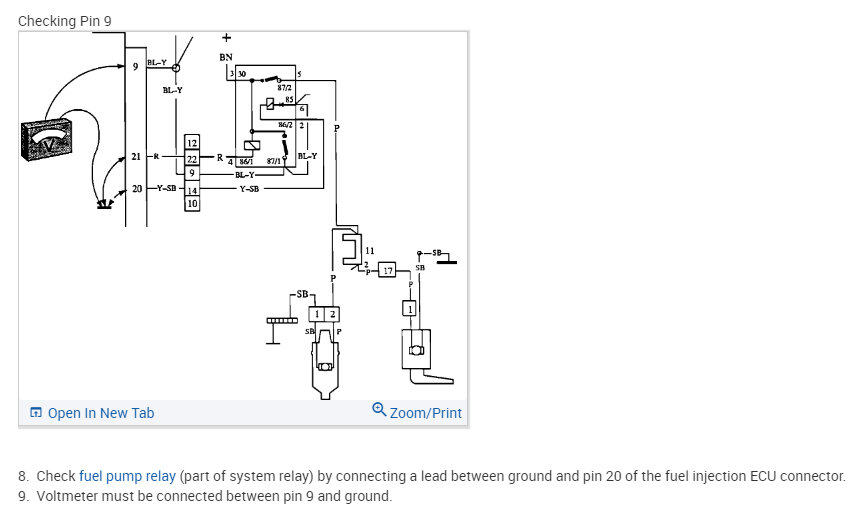

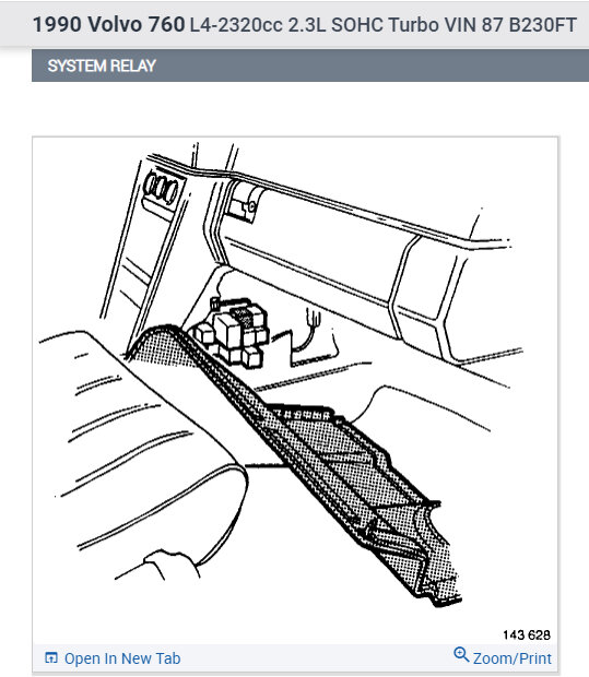

The system relay (located in the center console behind the ashtray) is a combined function relay. It combines the fuel pump and fuel injection relay into one unit.
As far as removal, they are clipped in place. See pic 1 below. Take a small flat screwdriver and gently open the clip to release it from the holding pin.

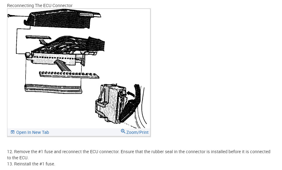

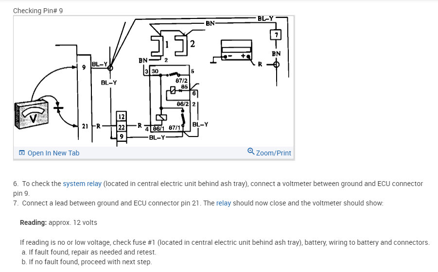

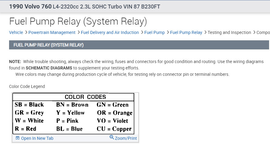

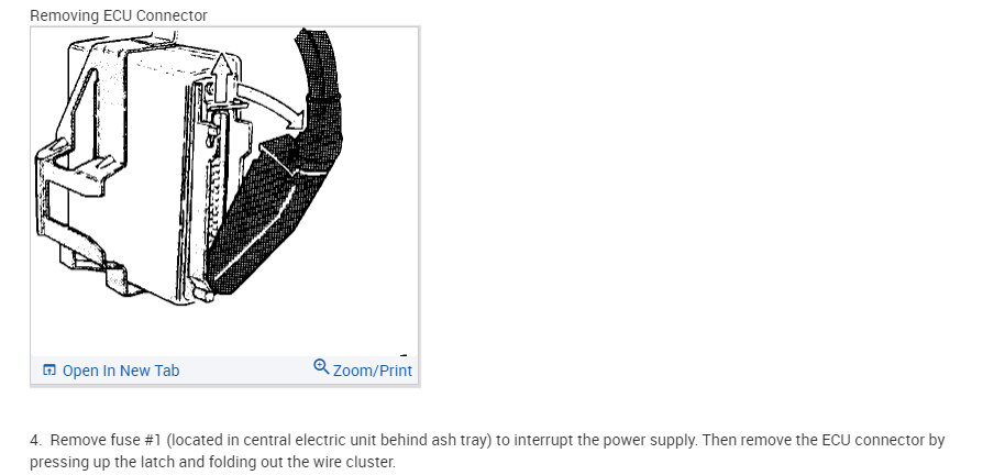

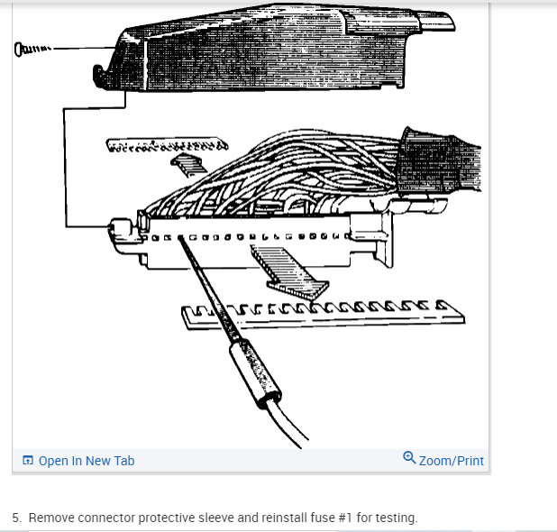

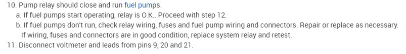

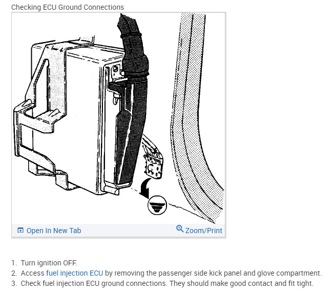

The remaining pics are the diagnostics for the fuel pump relay circuit. I don't know if you needed them but thought I would add them.
Let me know if this helps.

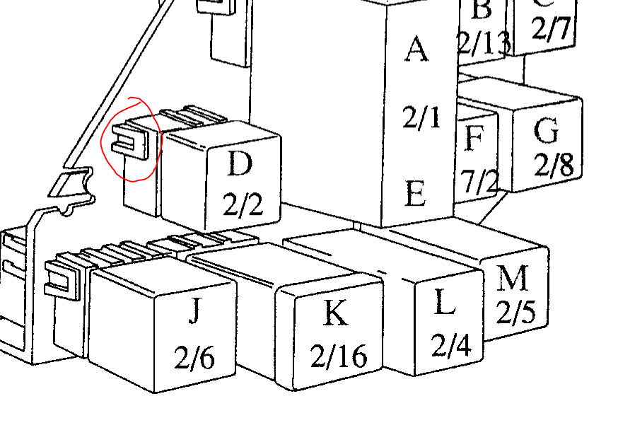

Hi Joe, thank you for your speedy reply, and merry Christmas to you! I appreciate your answer, but your diagram and instructions refer to the Volvo 740, 940 some of the 760s (before 1988). The 760 turbos from 1988 and later had a different configuration, with the relays packed together on the main electrical board on the left side of the passenger compartment, between the passenger's feet and the ash tray area that was used on earlier models (see my photo, which shows the earlier configuration on the left and the new configuration for the 1988 and later 760s on the right).
While I used to have a 1988 740 non-turbo and was able to remove the fuel pump relay easily in that car, I haven't been able to remove the fuel pump relay from my 1990 760T, despite trying to pull it out as hard as I could (it's hard to even get a grip on it because it's adjacent to other relays on three sides and there's nothing to hook onto on the top side). As I noted in my original question, my Haynes manual says most of these relays, including the fuel pump relay marked with the "B", are "permanently attached to the board".
I'm guessing that I have to remove the circuit board the relays are mounted on, though I'm unsure how to do that. If I get that out, it might be obvious how to take the relay off the board. That might mean melting the solder, if that's how the relays were "permanently attached".
If you have a suggestion on how to remove either the relay itself, or the whole main electrical board so I can get at the relay, I would be very appreciative.

Joe, thank you also for the instructions on testing the ECU. I'd like to check the other components that go out more frequently before I have to try getting to the ECU, since that's less likely to be the problem than several of the other components.

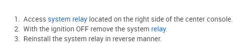

The information I provided is the only thing I am able to find. I checked through two professional manuals that both provided the same info.
If you look below, that is what I have for the removal of the fuel pump/system relay. They are very basic.
