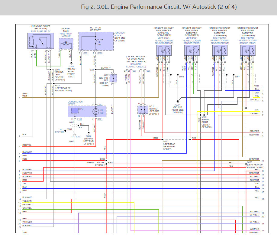

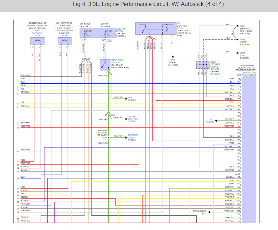

Every time I try and switch out my fuel pump relay to try another one it starts making a rapid quick noise. Can anyone tell me why, please?
Aug 17, 2022 at 12:49 PM
  • 55,849 POSTS

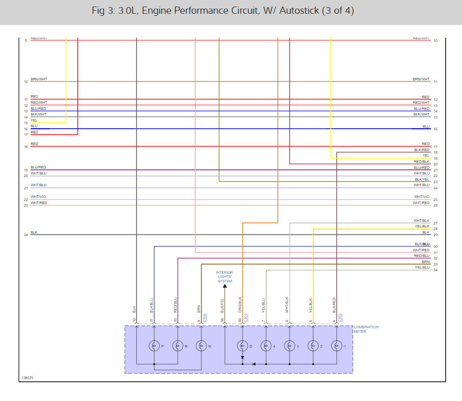

It will do this if the fuel pump is pulling too many amps or the there is a bad connection. Here is a guide to help you check and the wiring diagrams so you can see how the relay works and how it is wired:
Check out the diagrams (below). Please let us know what happens. If everything checks out replace the fuel pump.
