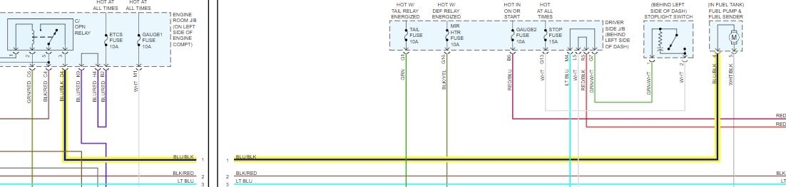

I'm trying to locate the color of wire that runs always hot from the fuel pump relay so I can install a kill switch.

I attached a picture of the power supply to the pump from the relay. Let me know if that is what you needed. I highlighted the wire. It is blue/black.

That wasn't the right one. I think maybe I'm looking in the wrong area. is there somewhere under the dash or does the color change?

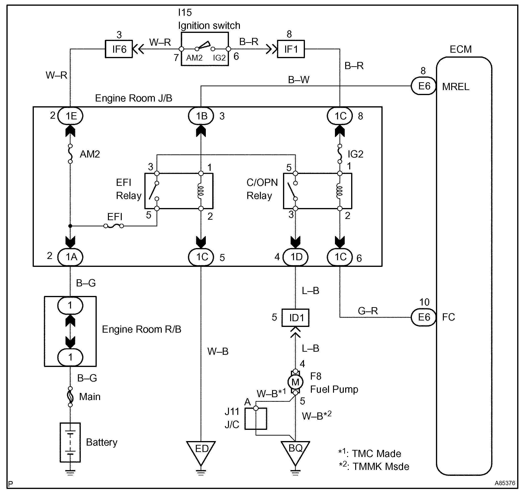

No problem. I attached a schematic of the fuel pump system. This is the OEM schematic, so no colors are listed. However, if you identify which wire you are looking for, I will try to identify color via a different manual.
