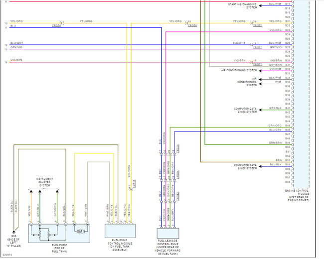

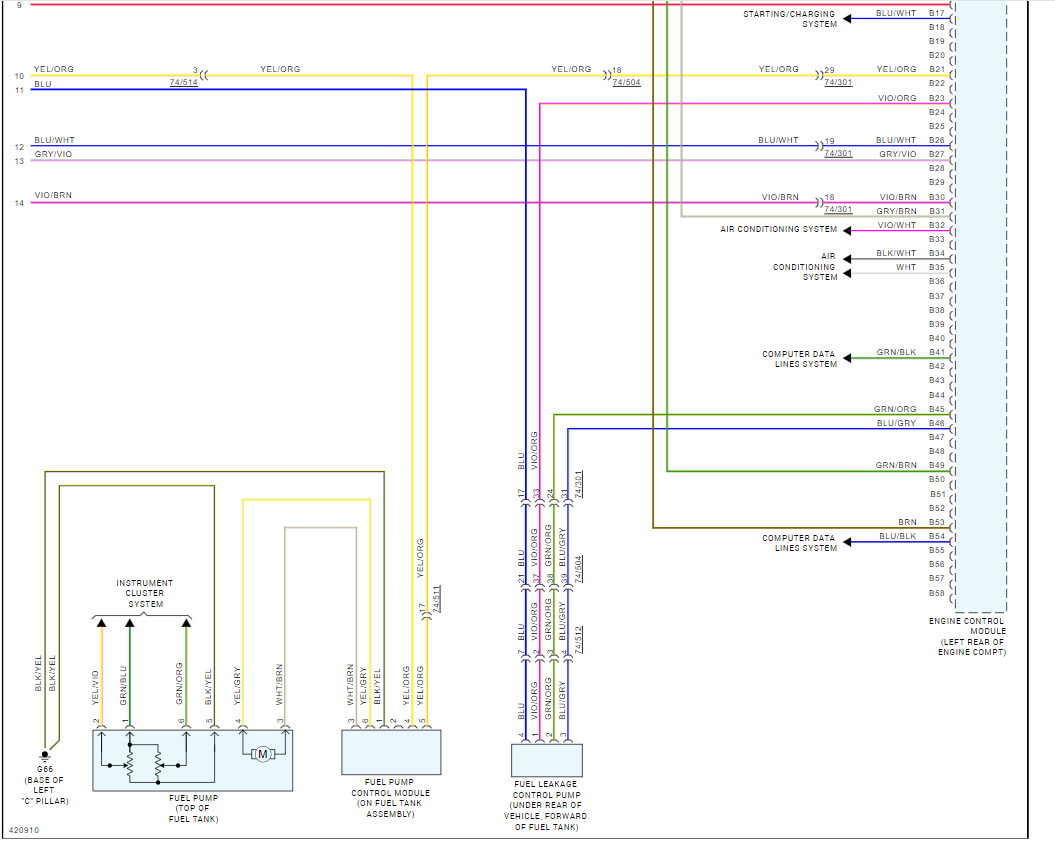

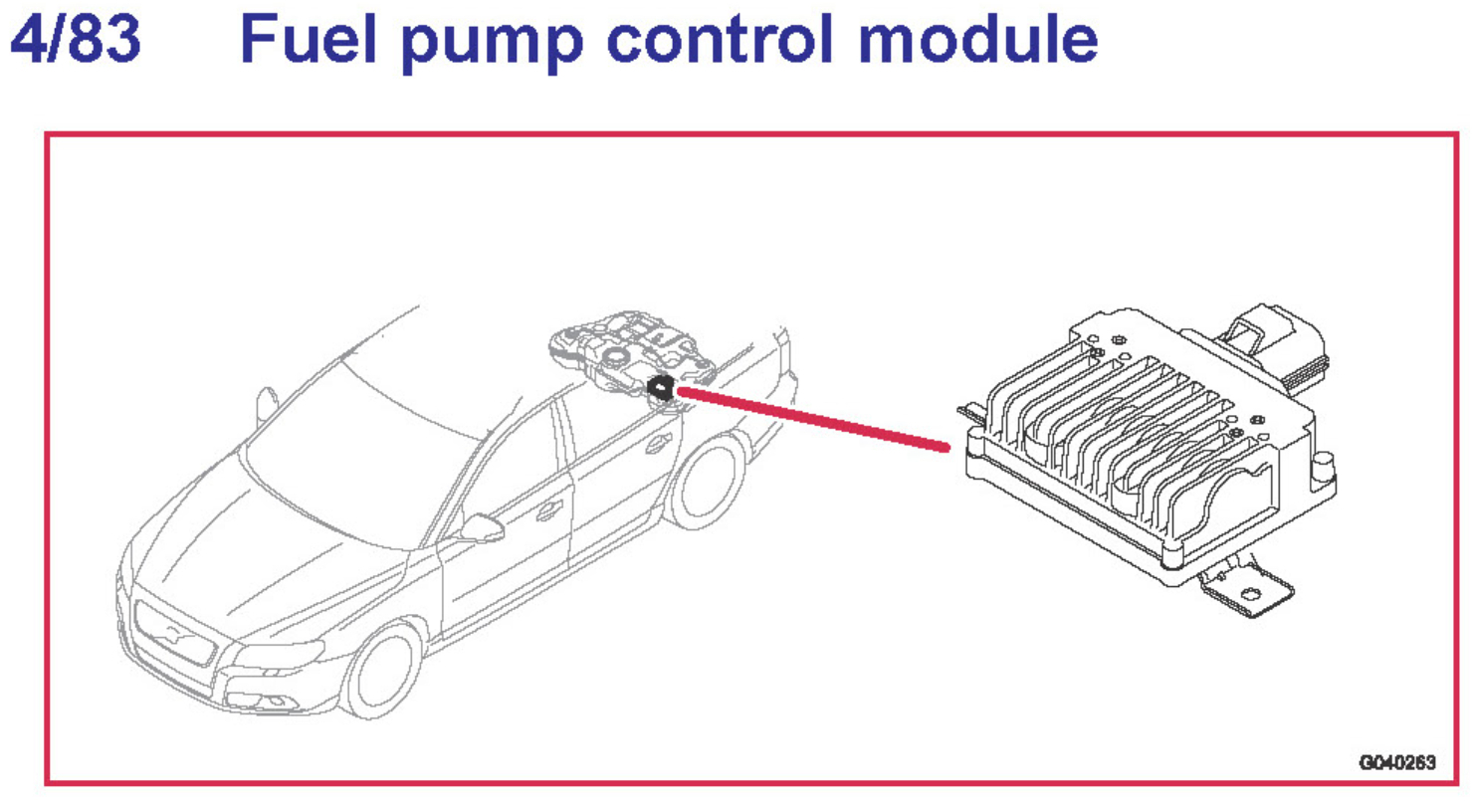

I have a crank no start problem with my vehicle, and I cannot find the module or the fuel pump relay to troubleshoot everything.
Sep 4, 2024 at 10:44 AM
  • 55,402 POSTS
It says the fuel pump control module is on top of the fuel tank, here is the location and I have included a short video that can help along with the fuel pump wiring diagrams so you can see how the system works.
https://youtu.be/lXLJbuAZ4CE?si=kKe1-pWQ7lf6ZpB5
Check out the images (below). Please upload pictures or videos in your response of any problems so we can see what to help you with.
