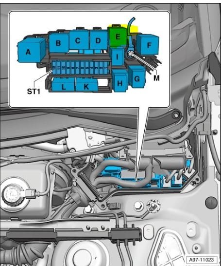

I attached and highlighted the fuel pump relay for you in the attached picture. Let me know if that helps.

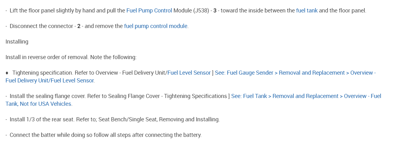

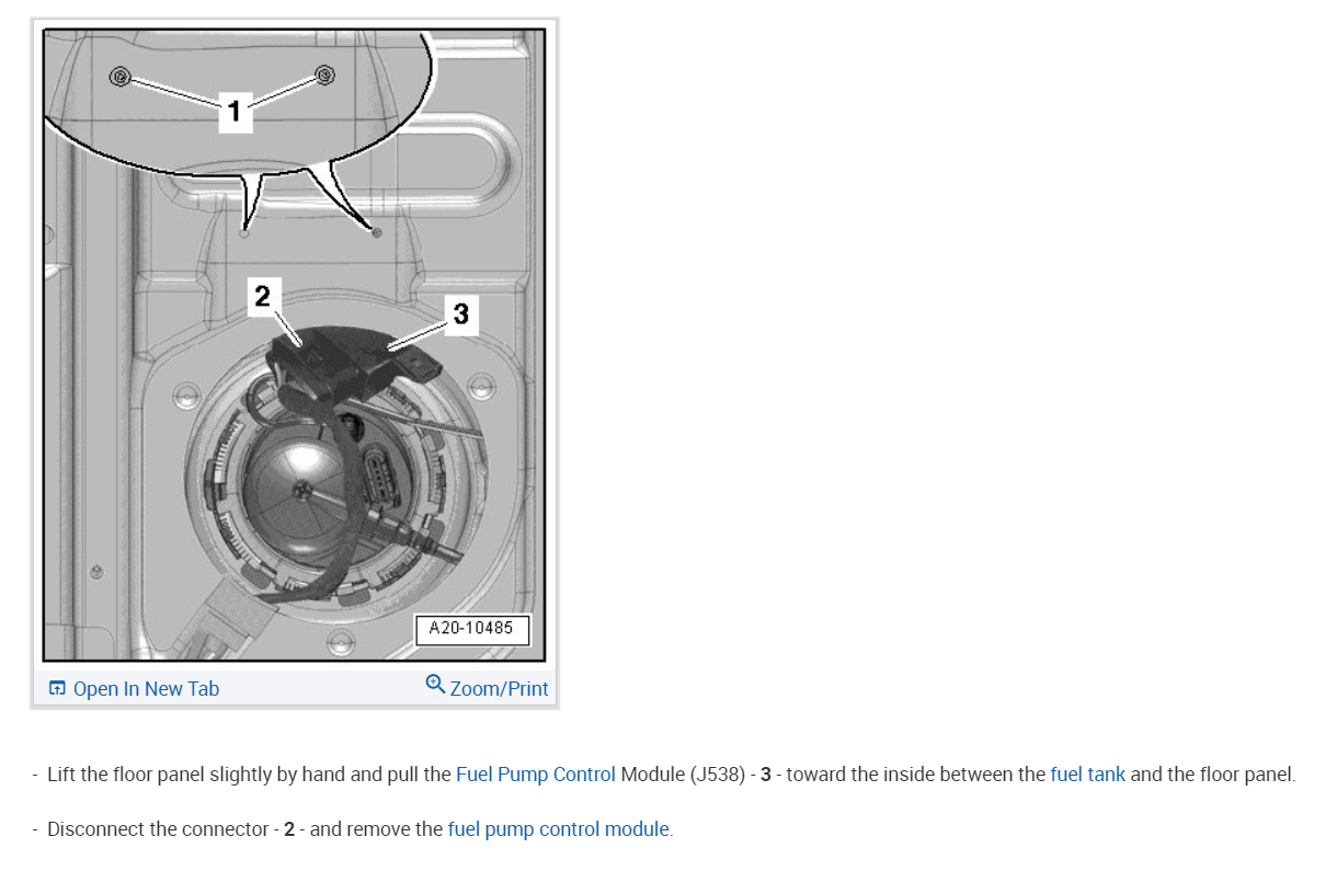

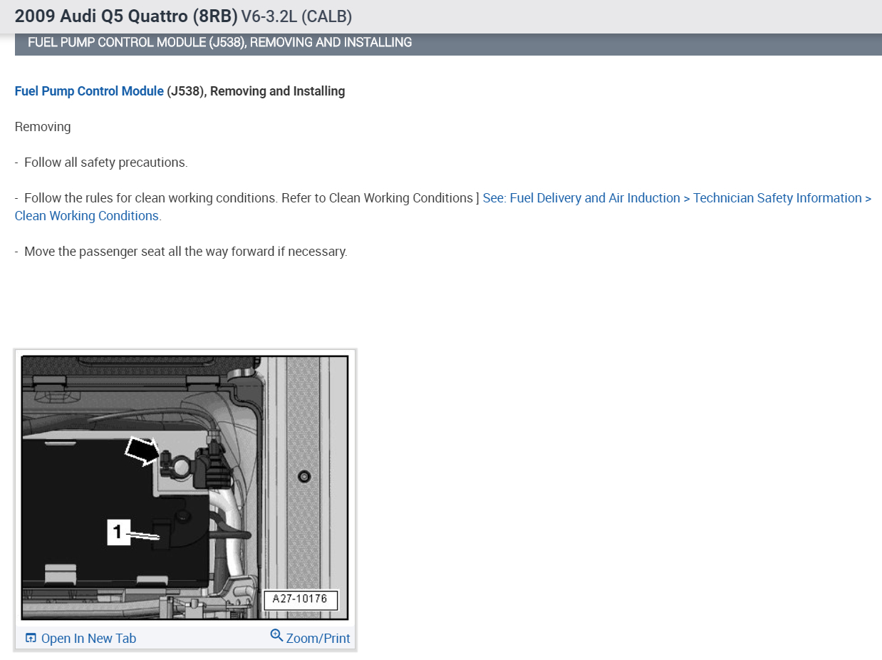

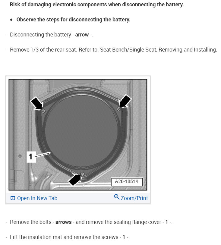

There is no fuel pump relay there is only the motronic control relay which powers the ECM which turns the fuel pump on. This is where the pump gets its power from. The fuel pump control module located inside the tank. Here are instructions on how to replace it. Check out the diagrams (below). Please let us know if you need anything else to get the problem fixed.
