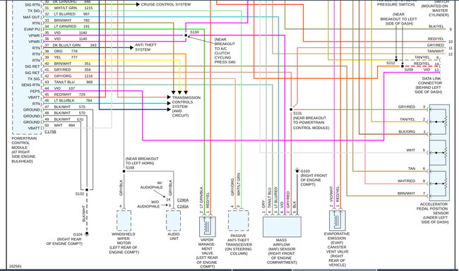

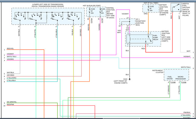

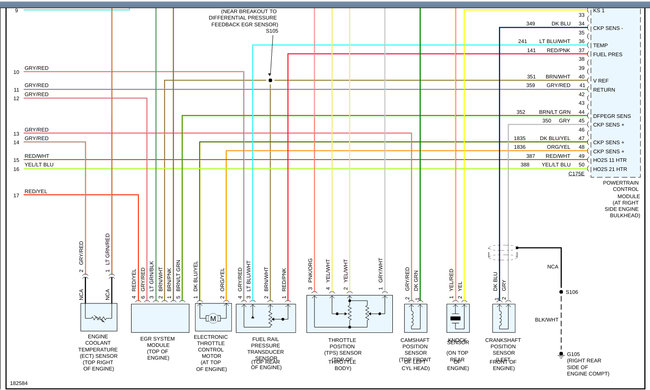

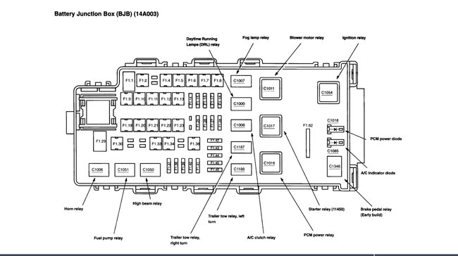

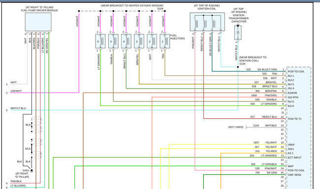

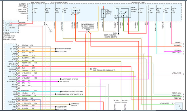

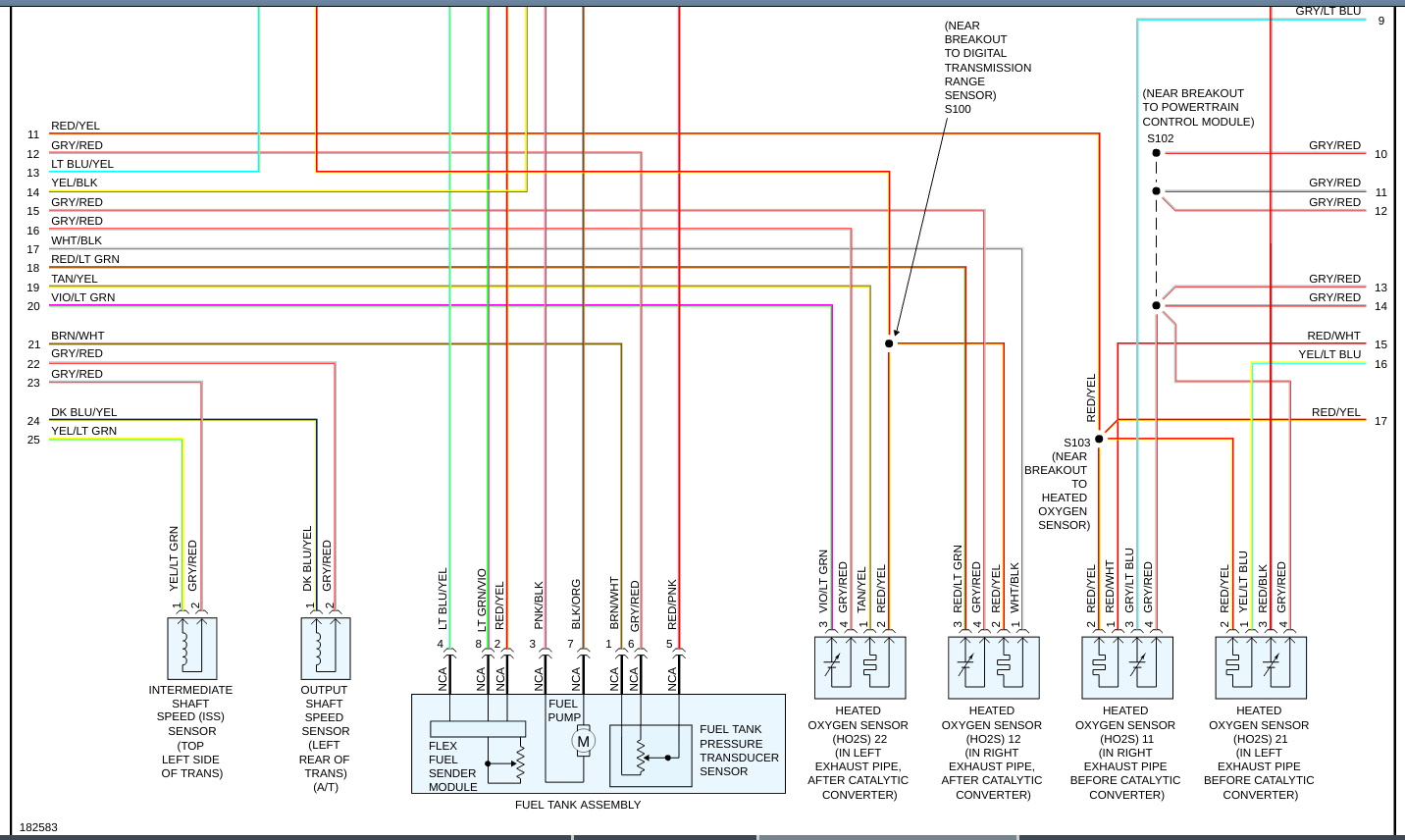

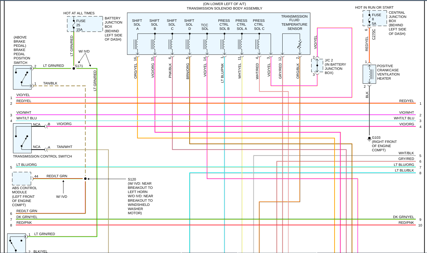

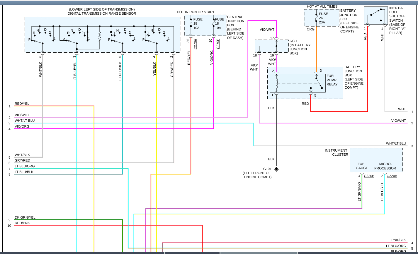

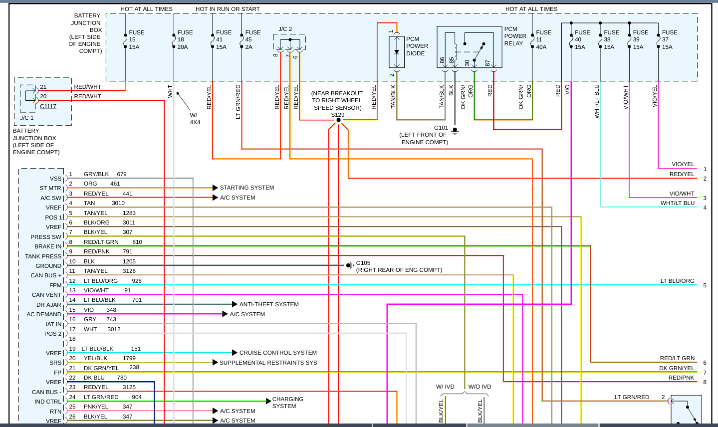

No fuel. want to bypass to test the pump.
Dec 16, 2019 at 1:57 PM
SCGRANTURISMO
  • 4,897 POSTS

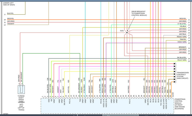

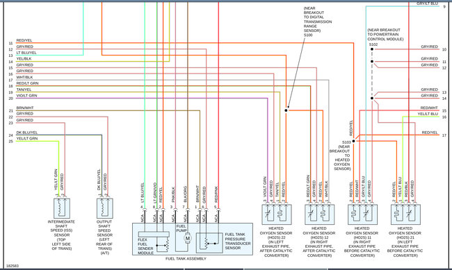

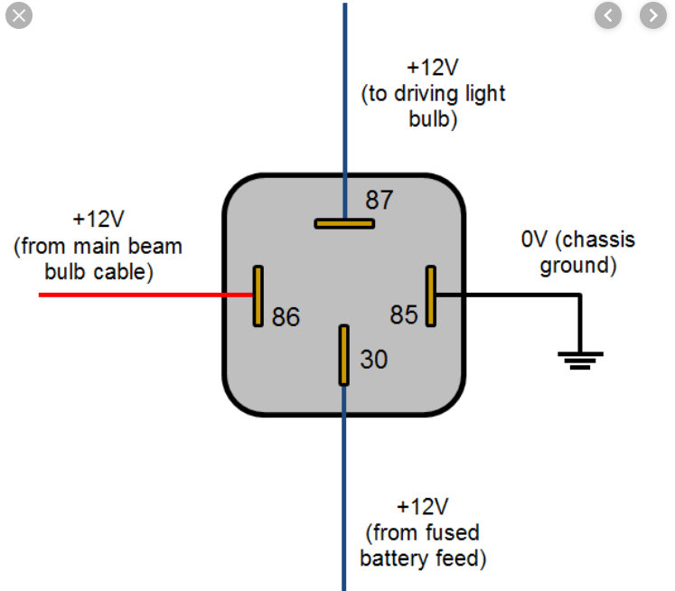

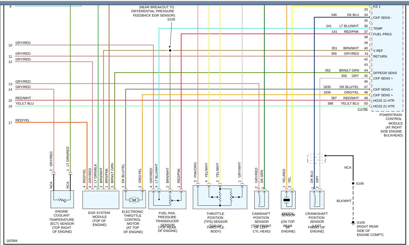

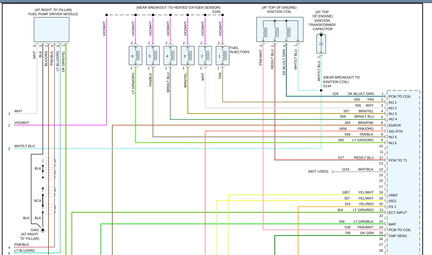

The fuel pump relay is located in battery junction box in your vehicle's engine compartment. In the diagrams down below I have included the layout with relay call out for the battery junction box, and the engine management wiring diagrams for your vehicle. I have also included a typical 4 pin relay diagram for you as well. Please go through these guides and use them to bypass your vehicle fuel pump relay, and get back to us with any questions.
