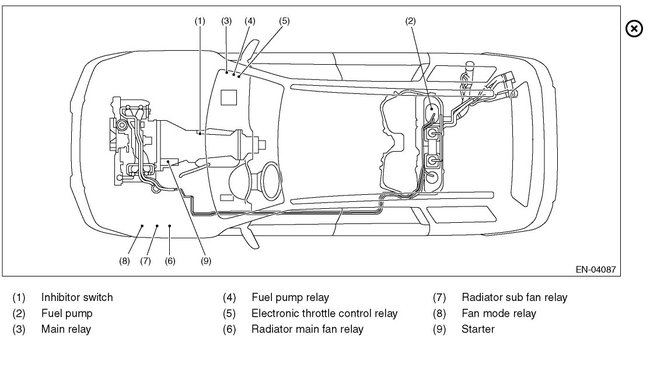

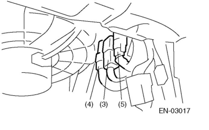

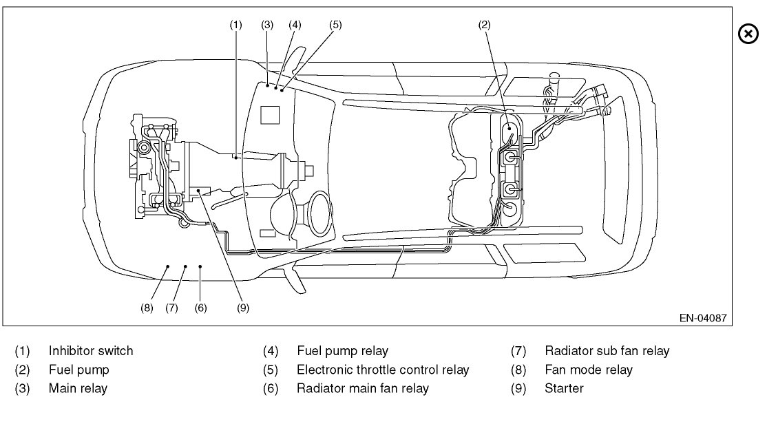

I cannot locate the fuel pump relay switch. Please help me find it.

It looks like it is located under the dash on the passenger's side. Here is a guide and some diagrams (below) so you can get the problem fixed.
