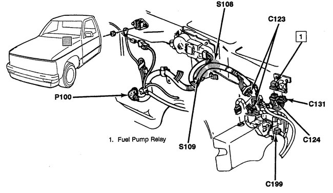

Fuel pump relay location
1992 GMC JIMMY
200,000 MILES
TINA1967
No start, then approximately 24 hours later it started. now it will not start again but when I turn on the key it hums for a minute somewhere around the glove box.

The relay is located under the hood on the firewall. I attached a picture of its location Also, here is a link that shows how to test a relay:
Here are a few links you may find helpful when testing the relay:
