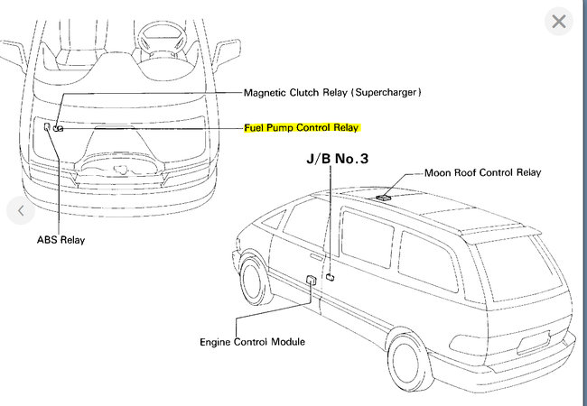

Where is the fuel pump relay located?
1997 TOYOTA PREVIA
138,000 MILES • 4 CYL • 2WD • AUTOMATIC
STINKERTINKER

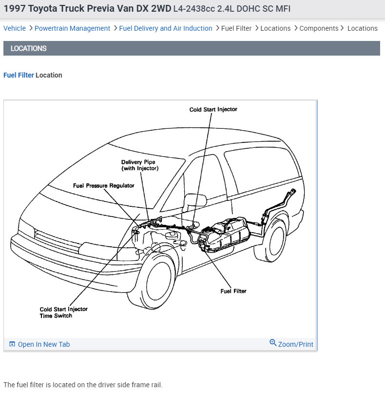

Need to find and remove relay, then to change fuel filter.
May 12, 2022 at 3:11 AM
SQM
  • 6,383 POSTS

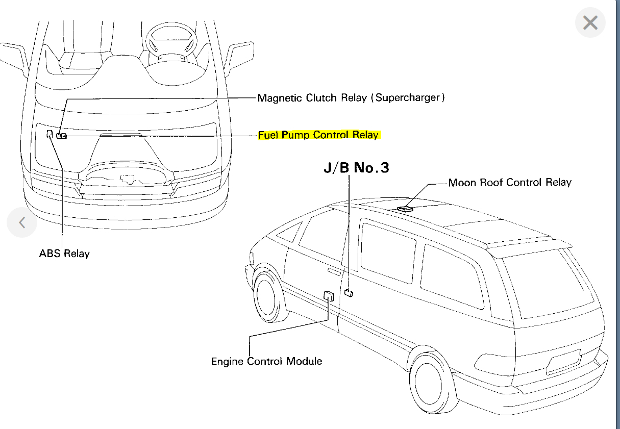

The fuel pump relay is located under the hood on the passenger side (see diagram below).
The fuel filter is on the driver side frame rail.
https://www.2carpros.com/articles/how-to-change-a-fuel-filter
