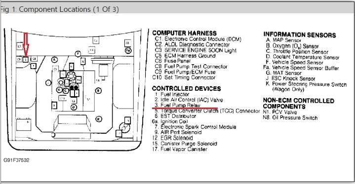

Hello, I have the car listed above Classic model. I just can’t find the fuel pump relay. I’ve looked in the fuse book next to the drivers door and it’s not there. Can someone please help me locate it? Thank you ):

Got this from "Prodemand". Check out the diagrams (Below). Please let us know if you need anything else to get the problem fixed. I hope this helps. The Medic
