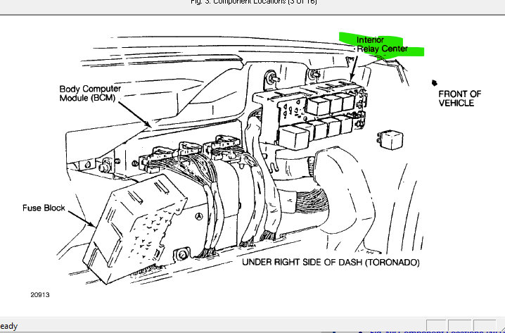

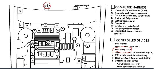

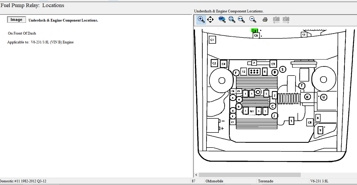

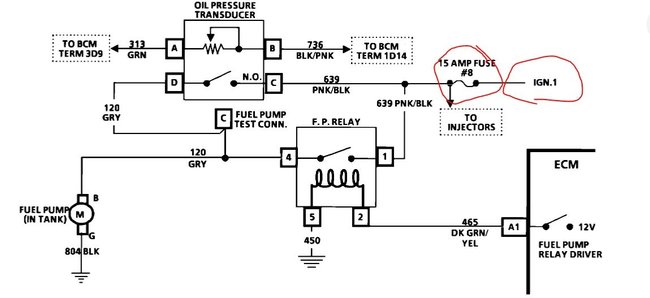

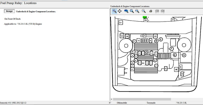

I'm trying to find the location of the fuel pump relay on the car listed above. Will turn over but no fuel getting to injectors and fuel pump not turning on.

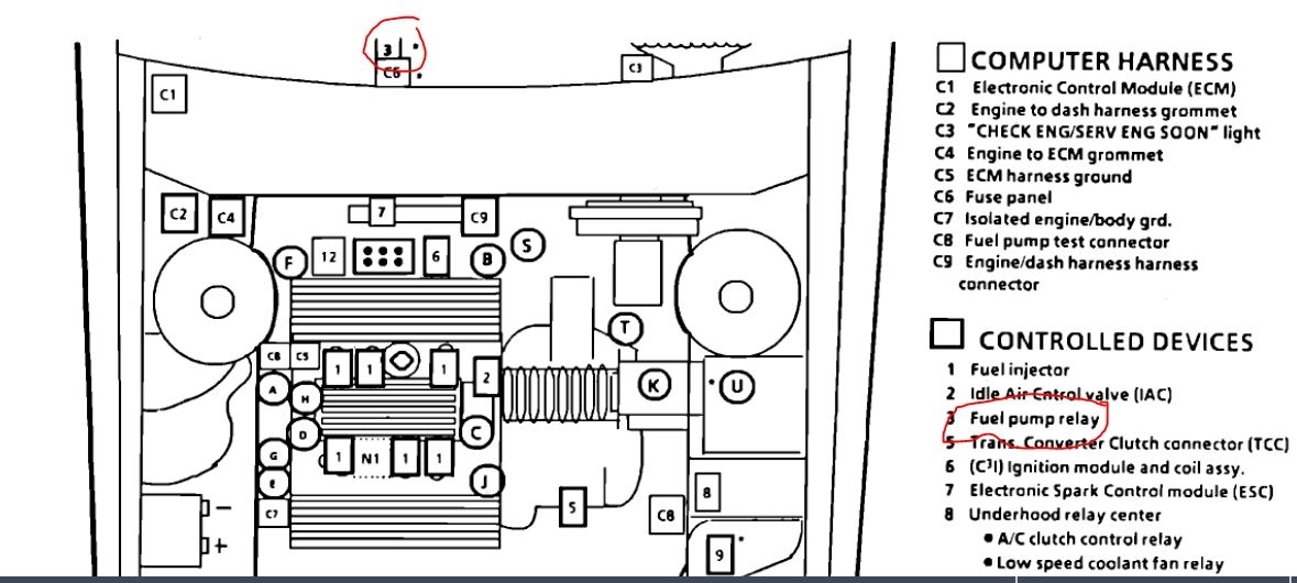

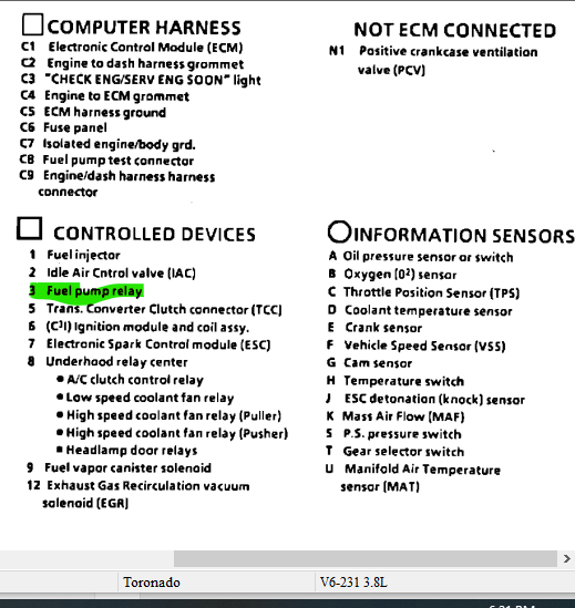

hello,
Check the diagram below location of fuel pump relay.
check our link below how to check a relay:
Let us know if you need more help.

Good morning,
I attached the diagram of the fuel pump for you to view.
The relay is inside the car on the firewall.
On front of dash.
Check the fuse listed for power on both sides.
The gray wire to the back of the car at the fuel pump is what needs to be tested for power when the key is turned on. It will be hot for 2 seconds. Then it will be hot while cranking.
