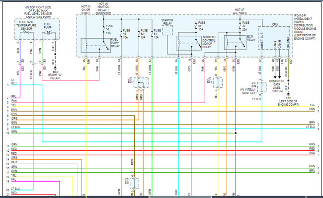

Fuel pump isn’t getting any power to it.
Trying to locate and change fuel pump relay on my car listed above.
Nov 10, 2019 at 5:39 AM
SCGRANTURISMO
  • 4,897 POSTS

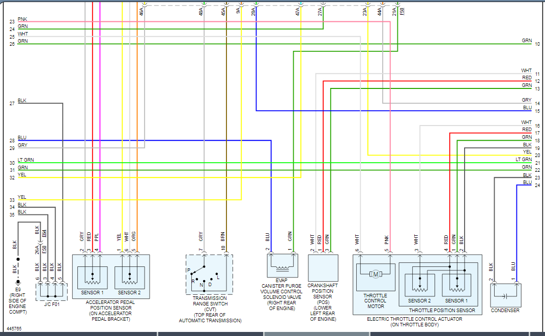

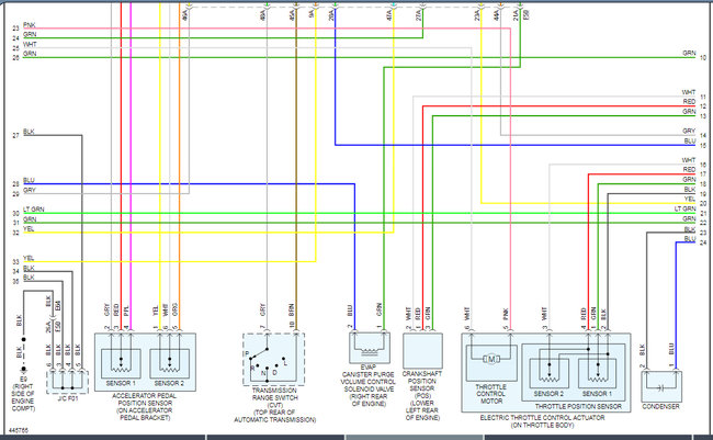

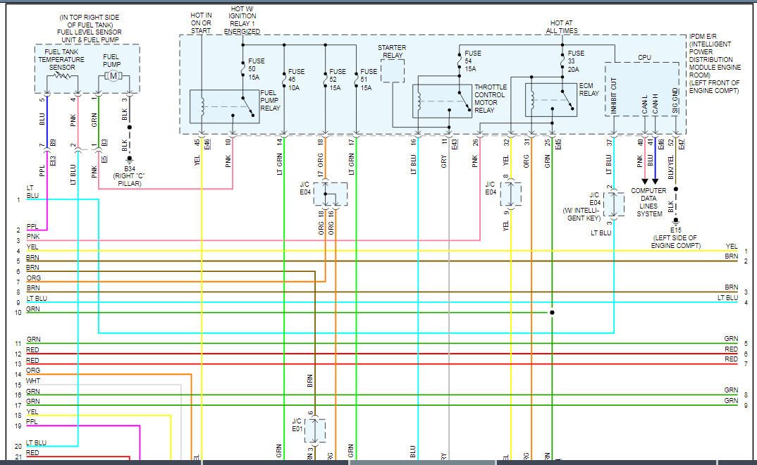

The fuel pump relay is located in your vehicle's Intelligent Power Distribution Module Engine Room[IPDM ER]. In the diagrams down below I have included a wiring diagram of your vehicle's fuel pump and the location of the IPDM. Here is a link below on how to bench test a relay below:
Please go through these diagrams and get back to us with what you find out.
Thanks,
Alex
