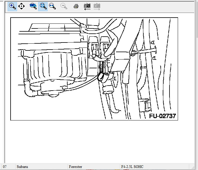

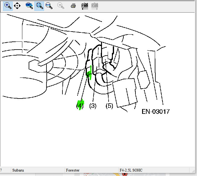

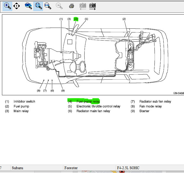

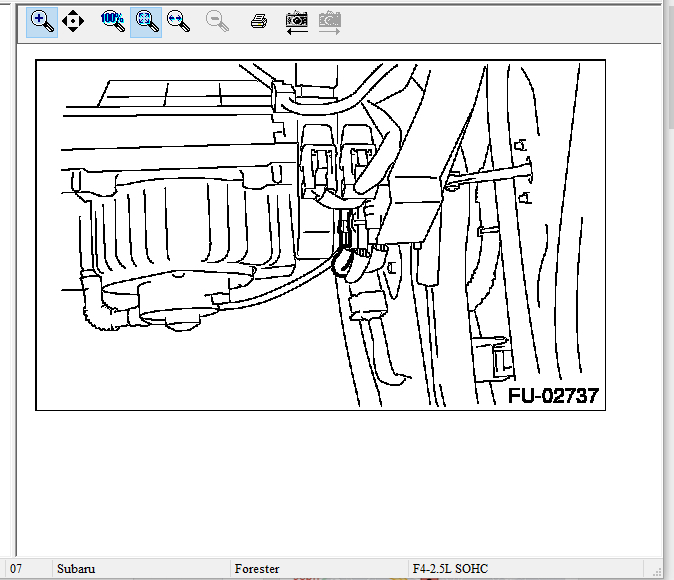

Trying to find the location of the fuel pump relay, found 3 relays under the passenger glove box 2 white and 1 brown but not 100% sure on what one is for the fuel pump.
Jan 25, 2021 at 3:36 PM
SEVAG P
  • 405 POSTS
Hello.

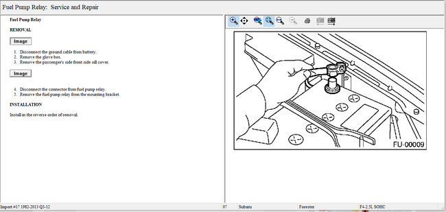

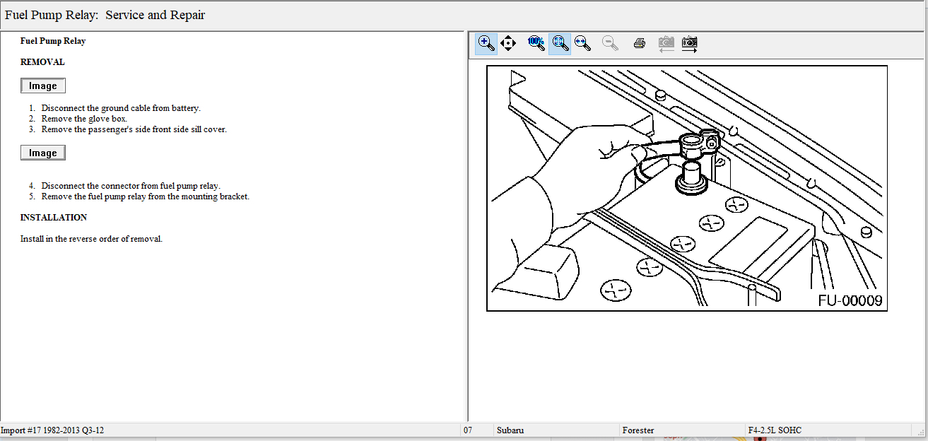

Fuel pump relay located under the dash passenger side, check the pictures below, also procedure how to remove and reinstall relay.
check our guide how to test a relay.
let us know if you need more help.
