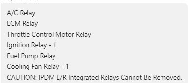

Where is the fuel pump relay in the IPDM box and what does it look like?
May 28, 2024 at 3:15 PM
  • 110,194 POSTS

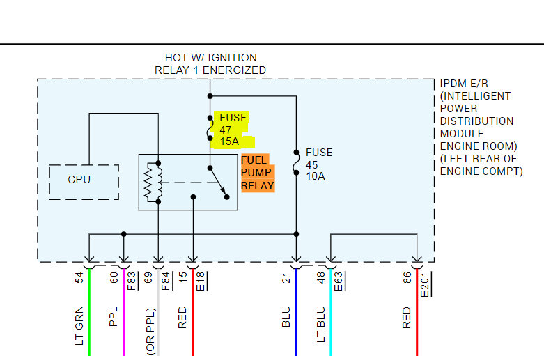

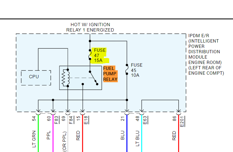

The fuel pump relay isn't serviceable on this vehicle. It is located in the IPDM, but it is part of a printed circuit board and not serviceable.
There is a fuse that powers it and a CPU that triggers the primary side of the relay, but again the CPU isn't serviceable. If the relay fails, the IPDM will need to be replaced.
Let me know what is happening and I may be able to help narrow things down.
See pics below. Pic 2 shows the non-serviceable relays.
