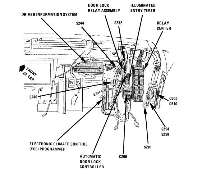

Fuel pump relay location
150,000 MILES • 3.8L • V6 • 2WD • AUTOMATIC
BRYAN BAKER

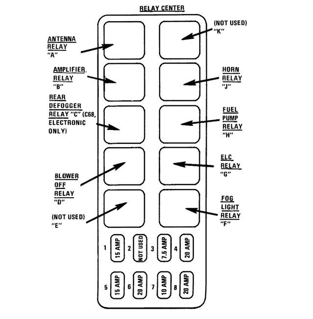

I got a the car listed above Royale front wheel drive. fuel pump quit working so I changed it. you can hear the fuel pump kick on. now I thought it might had a clogged line, so I replaced the fuel filter under the driver's door and blue the lines out with air pressure clean. still no fuel at fuel rail, but you can hear the fuel pump turn on when you turn the key on going. thinking it's the fuel pump relay. where is that located? I can't find it under the hood.
Mar 29, 2019 at 2:05 AM
JOETECHPRO
  • 705 POSTS
Hey Bryan Baker,

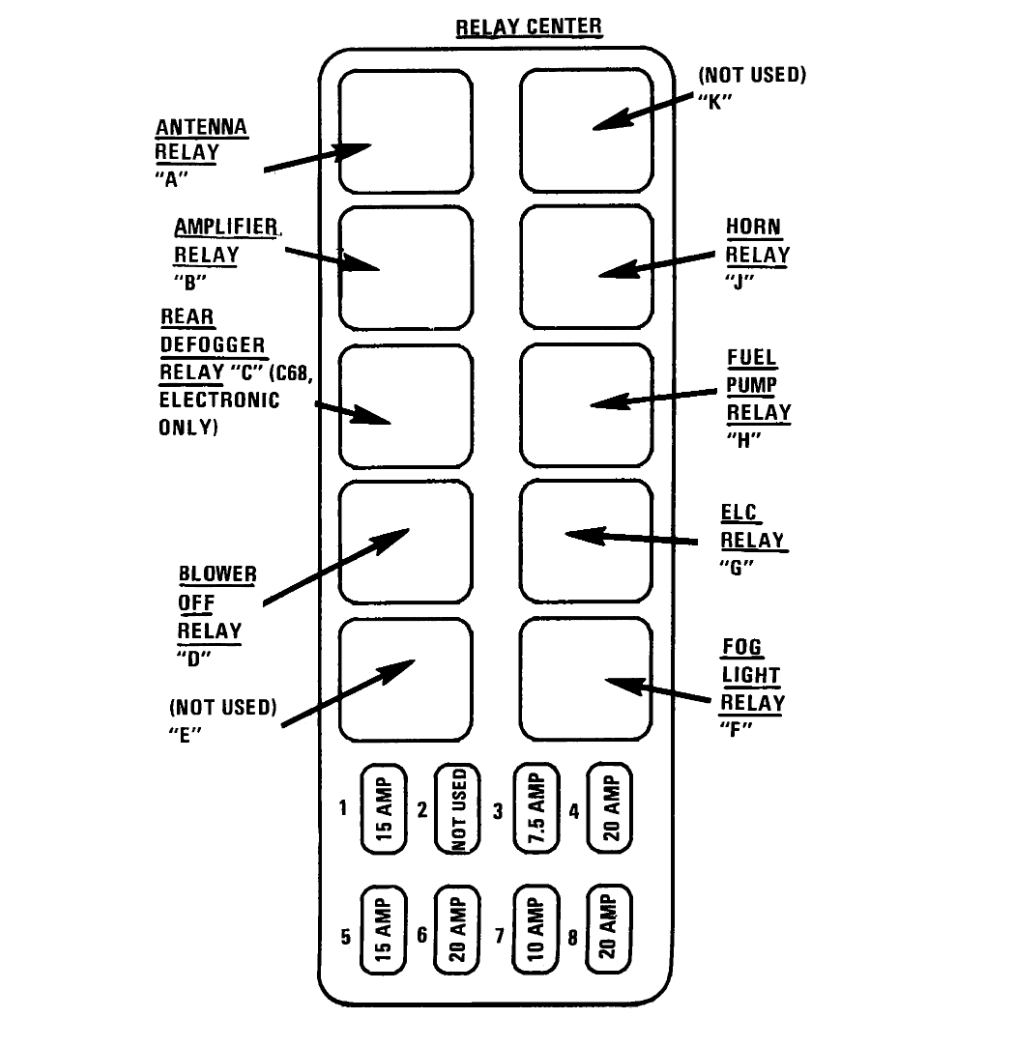

I have attached the location of the fuel pump relay below, although if the pump is running and does't sound weak the relay may not be the issue.
The relay panel is under the right hand side of the dash.
If you want to replace it let us know if you get any change.
Did you listen with the old pump to see if it was running or did you replace it before?
Regards, Joe
