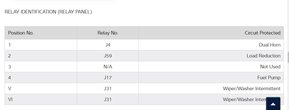

Turns over but wont start.
Apr 19, 2019 at 8:42 AM
SCGRANTURISMO
  • 4,897 POSTS

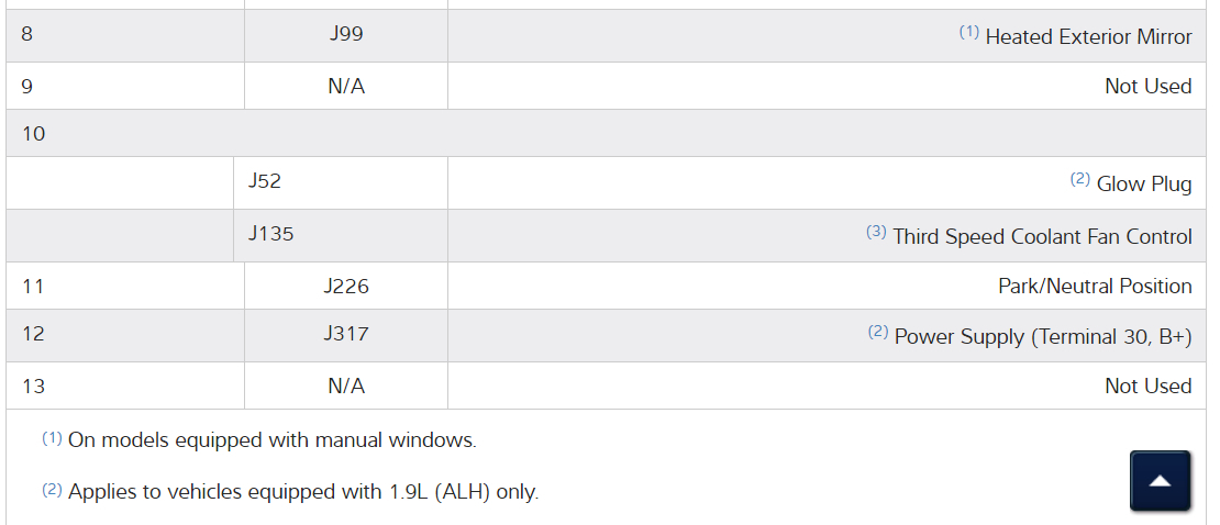

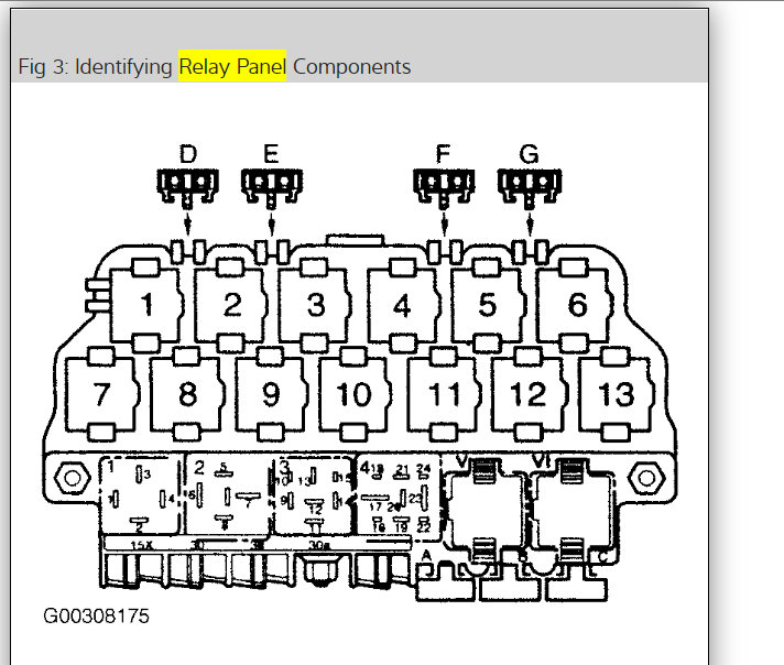

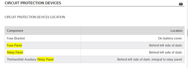

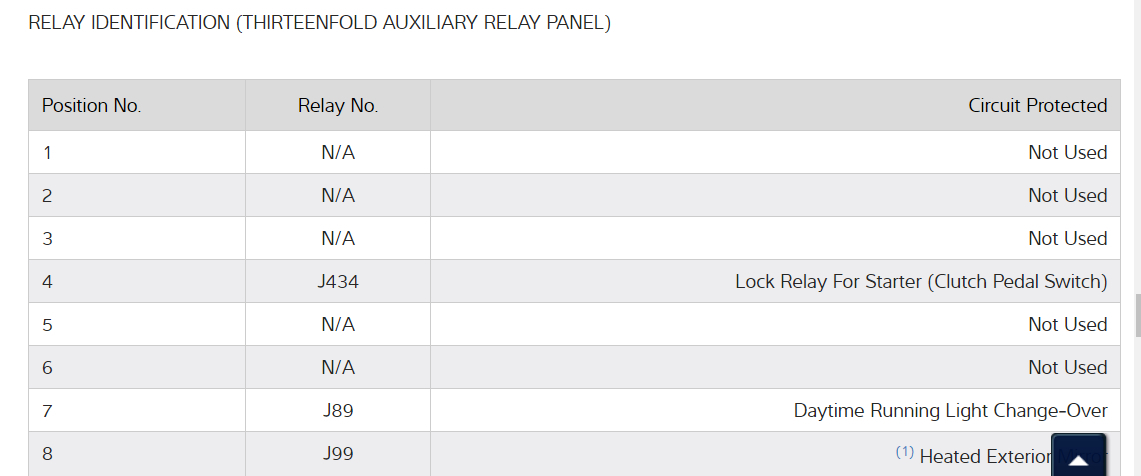

I have included the information that you requested in the diagrams down below. When you turn the key on do you here the fuel pump come on for a few seconds? Please get back to us. It should e no problem in getting your vehicle running. I have also included a link for you to go to down below, please.
Please go through the information I have included in the diagrams down below and the guide that was provided above and get back to us with what you are able to find out please.
Thanks,
Alex
