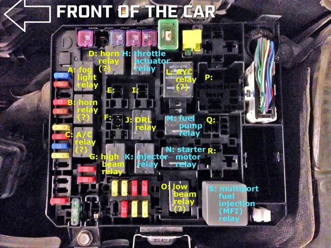

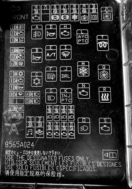

Hello guys, I would like to know the icon and the corresponding location of the fuel pump relay on my car listed above GTS CVT, California Emission, please?
Thanks in advance and my best regards.

Attached are the engine fuse box cover and its contents for your reference...
Nov 10, 2024 at 8:40 PM

Engine bay fuse box contents...
Nov 10, 2024 at 8:43 PM

I'm sorry but none of those are the fuel pump relay. In your vehicle the relay is a part of the ETACs module and not replaceable as an individual component. The pump doesn't have an individual fuse either as the power is fed through the ETACs from the same fuses that power it. Could I ask why you are looking for the relay?

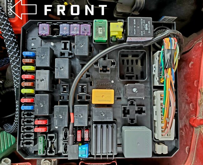

I'm looking for it because there is an upgraded fuel pump relay discussed in one of the Lancer's forum.
So, it's not available for base Lancers, I guess. I'll attached an image of what they are talking about, but it is from a Ralliart Lancer fuse box...

Service info shows it as part of the ETACS on the 08. However, I have seen service info be wrong before and parts shown as "non-serviceable" turned out to be something that could be replaced. Easy way to find out. Have someone just turn the key on while you hold a finger on the yellow relay, service info shows that as powering the injectors, but it could be wrong.
