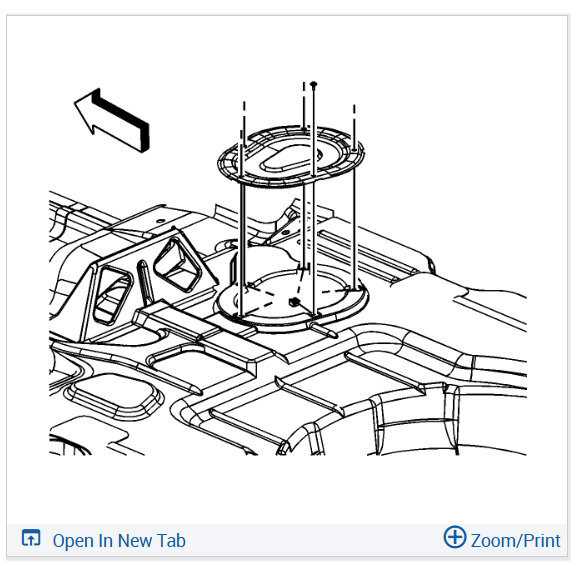

Fuel pump relay getting really hot and burning the fuse box not the seat causing the problem like other people have the seat is off with a new fuse box and fuel pump still gets hot not really sure what else it could be.

I checked out the wiring diagrams and it looks like the system is pretty basic, one relay, one fuel pump, I would look at the G403 ground which is at the right front wall of the luggage department and if that looks okay it would replace the fuel pump, also, you may need to clean and enhance the connections at the fuse panel where the fuel pump relay resides. Luckily there is a trap door in the trunk so you can get to the pump without removing the gas tank. Replace the relay as well. Check out the images (below). Please let us know what happens.

I changed the fuel pump and checked the ground looks good and cleaned the connections and still have the same issue.
