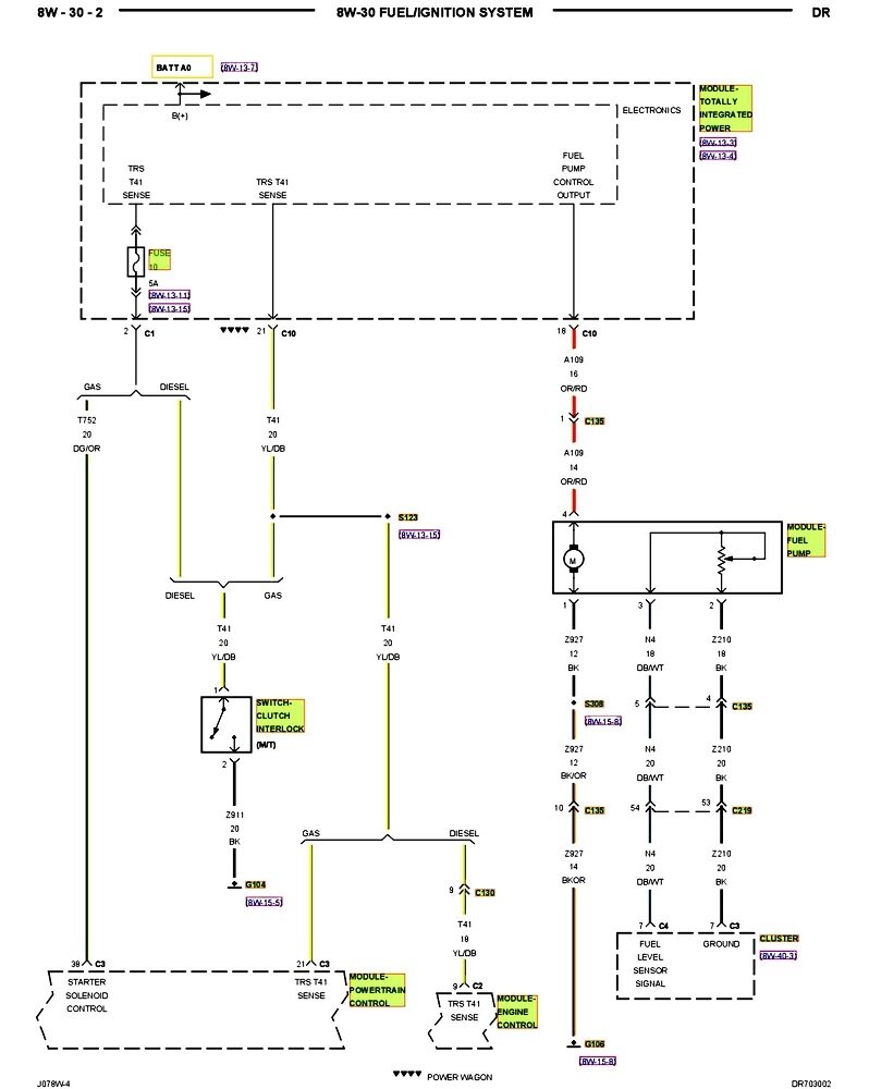

I'm trying to bypass the fuel pump relay except fuse 7 and 25 aren't the same as they are in video, I watched, and I can't locate the fuse for the pump so which number fuse do I jump to the 12v power outlet.

The diagrams provided leave a lot to be desired. I'm trying to find better ones.
What kind of problem are you trying to solve? If you have a crank / no-start, have you checked for spark? Have you had the diagnostic fault codes read and recorded? If you have, what codes came up? You can go here:
https://www.2carpros.com/trouble_codes/obd2/p0500
to see the definitions, or I can interpret them for you.
