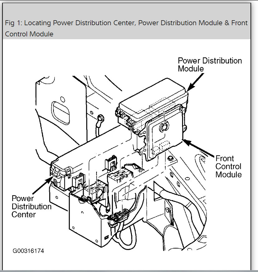

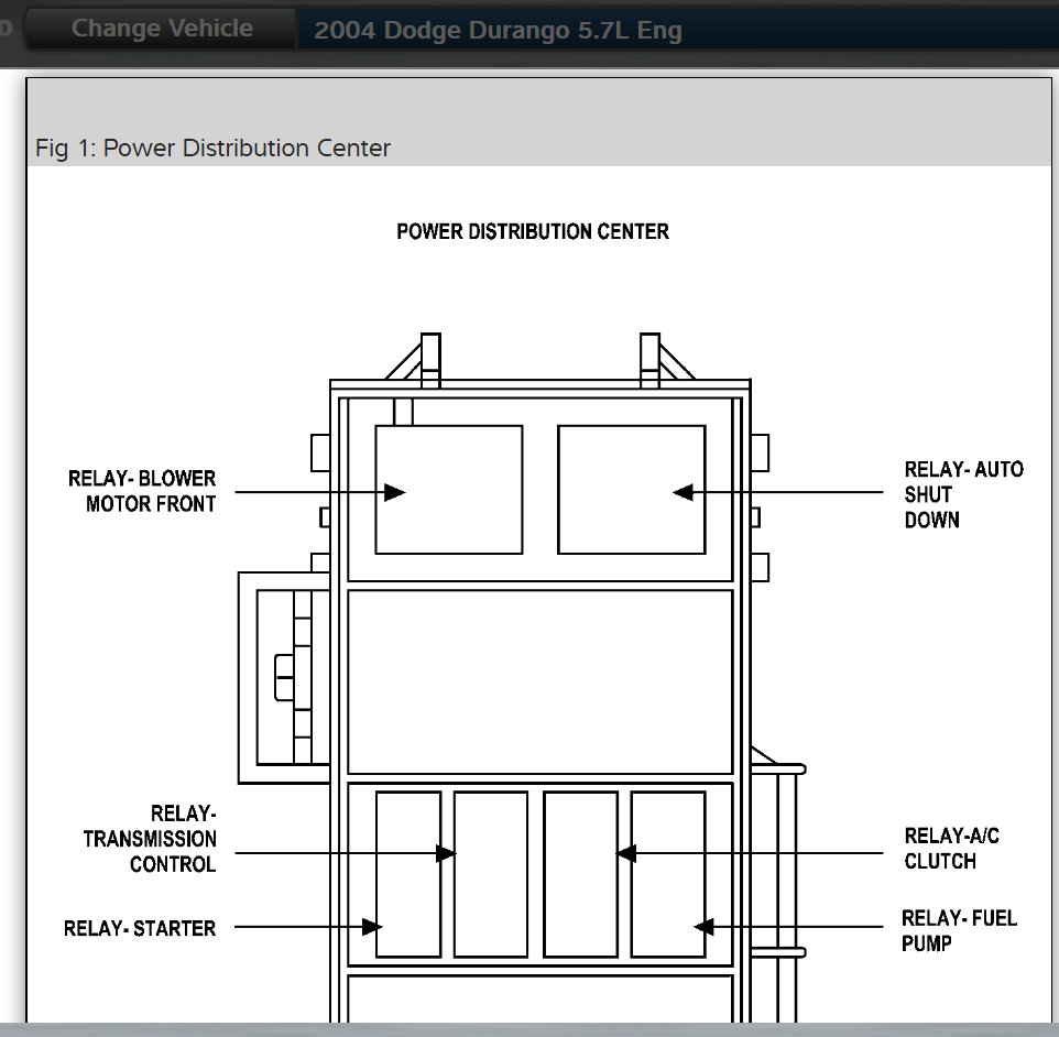

Where is the fuel pump relay located?
Mar 15, 2019 at 8:03 AM
SCGRANTURISMO
  • 4,897 POSTS

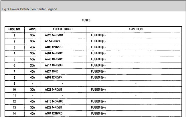

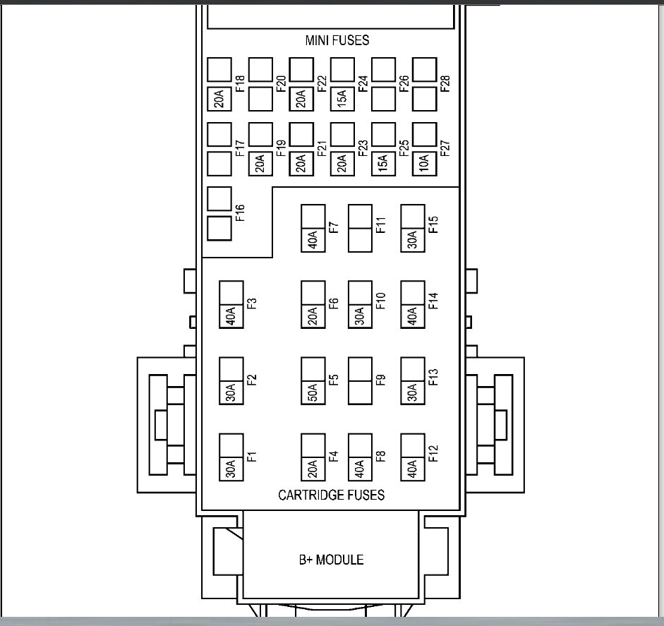

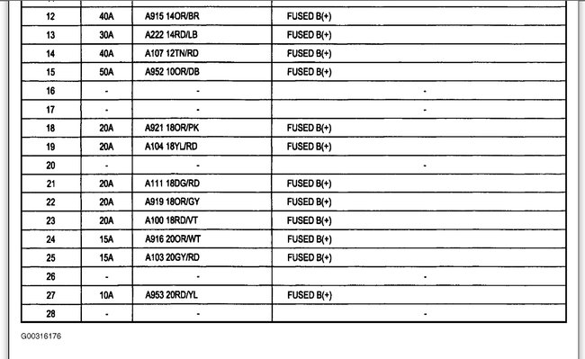

It is located in the right side of the engine compartment in the Power Distribution Center. I have sent exploded diagrams and fuse and relay information for you in the diagrams below. Please go through them and get back to us with any other questions that you may have.
