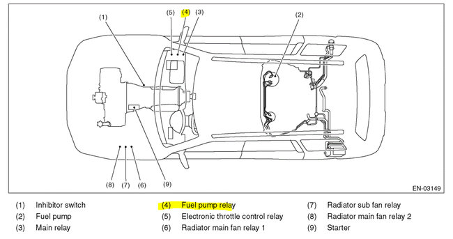

Hi, can you help me find my fuel pump relay?
Feb 11, 2021 at 11:55 AM
  • 110,248 POSTS
It on the passenger side under the dash. See pic 4.

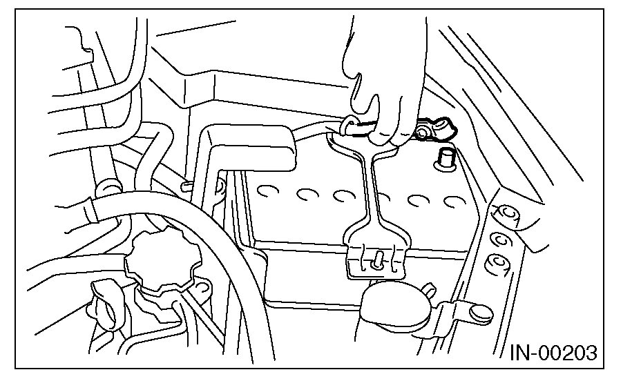

Here are the directions for replacing it. The attached pics correlate with the directions.
_____________________________________
2007 Subaru Outback F4-2.5L SOHC
2.5L SOHC
Vehicle Powertrain Management Fuel Delivery and Air Induction Fuel Pump Fuel Pump Relay Service and Repair Removal and Replacement 2.5L SOHC
2.5L SOHC
Fuel Pump Relay
REMOVAL
pic 1
1. Disconnect the ground cable from the battery.

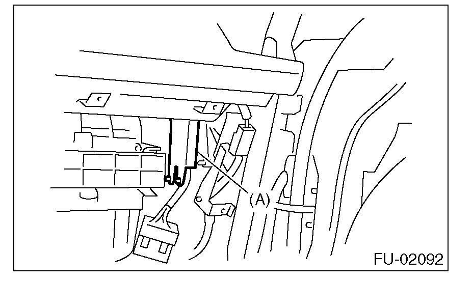

2. Remove the glove box.
pic 2
3. Remove the harness cover (A).

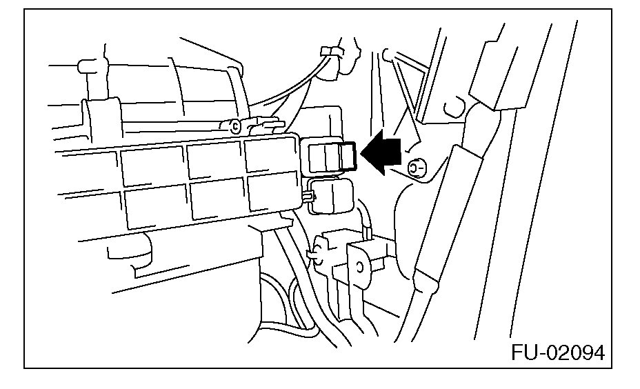

pic 3
4. Disconnect the connector from fuel pump relay.
