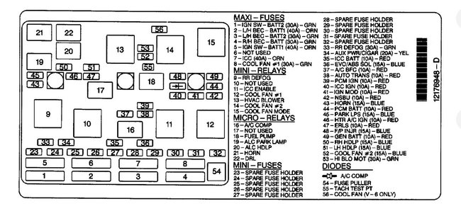

Hi, where is the fuel pump relay located? Also how else can I not make my car start (do not want someone to drive it)?

Not exactly sure where it is on that car but Chevrolet puts the relays in the same box as the under-hood fuse box. If you open that up with see it on the left side of the engine compartment. You will need to find a diagram of which relay is which. Hopefully they are labeled! If you pull the pump relay out, the car will not start.

There is a fuse box under the hood. Remove the cover and there are fuses. I attached a diagram of the fuse block for you. Remove fuse number 39 in the fuse box. You will need a pair of pliers to remove it.
That will disable the car. After you remove it, try to start it and verify it will not start.

Did not work. Fuse box is not the same.

Really? Can you upload a picture of what you see under the hood for the fuse box?
