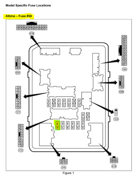

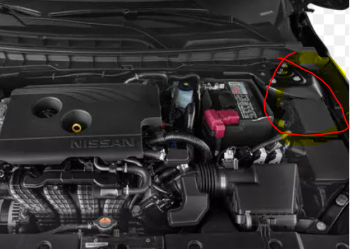

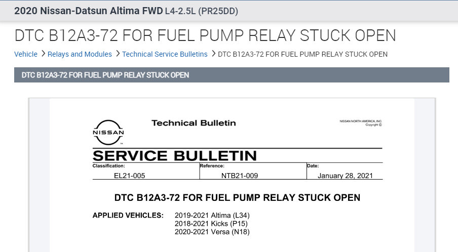

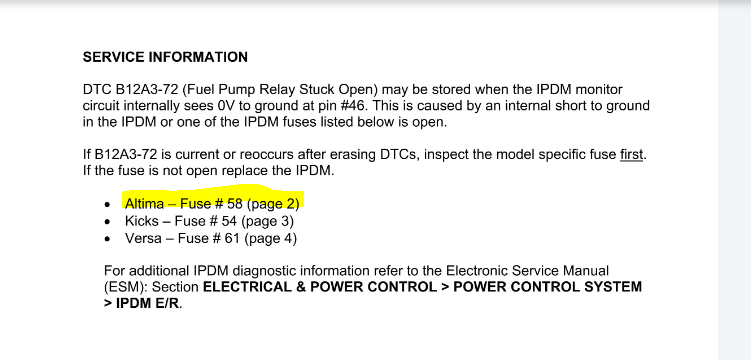

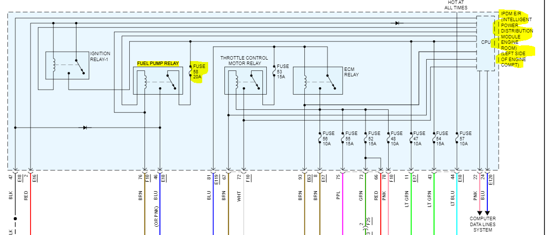

First, take a look at the first couple of pics I attached. That is a technical service bulletin related to the fuel pump relay. The fuel pump relay is an integral component in the intelligent power distribution module (IPDM).

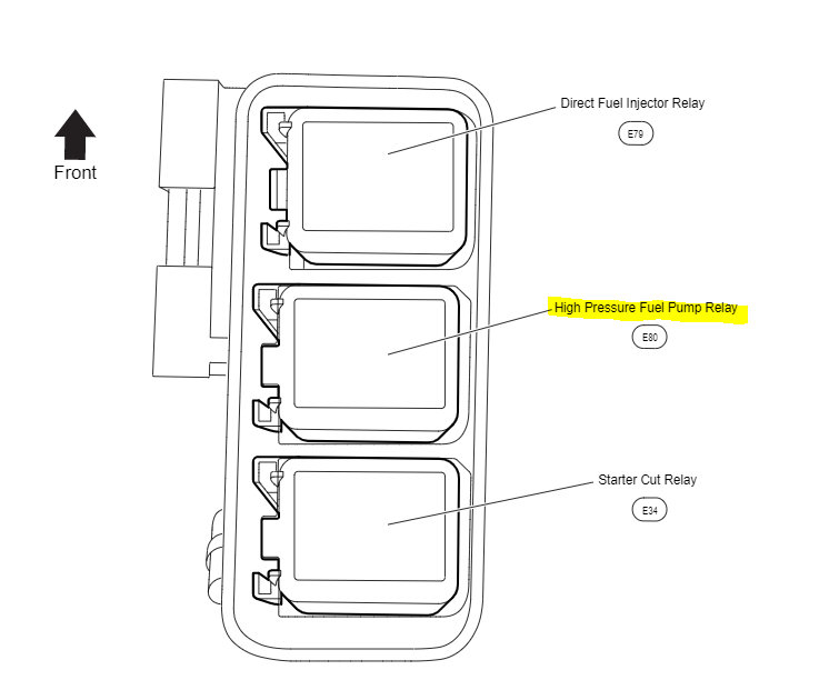

There is a high-pressure fuel pump relay located in relay box 1. See pics 5 and 6.
Let me know if that helps.
