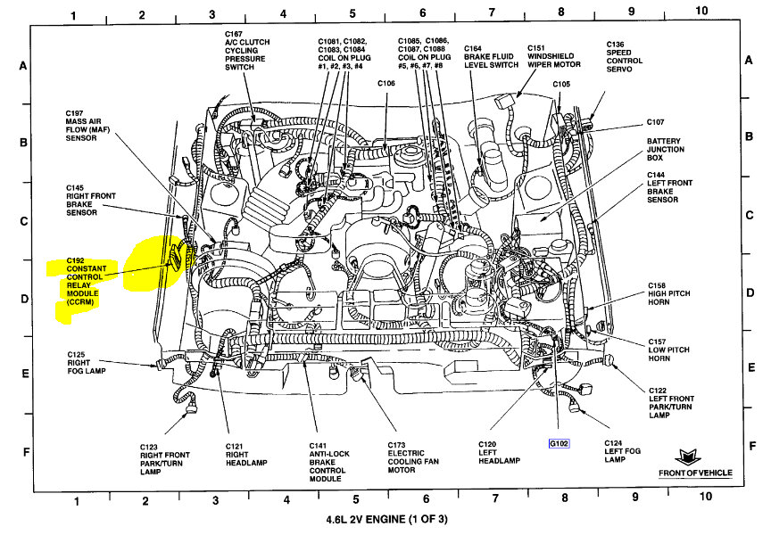

Where is the fuel pump relay located on the car listed above GT model?

I have some good and bad news. First, I can provide information on the fuel pump relay.
The bad news is the fuel pump relay is not serviceable.
The Constant Control Relay Module (CCRM) contains the fuel pump relay, which supplies power to the fuel pump driver module (FPDM). If any of the internal components of the CCRM fail, the entire unit must be replaced.
If you look below, I highlighted the CCRM in the picture below.
Let me know if this helps.
joe
See pic below.
