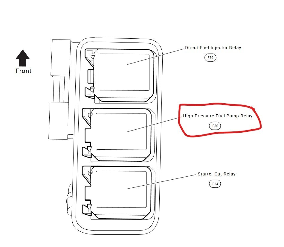

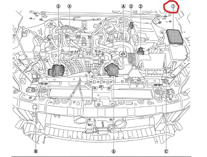

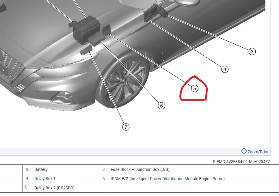

I want to know where is the location of the fuel pump relay.
Jan 25, 2025 at 5:07 AM
STEVE W.
  • 15,418 POSTS
There are two pump relays in the car. One powers the in tank pump and the other powers the high-pressure pump. The low-pressure pump relay is inside the intelligent fuse box mounted under the hood on the left fender liner. It isn't replaceable, instead you replace the complete module. The high-pressure pump relay is in relay box 1 that one is replaceable. What is the issue you are having?
